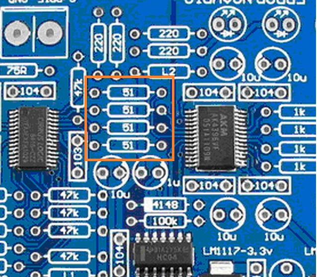

I'm looking at adding an external I2S board to the DAC.
The idea is to make a small pcb, connected between R12, R13, R14 and R15 pads.
The small piggy back pcb would hold the above resistors, one socket for plugging the external board and two relays for switching between the external and internal I2S options.

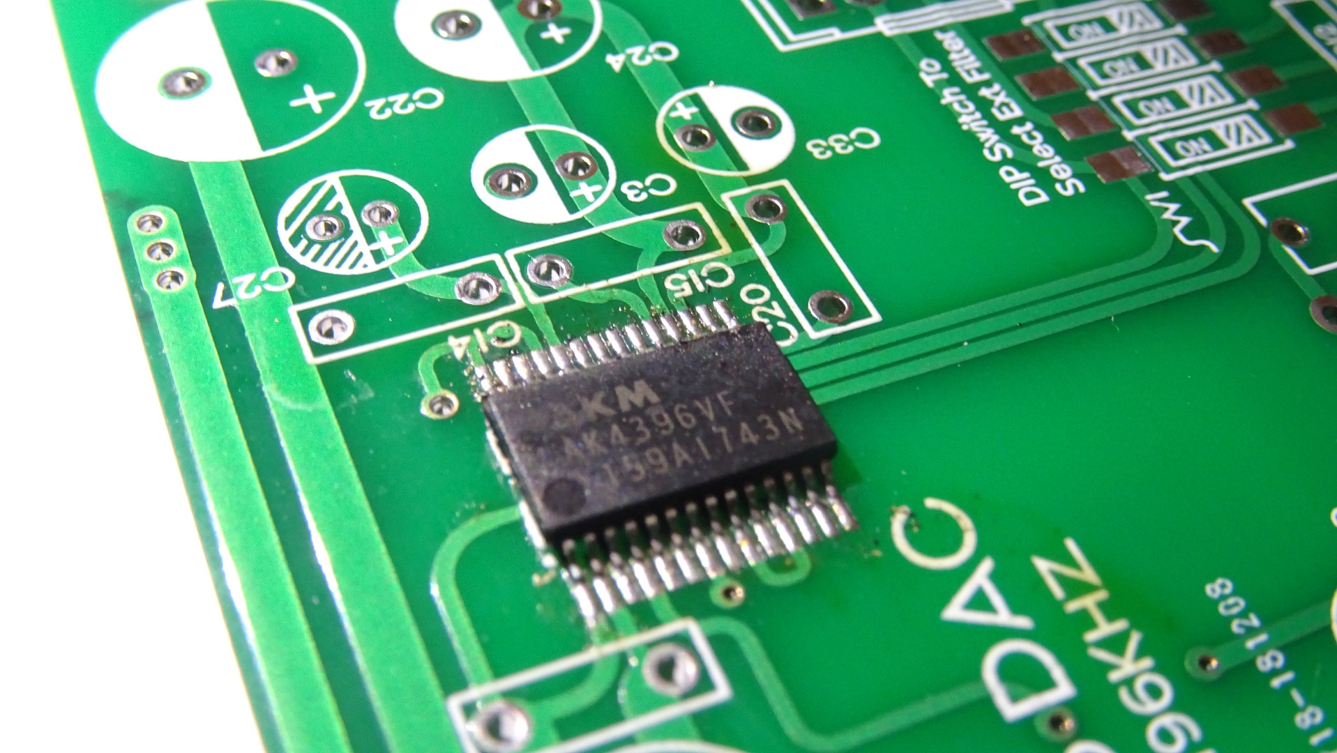

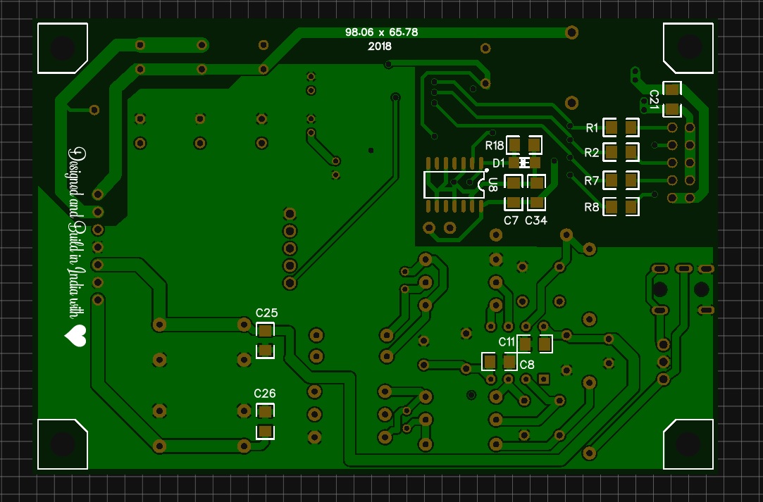

AK4396 24/196 DAC in Parallel Mode
Hey guys, from couple of days i am working on a pcb for AK4396vf DAC Chip. it accepts external i2s, no on-board reviver for output stage stock single opamp with external header to bypass onboard opamp and for source CMedia CM6631A for DIYINHK usb receiver.
After building i am planning for discreet staging..!
Any Suggestions..! 🙂🙂🙂🙂

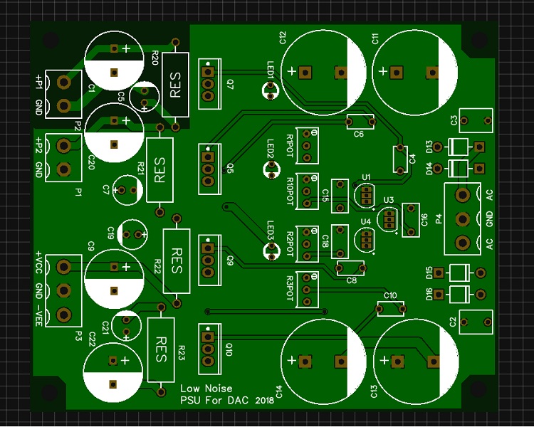

Low Noise linear PSU for DAC with LM329DZ Voltage Reference and LM4562MAX op-amp driving IRF640 Mosfet

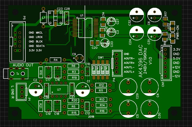

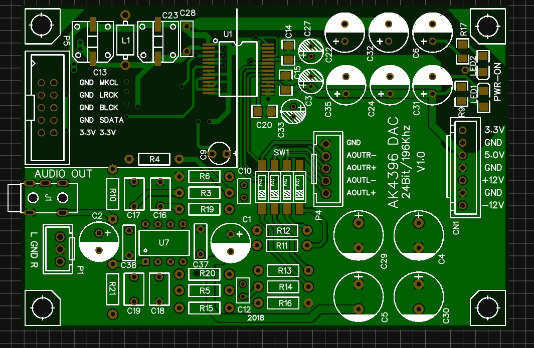

Here are some PCB updates.
Coupling cap c28 for digital is Panasonic OsCon 470uf 6.3v.
Digital rail caps c22,c32,c6 rail are Panasonic os-con 560uF x3 6.3v.
Coupling cap c33,c15 are 47uf and c27 is 10uf default this three are from nichicon.
As for dac analog rail caps c24,c31,c35 rail are Panasonic 560uF 6.3v.
For opamp coupling Panasonic 470uf and for opamp rail Panasonic 1000uf
Any suggestions...!

Any schematics? What regulators will you be using?
I am planning on adding a JL USB > I2S board to my still un-assembled AK4396 pcb.
For that I will have to design a small pcb, perhaps on a perforated proto-board, with the I2S connector to plug on the DAC and the I2S connector for the JL Sounds usb > I2S board, which is slightly cheaper than the DIYHink.
I2SoverUSB - I2S over USB Audio
As I said above, I plan to use a reed relay switch to select the internal or external input.

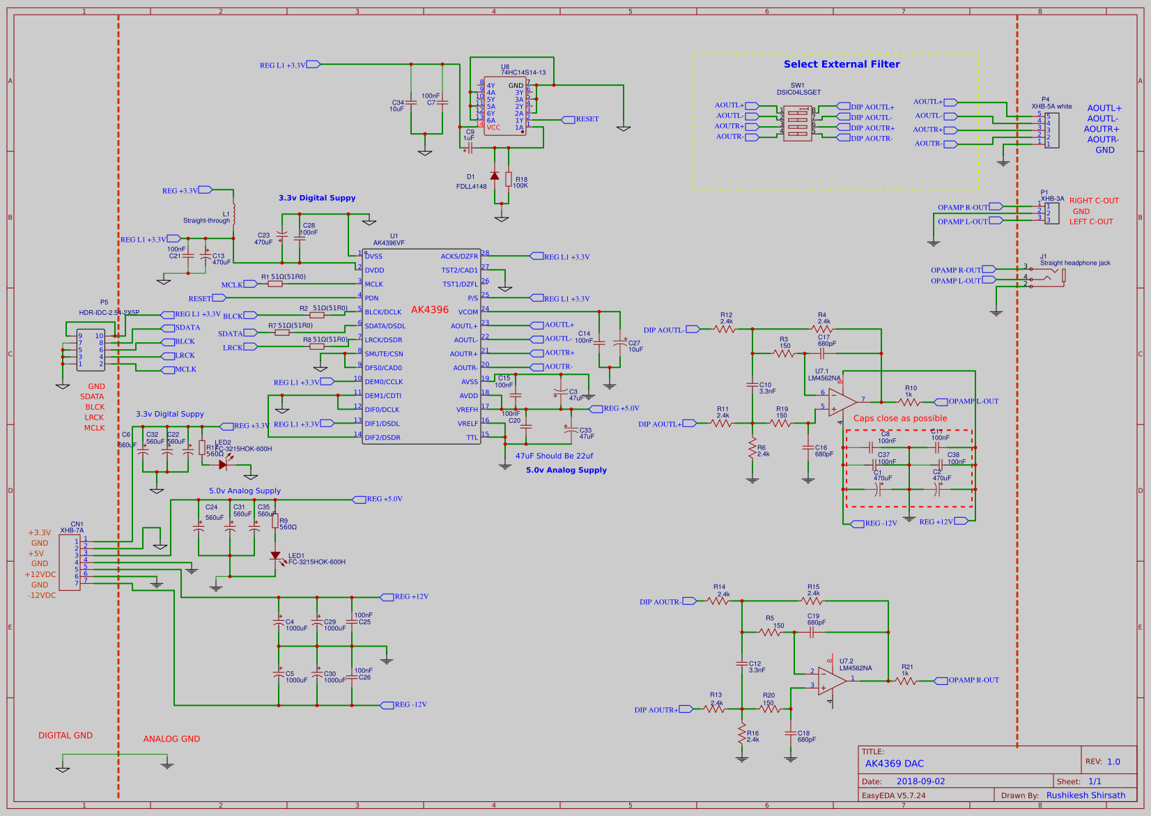

Here is the schematic
I am using a LM329DZ Voltage reference with LM4562MAX Opamp to drive a Mosfet for linear regulation
there are three for one for 3.3, one for 5v and one for both+-12
Something resembling a Sulzer or Jung regulator?

yes smiler to it...!

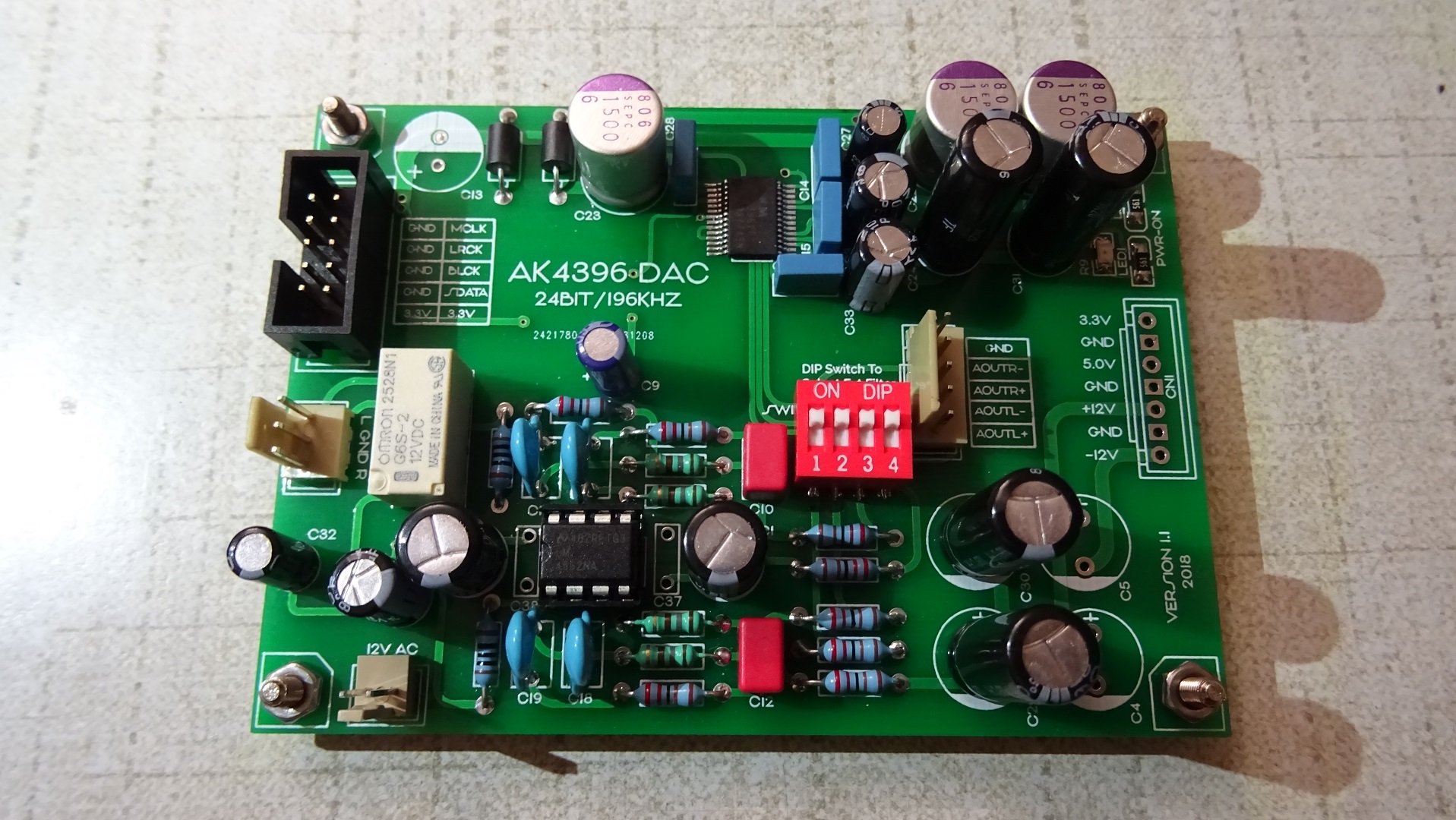

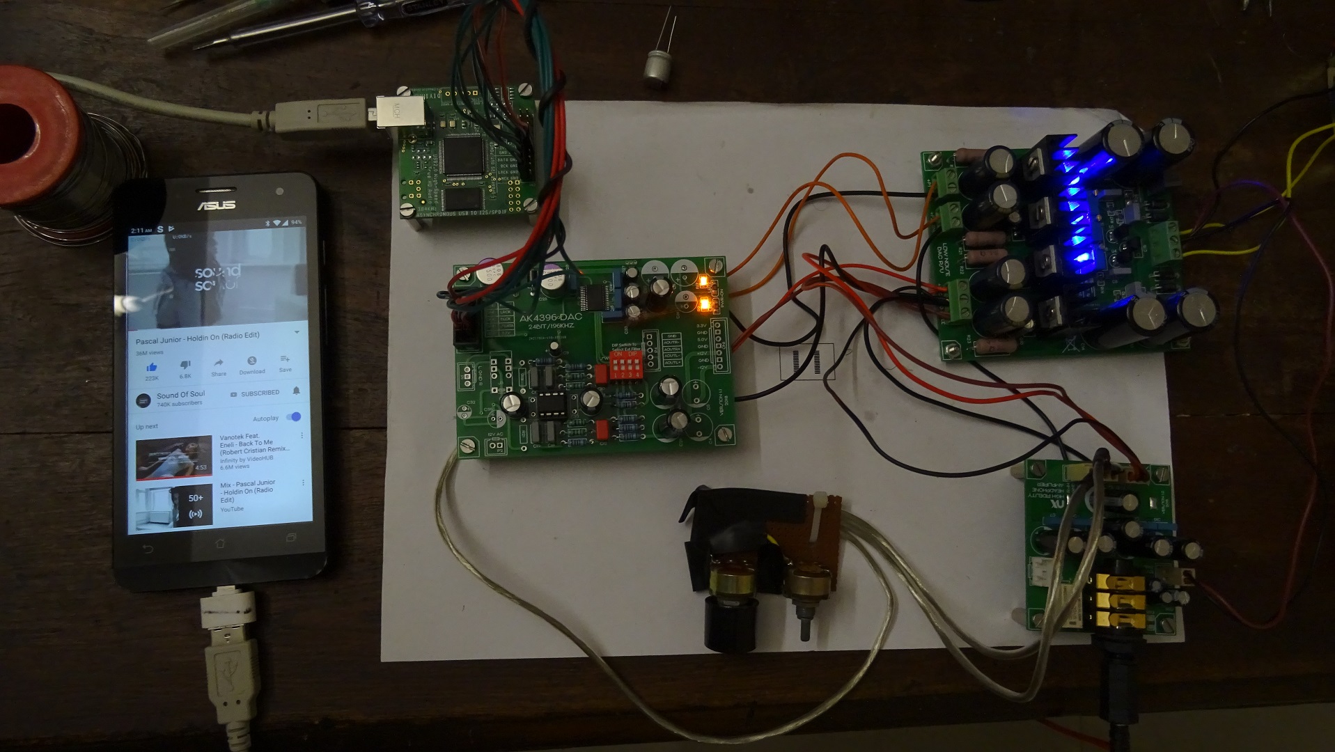

Hey everyone i am posting my current progress on this DAC board from testing and after listening it for a while, i have to say there is no for any equalizer at all. lows, mid-bass, mid, highs all are there perfectly. I loved this chips frequency response to every track genre perfectly well balanced.
For the op-amp i used LM4562NA op-amp but soon going to switch to discreet staging...!
Any suggestions....!

Which DAC board is that? I thought we were talking about blue-pcb AKM4396 eBay project. This one is completely different.
What USB interface is that? What regulators are those?
