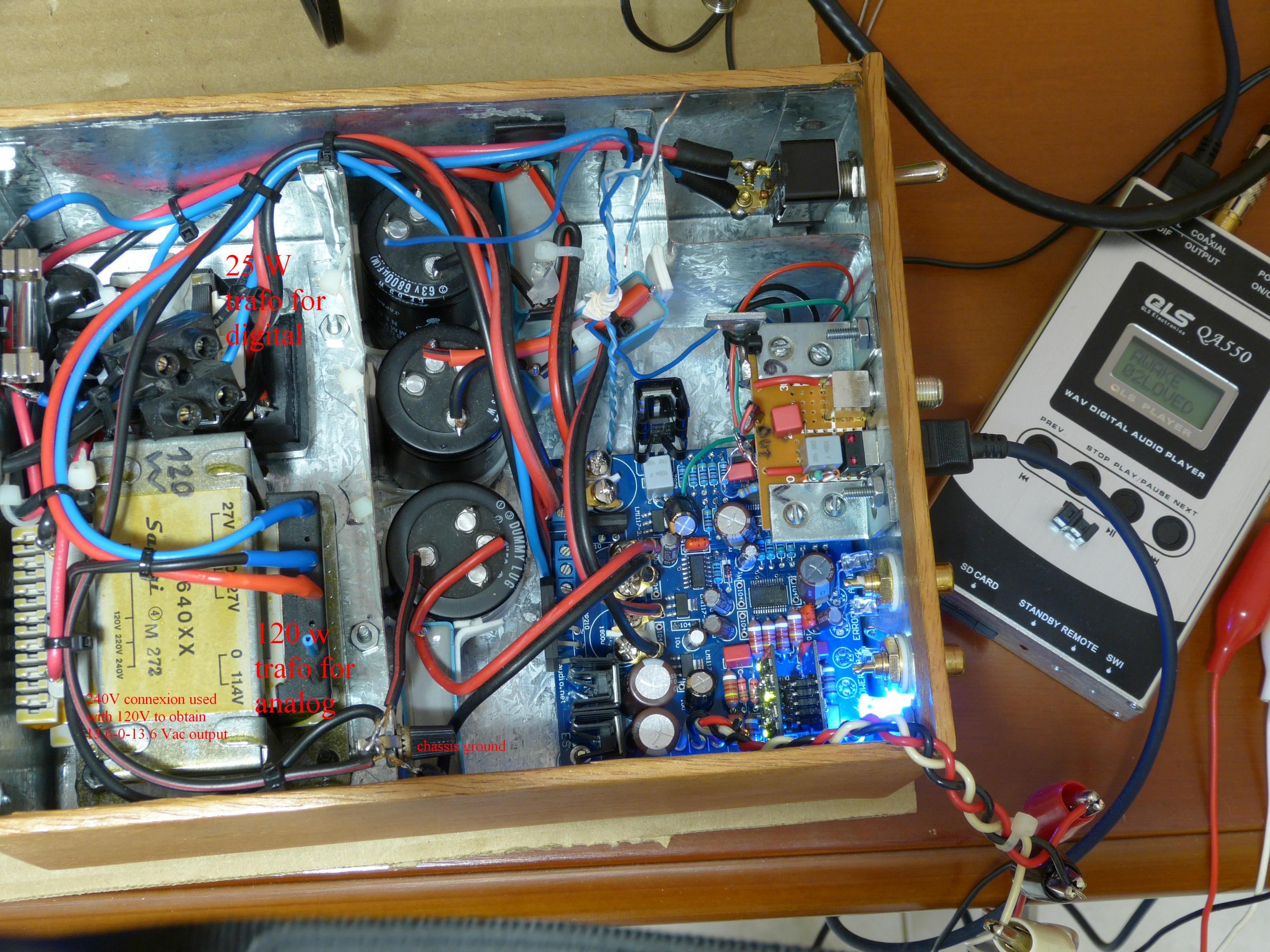

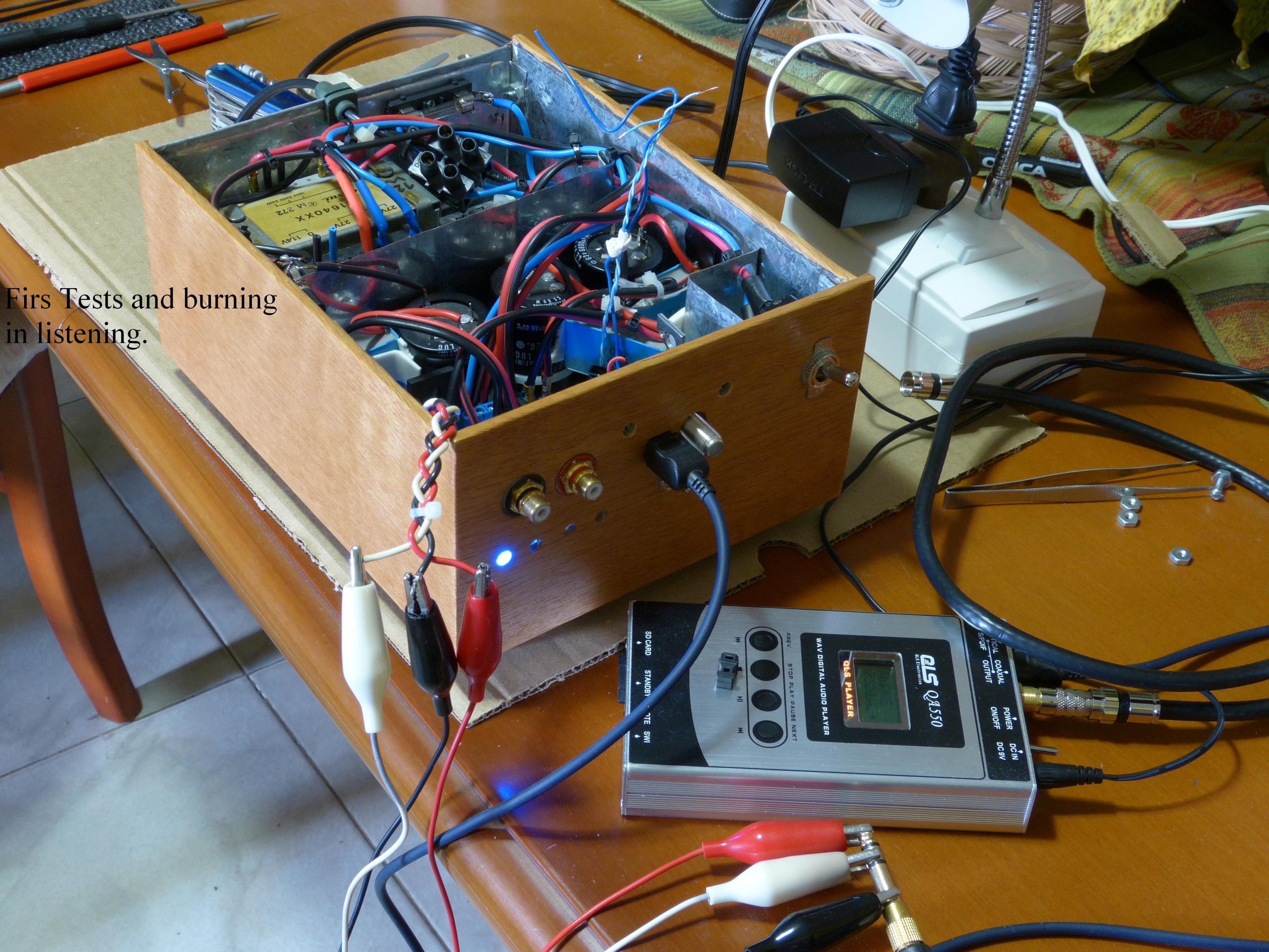

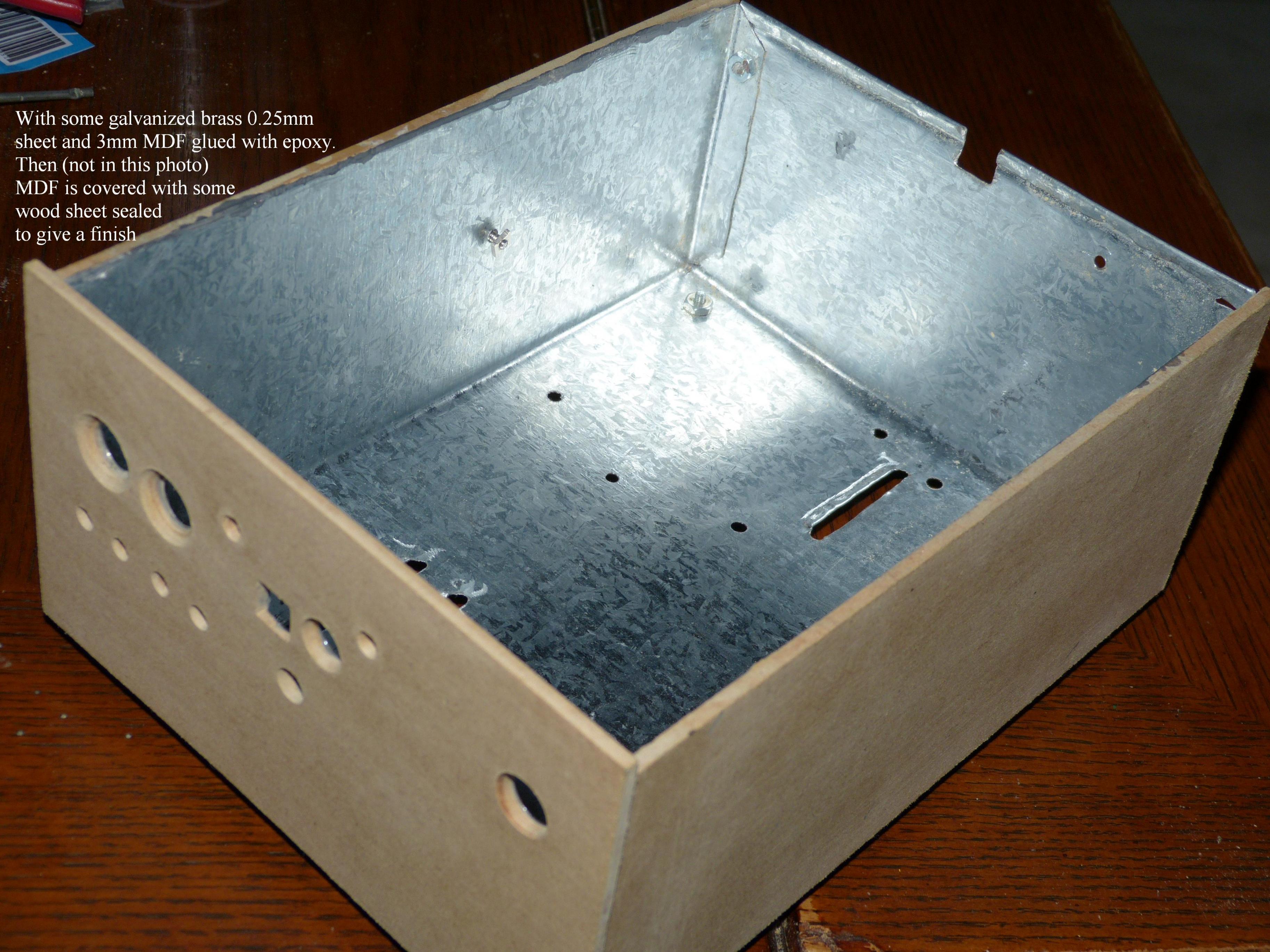

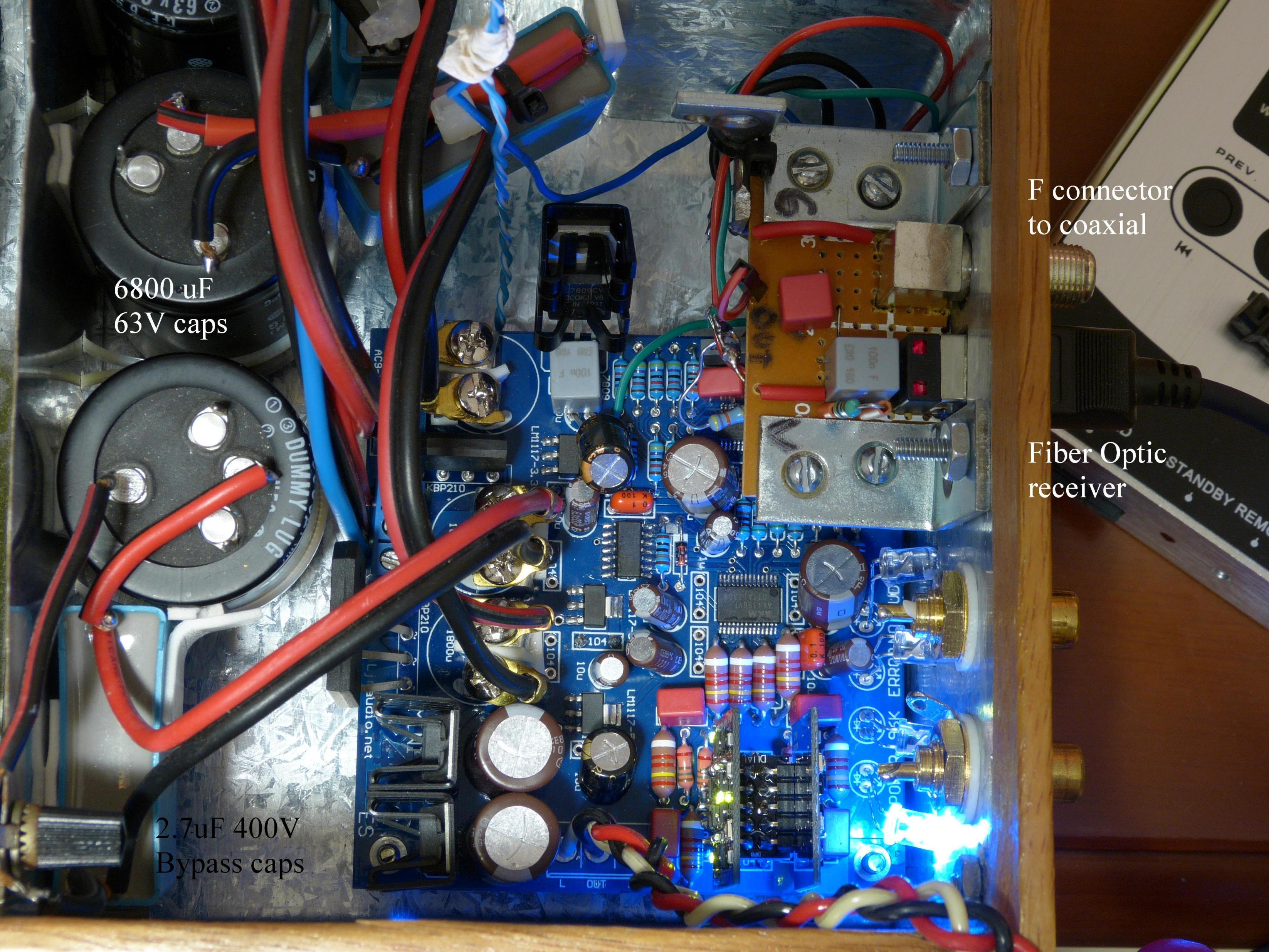

First of all want to say thanks to erin and to clave, because they (and of course others) make this thread and Diyaudio worthwhile.🙂
I received the unassembled kit and used most of clave suggestions (some components like resistors are difficult to find) and some other components like transformers, big caps and some 0.1uF caps come from my own spare stock (at last can save some money). All clave BOM suggestionns are well suited to fit the PCB and to give the best sound you can achieve with this miracle cheap chip.
The 120 W Sansui transformer (taken from an old 70's cheap and broke amp) runs very quiet (at 10% of max. power) and everything seems to be in order with the PSU. I'm using a bigger 4 Amp Fairchild rectifier bridge for analog section (legs were very carefully shaped with a Dremel tool to fit the PCB holes).

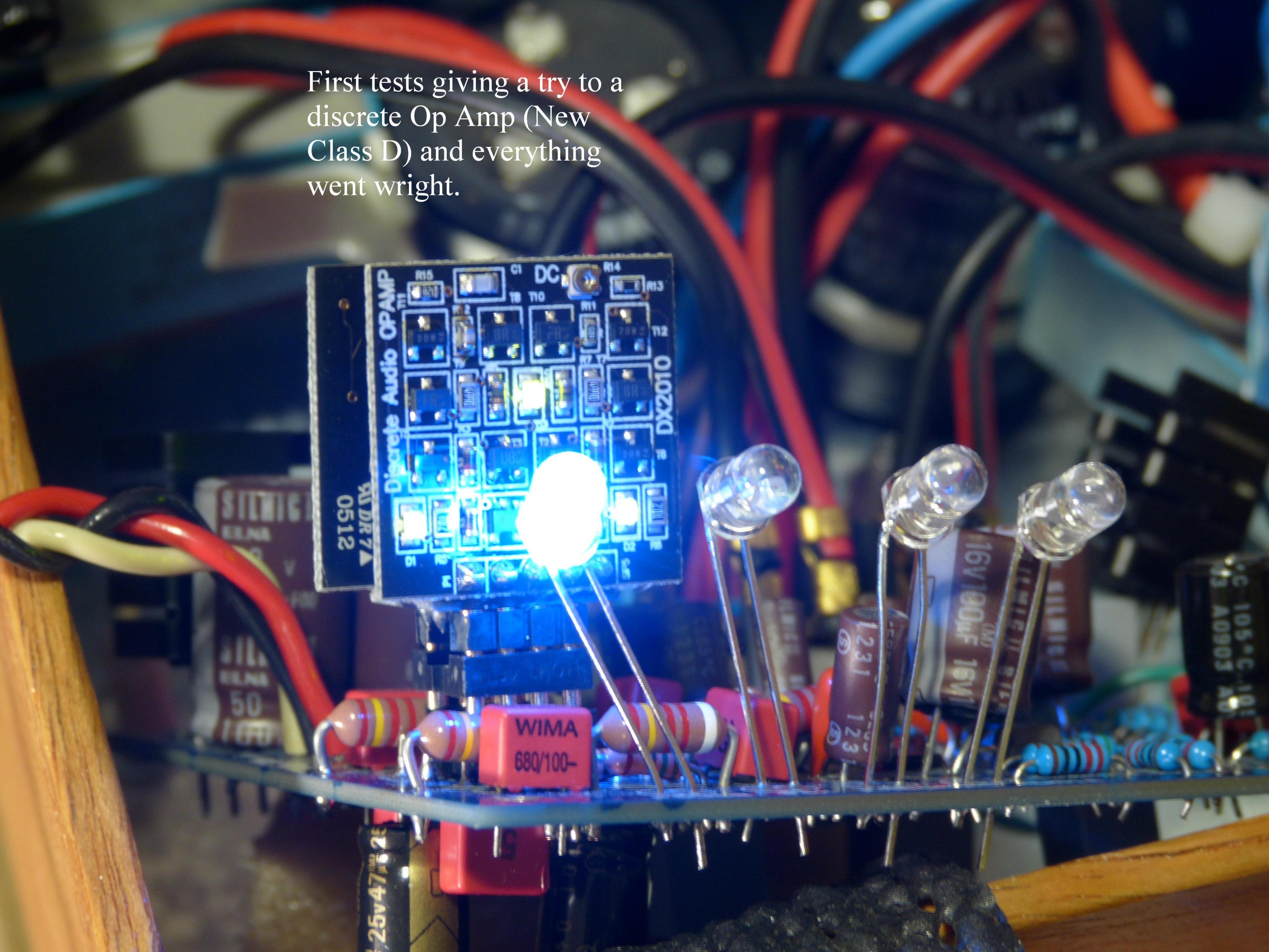

Now I'm in the burning in process and I'm using a discrete Op Amp (New Class D). I have to say that the sound is a lot more clearer than using the BB OPA627 and BB OPA827 (strictly IMHO). I am skeptical using chips and components without datasheets, but in this case the sound (specially in the highs) is the cleanest and pure I heard with any OPA in my entire life. Violins are a dream, you can hear with detail the nail hitting the acoustic guitar string (impressive). And with the burning in process things are becoming better and better.
I will share some pictures with you guys, maybe in two posts.
Other pics
In this second post will share some other pics. Maybe later will be able to give more details (after burn in).

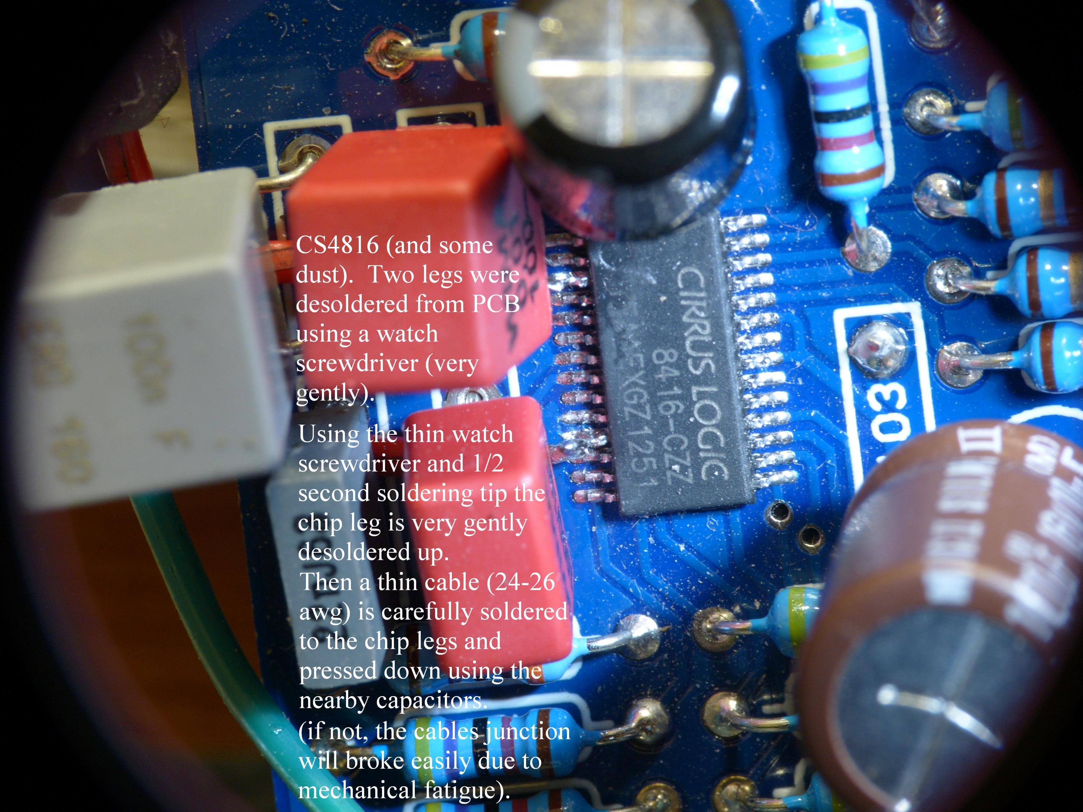

hey,
i'm considering modding this to use direct i2s input instead of spdif. i have a couple ideas (and a bunch of questions) as to how this could best be accomplished.
- remove the 4x 51ohm resistors that send i2s from the cs8416 to the ak4396 (is it OK if there are no resistors between i2s source and sink? some of the usb i2s interfaces i'm looking at don't have them, and i don't see an elegant way to add them into the chain otherwise)
- in the now empty holes closest to the ak4396, place a 4 pin 2.54 SIP male header
- where the "bodies" of the 51ohm resistors previously were, carefully expose ground plane and solder an additional surface mount 4 pin 2.54 SIP male header. (any caveats or pointers to how to do this? fine sandpaper until i see copper? i would like to leave the board in tact if i want to go back to spdif input later).
- use a cat6 UTP ethernet cable for the interconnect. there are 4 twisted pairs, so each pair would have a signal+ground. i would terminate each end of the cable with a (soldered on) crimp connector to mate with the two 4 pin SIP headers on the mini2496 board. (would the standard SIP pins be ok? i've read u.fl is best, but its unfortunately not realistic to do given the constraints of this pcb)
- optionally, come up with a way to power off the cs8416 circuit since its unused and would just add noise/emi to the dac (would depowering this completely affect the proper function of the PDN pin on the ak4396, or any other of the connections on the 74HC04?) the three ways i see to do this are:
- desolder/lift the VD and VA pins (difficult)
- remove L1 to remove VD power, and lift the input or output pin of the "analog" 3.3v LM1117 to remove VA power (easier)
- cut traces (bad)
