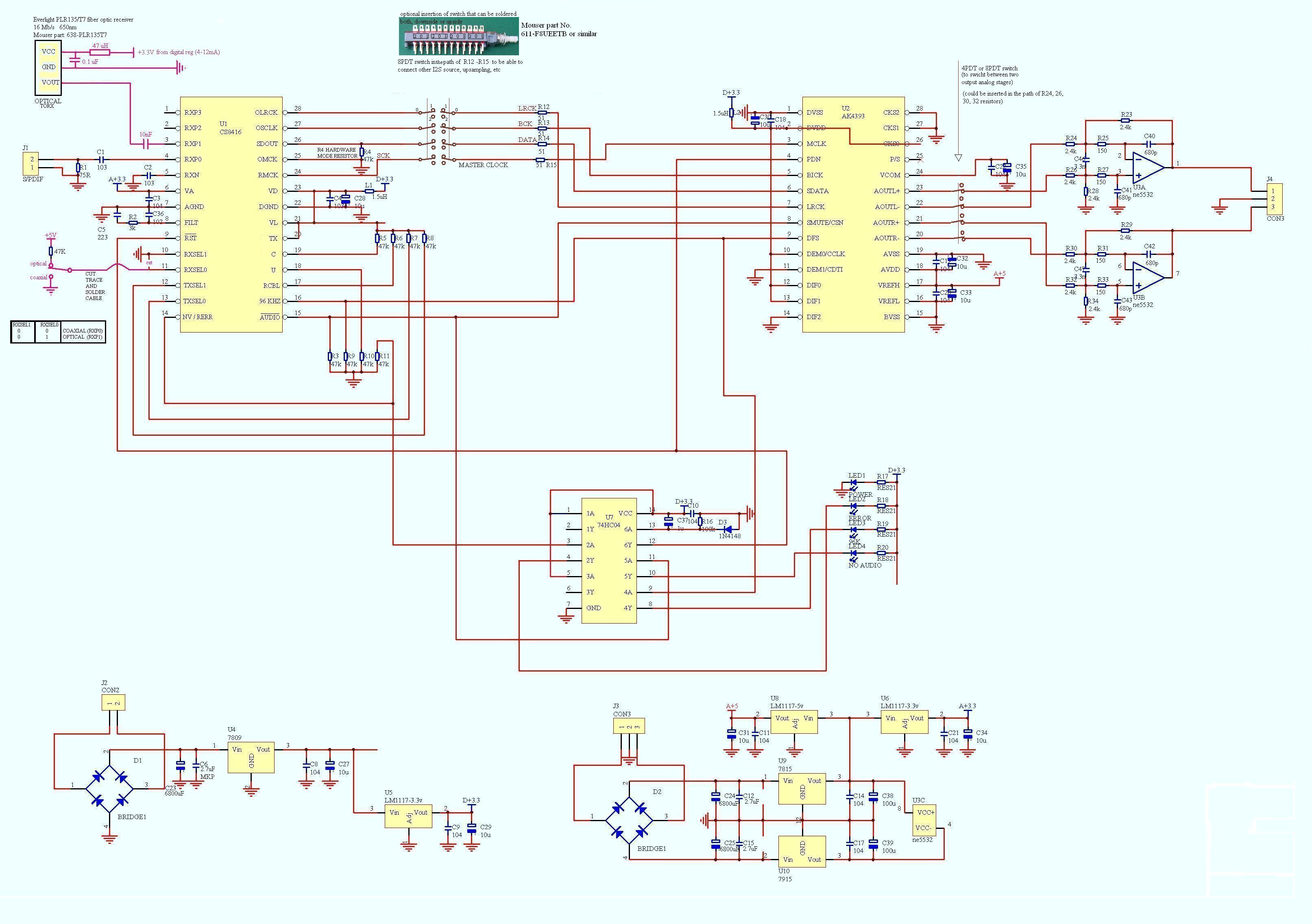

Edited the schematic of this Thread to explain my intentions, maybe is better than write. If someone tried to put switches before on this or a similar board, or already knows if it works (or if this mods can have some trouble), please advice me.
