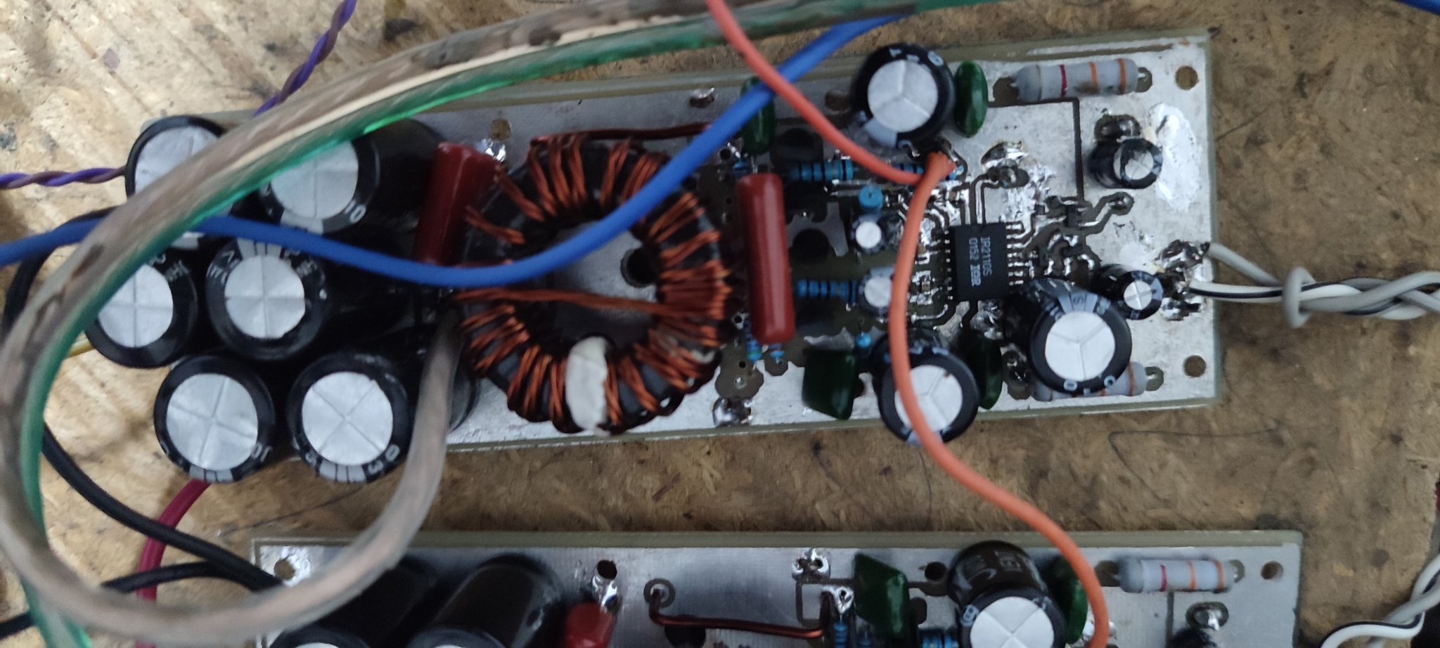

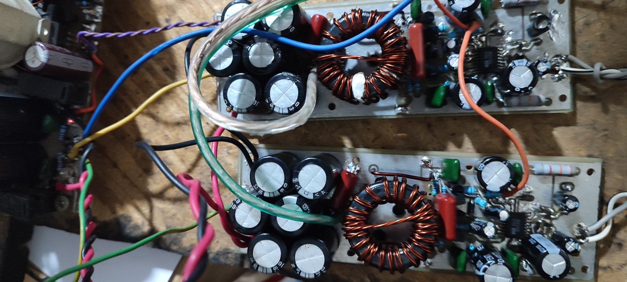

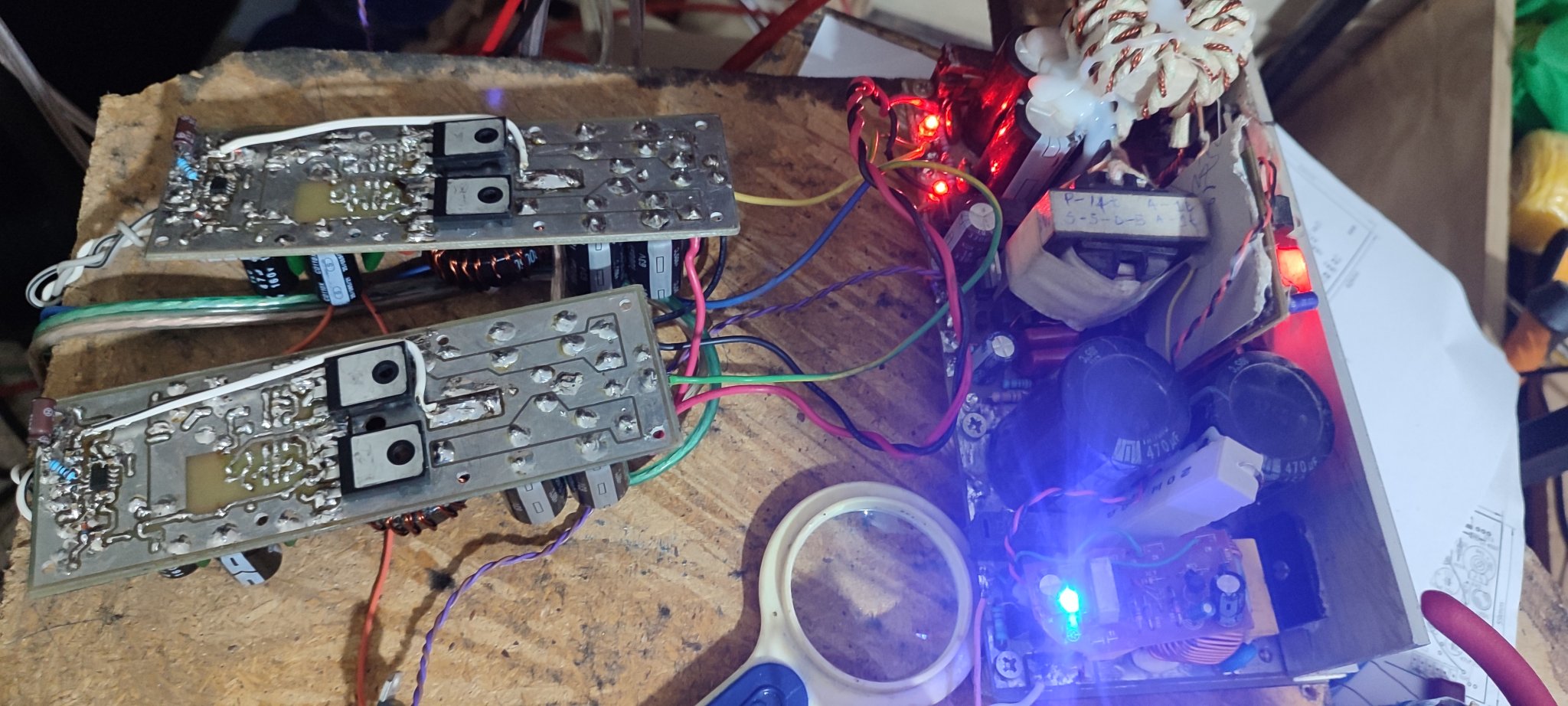

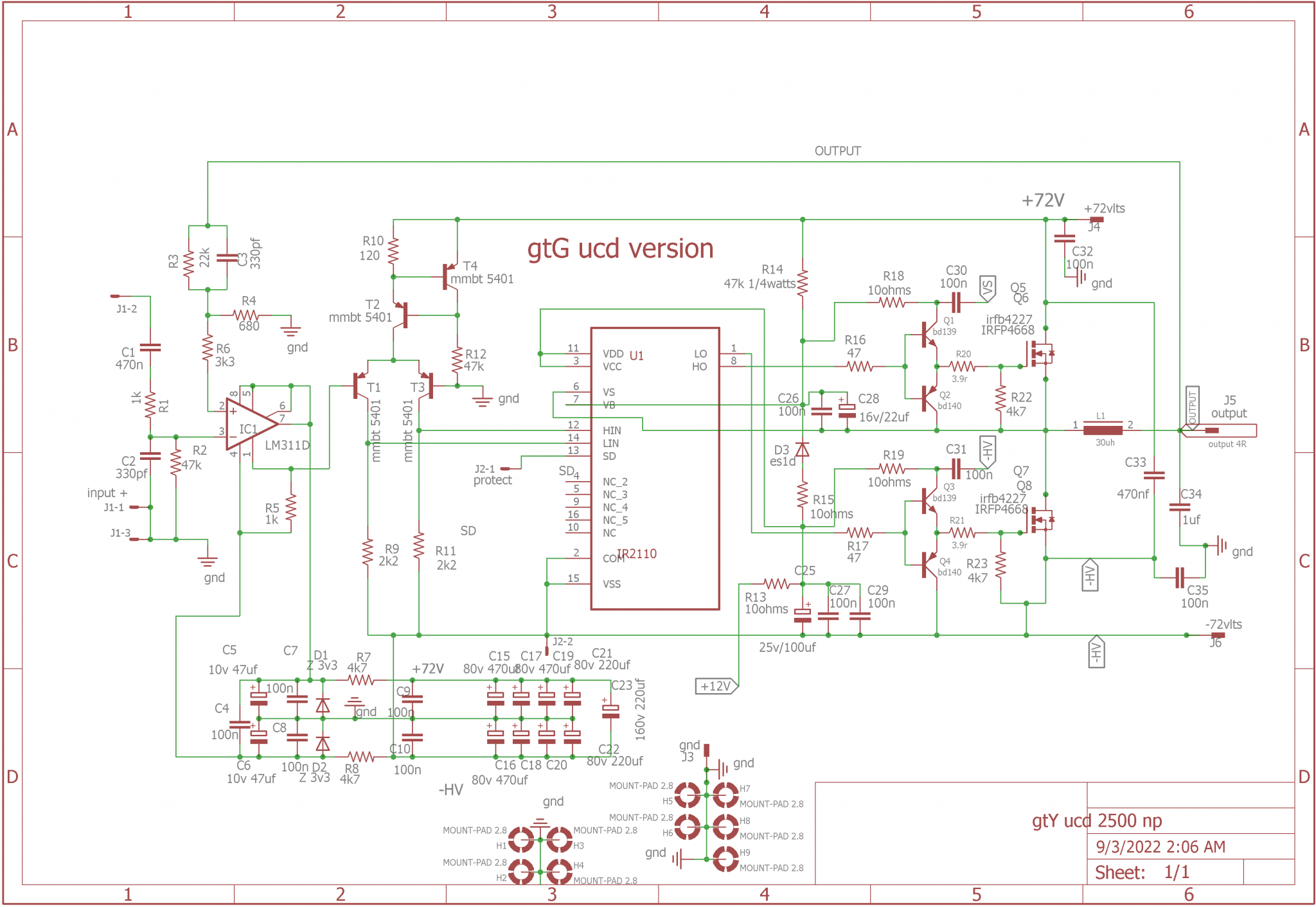

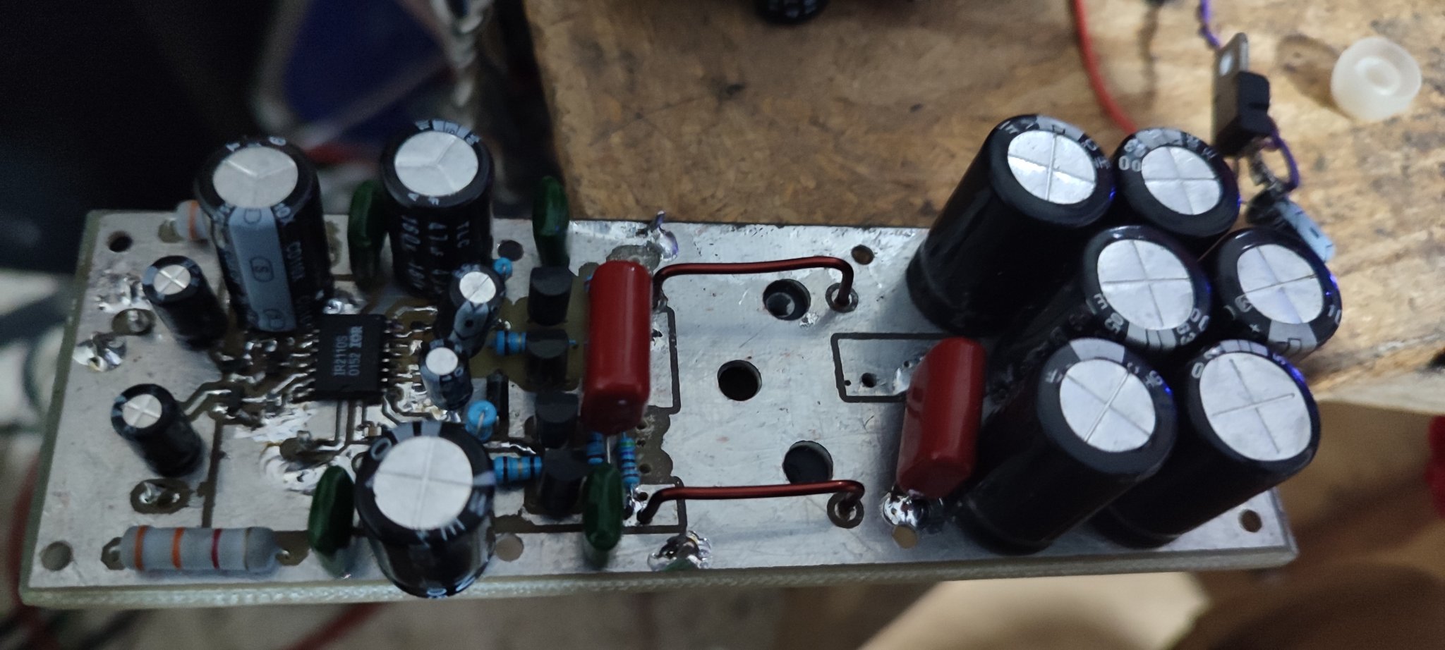

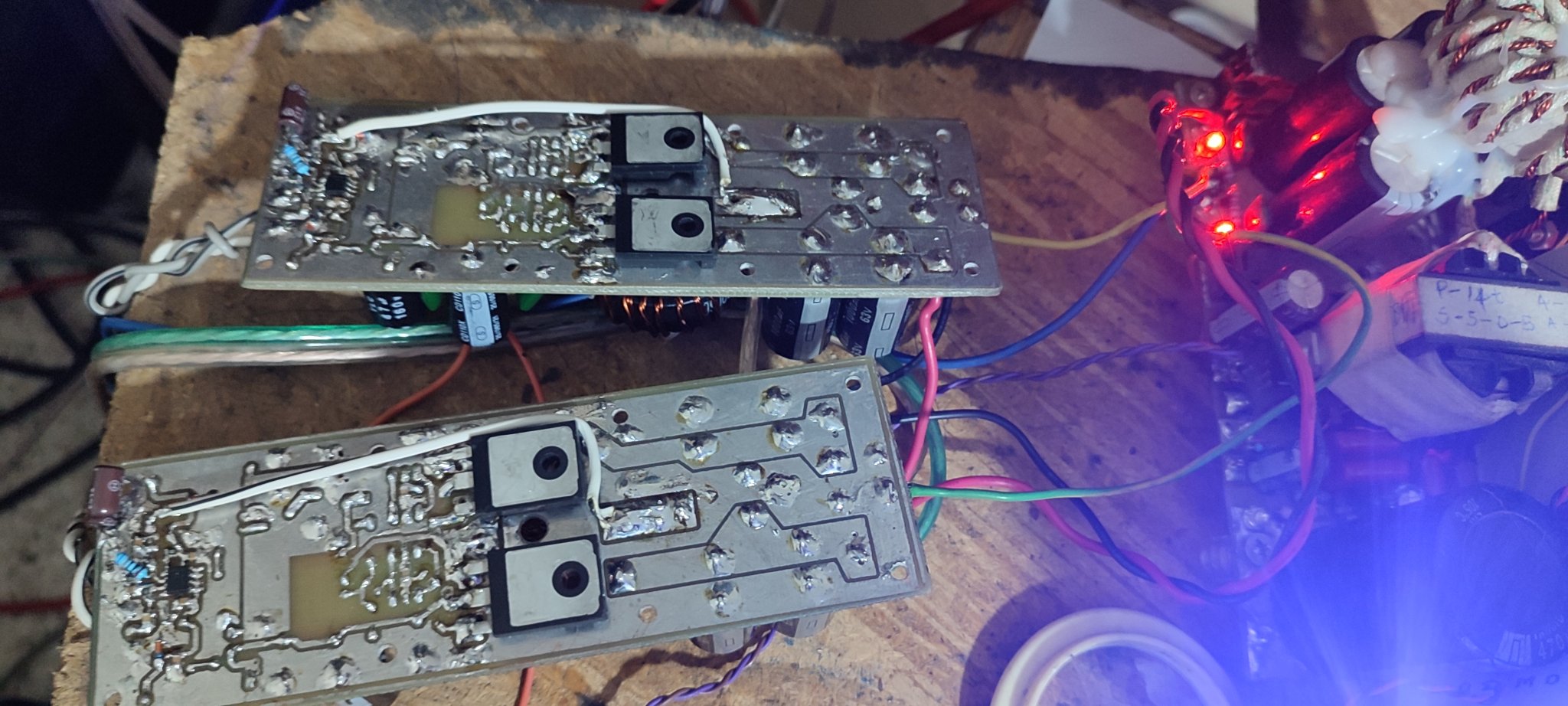

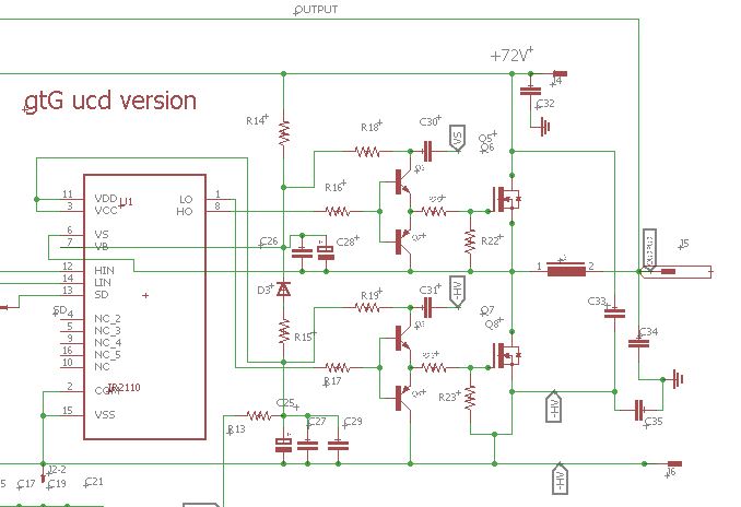

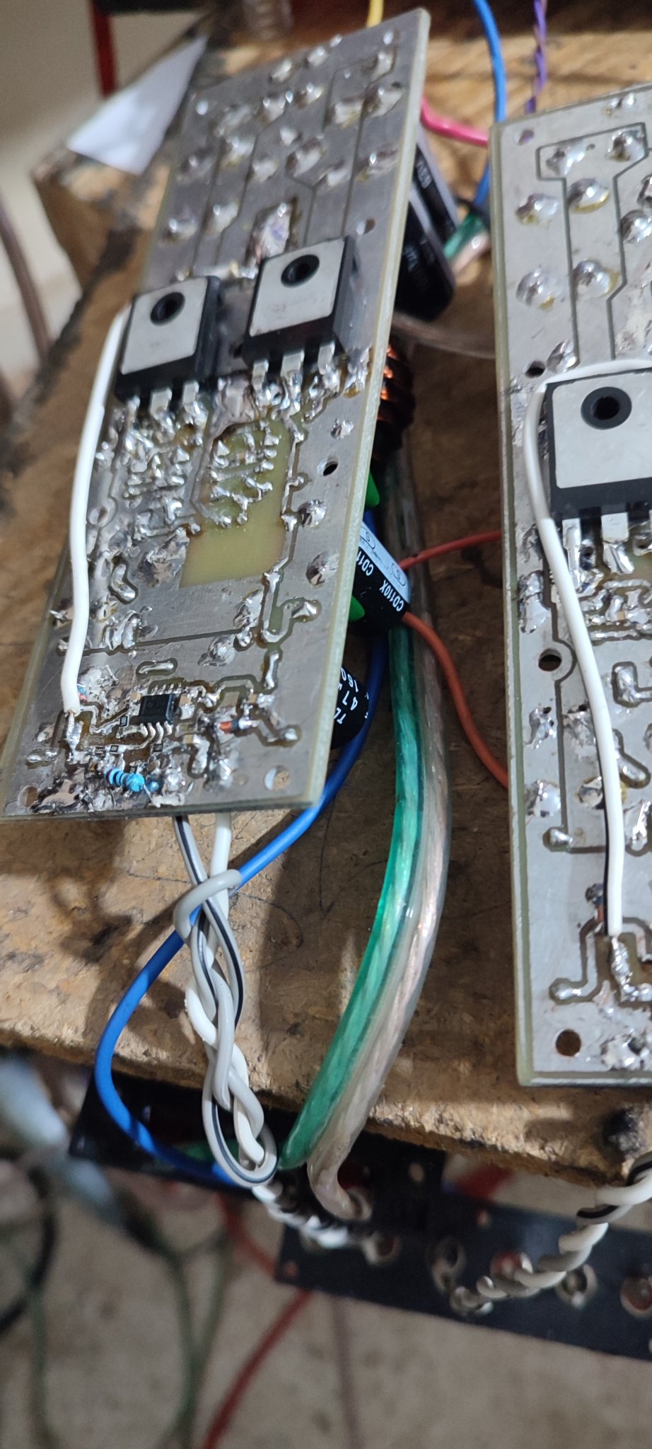

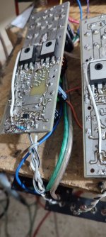

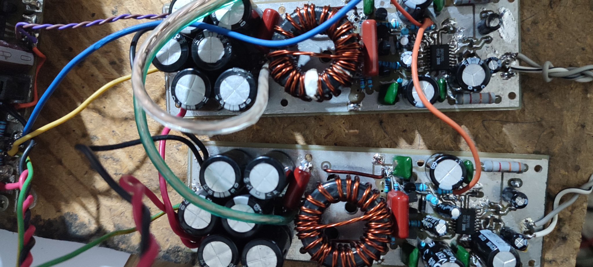

my design , based on etjale 1200 watts .
the amp is clear but the hf noise at low volume is the issue
Hi, do you have any progress with the project?
Have you found how to solve the hf noise? Have you tried to run the amplifier with regular power supply?
