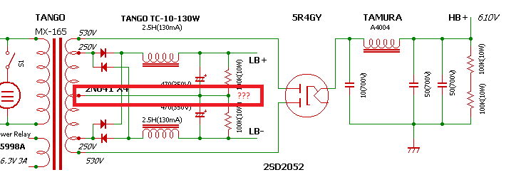

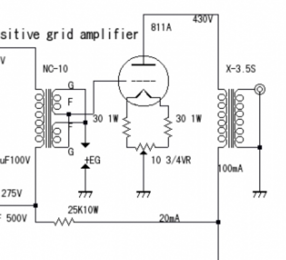

I saw a chinese guy run 600VDC on 3.5K OPT and use 6v6 280vdc anode to drive .
But wattage is more than 15W which seem better but don't know schematic.
How do you get to 15W? Let's make some assumptions:But wattage is more than 15W which seem better but don't know schematic.

I'm assuming that the 811A grid current at idle is 30mA or less.
I don't know but many chinese claim 811a 15 watts
Please use google translate. But most schematic run 400Vdc

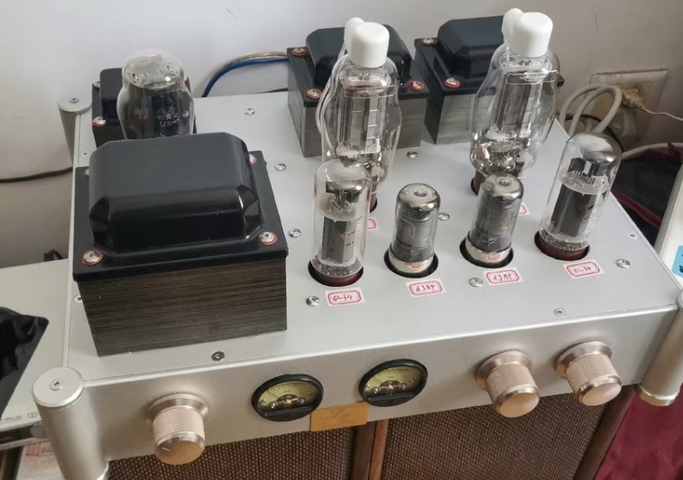

Another chinese run 600V 3.5K opt but using 6v6 instead of EL34 as picture i think it should > 15 watts
If 811a can run max 15watts seem sad to me. Otherwise kt88 120 150 SE can get more than 15Watts

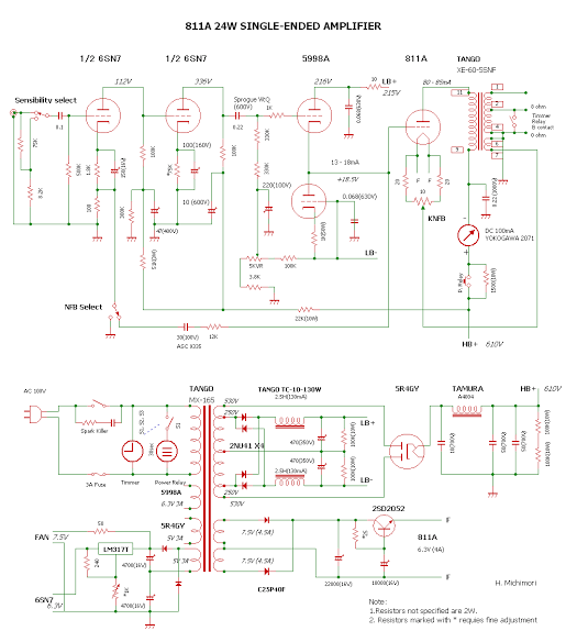

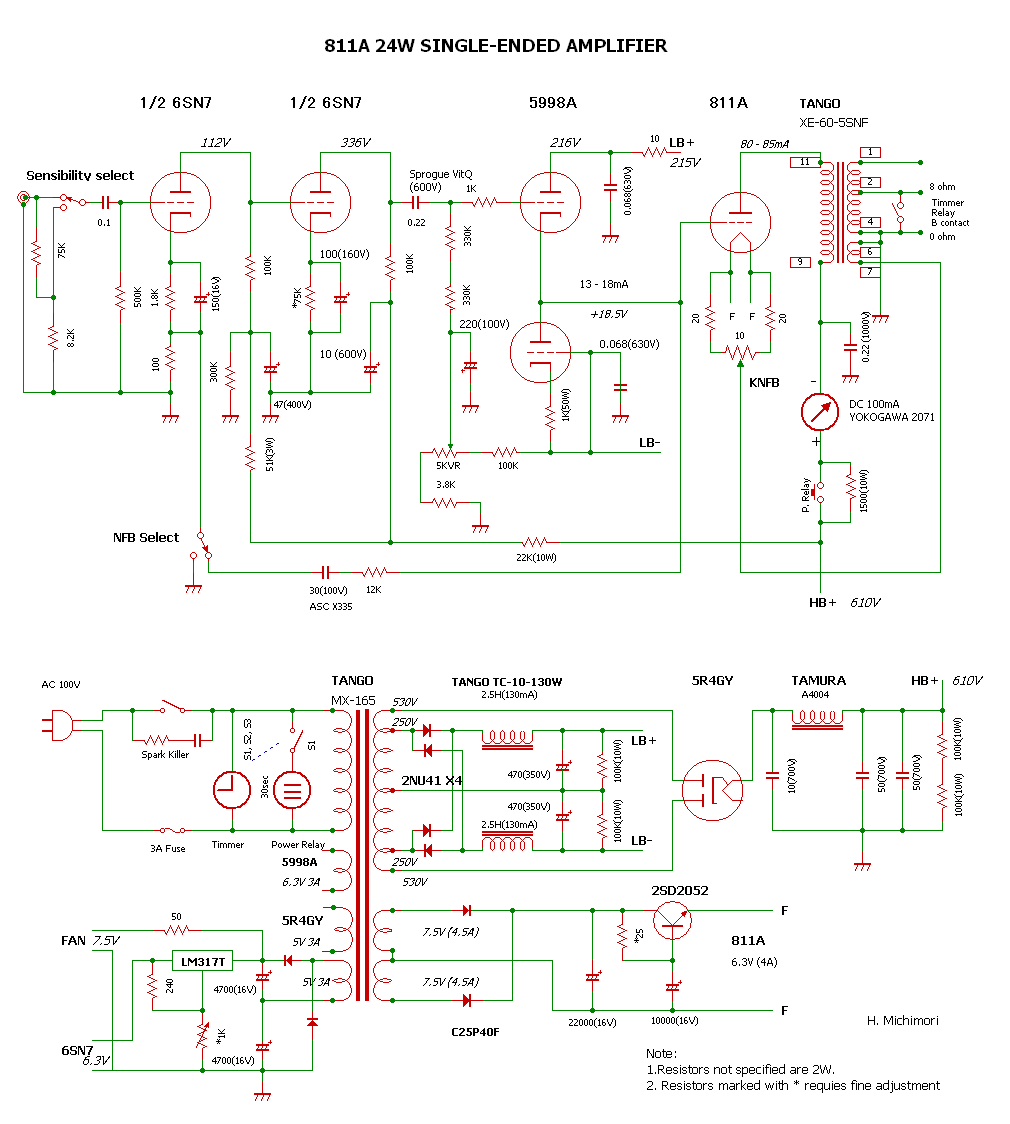

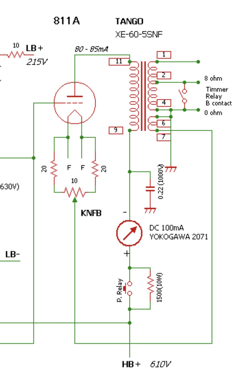

Thank you mr jcalvarez, now I have a clue of calculating wattage. I also have 2 of 6080WB as 5998 in above schematic. but after I read many thing about JJ 6V6, i think it is neutral enough to my taste with good bass. EL34 seem a little midrange forward. For SE may be a little dark tone like 6v6 or 6L6 might match.
Question is it possible to replace 6080wB to 6v6 in 24 watts schematic?
Thx so much
Thx so much
A 6080 is very different from a 6V6. You will definitely have to change at least some resistor values to do that.
About that schematic, I do not see the ground return from the power supply, it feels like it is hanging in the air.
Then schematic is not correct.

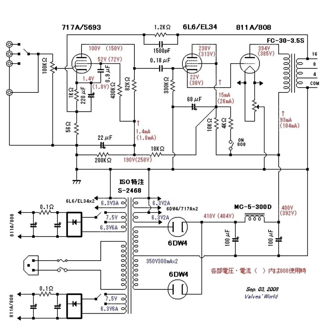

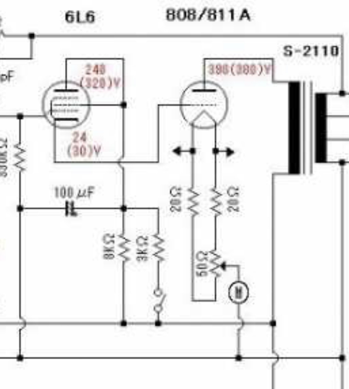

Can you help me calculate 811a wattage under condition of using EL34 to drive at 30VDC 28ma and Va of 811 is 385VDC 104ma? Thank you in advance.
Sorry for bothering you calculate again
Which specific schematic? It will make my life easier 😀Can you help me calculate 811a wattage under condition of using EL34 to drive at 30VDC 28ma and Va of 811 is 385VDC 104ma?

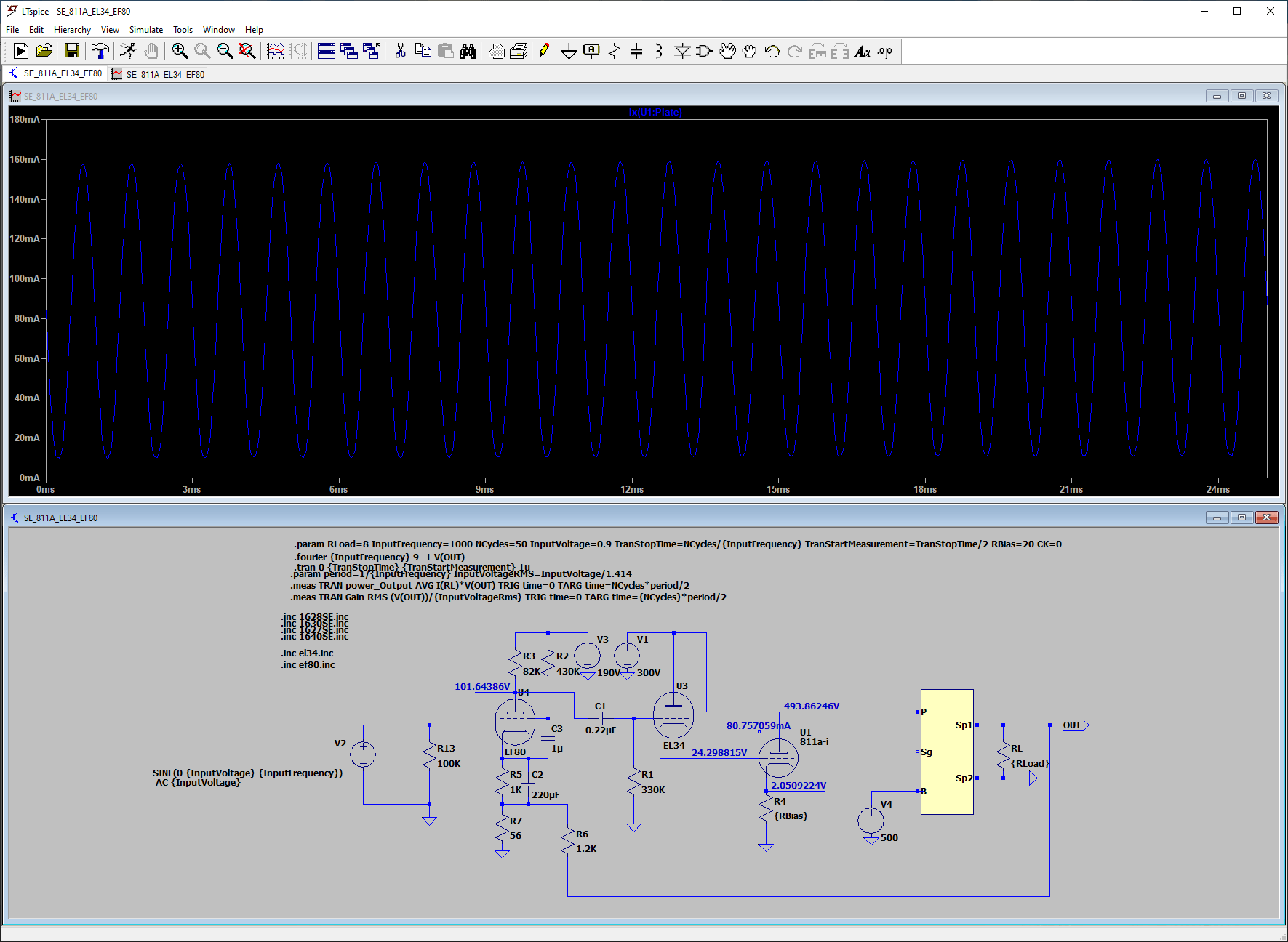

OK, so what you need is not 811A dissipation, what you need is the output power. I will do some simulations.
You are not going to get that with an 811A. The 45 is very linear. The 811A is not.>I want sound like 45SE which I drive with 91db Seas P25REX.
I tried different output transformer options (3.3K and 5K), playing with supply voltage, best I could get was 15W, with 2.5% THD, and a very ugly distortion profile.
I'd say keep away from the 811A. You will get better results with a triode-strapped KT88.
In general getting 24W from an SE setup is not that simple, and, taking into account that your reference is a low power tube (45), then I'm not sure why you need 24W.
