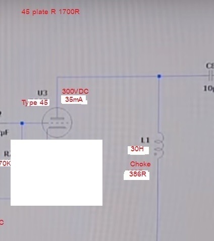

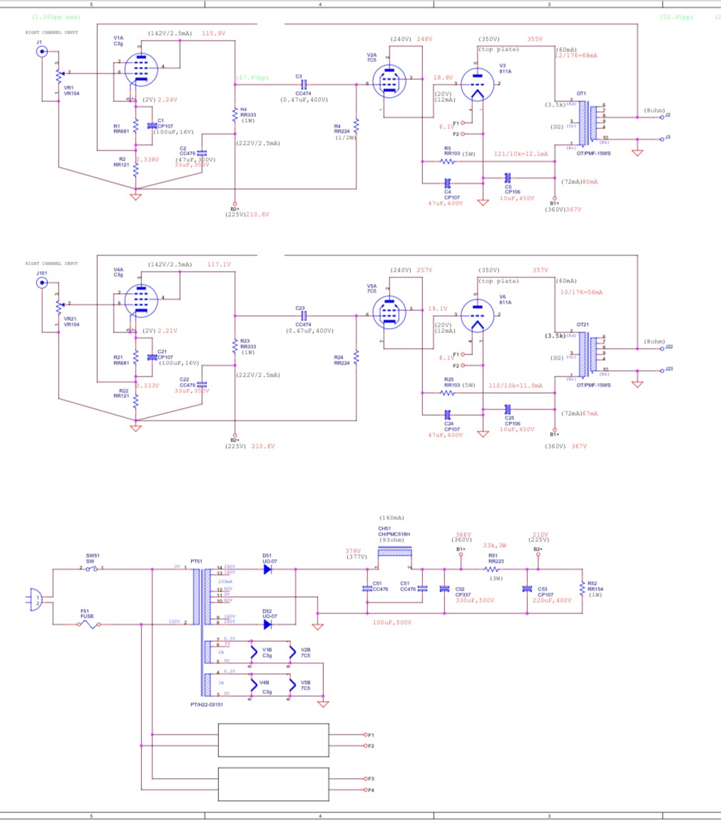

in the past when I make 45. I plan to use parafeed to on 1700R plate resistance of 45 which need choke around 30H as picture.
However I don't know the value of 811A plate resistance to calculate. Anyone can guide which value of 811A plate resistance to be used in calculation of CHOKE.
Hammond 1628SE has 40.78Henry. instead of using OPT as parafeed choke I think buying 45H choke 120mA might save a lot of cost.

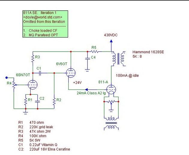

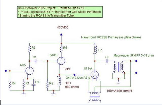

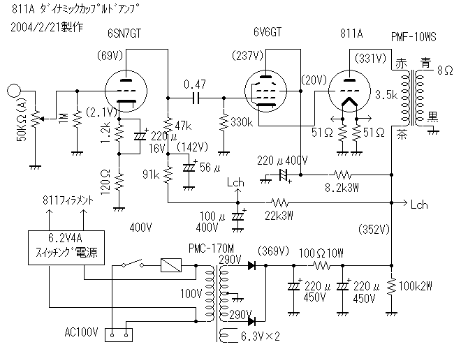

This is from Jim Doyle's Flickr page. It seems rather clever to run the driver plate current off of the 811's grid current:
Class A2 811A amp amended to use
MQ Parafeed transformers. The original
Hammond OPT was converted into a plate load choke for the 811A. FYI - with Parafeed the performance is amazing, especially with bass!

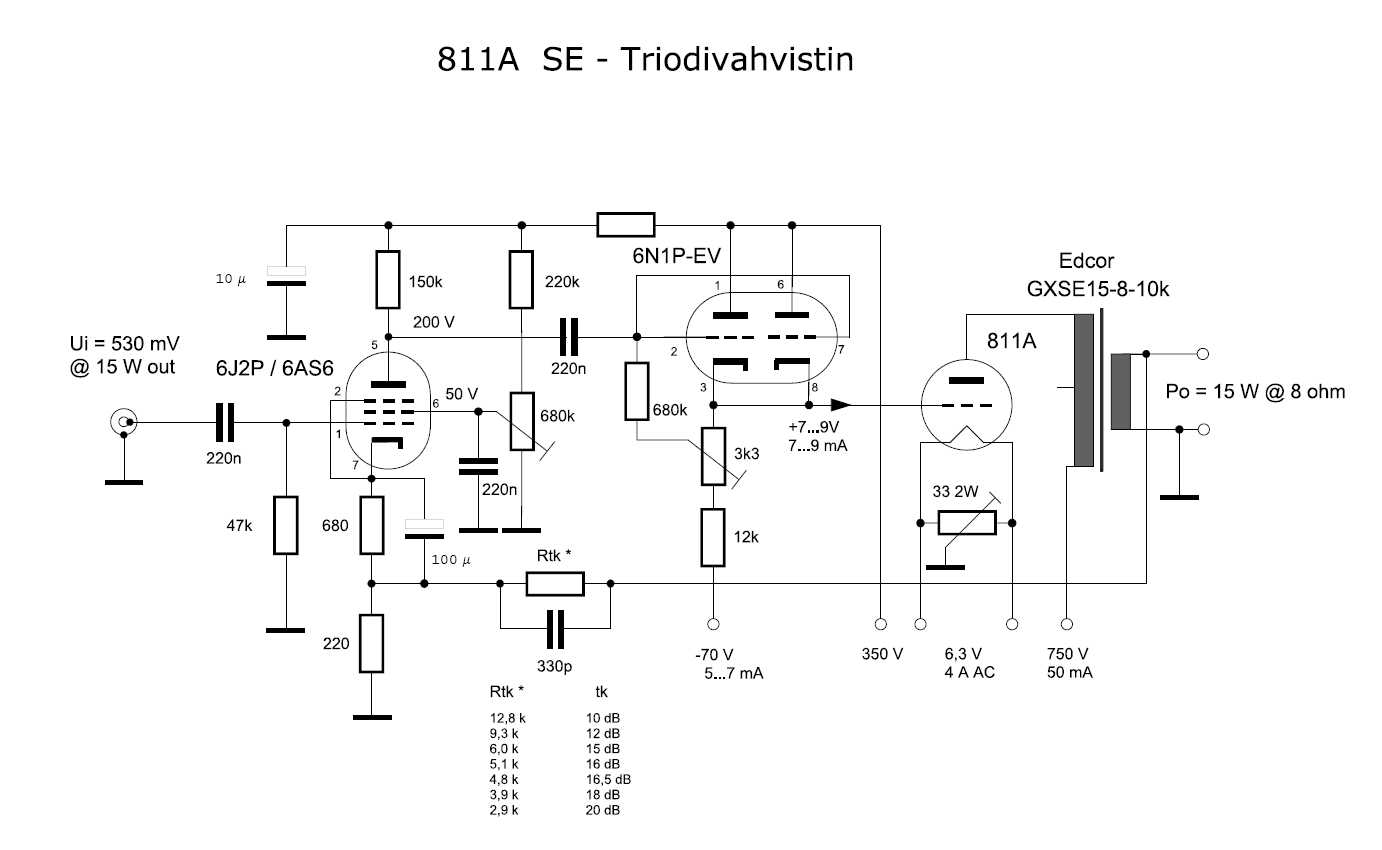

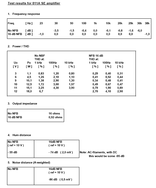

I found old documents of the 811A prototype I built almost 15 years ago. My version has relatively high supply voltage (750V) and therefore grid current drive of 811A is lower than examples shown here with 400...500 V supply voltage. Therefore I would recommend 6N6P or 6DJ8 as a driver tube.
Attached the schematic and test results.

Using 811a at low/er/ anode voltage (and class A2: positive grid voltage, relatively large grid current == beefy DC coupled driver) advantage is the lower impedance OPT (lower cost).
Sample:

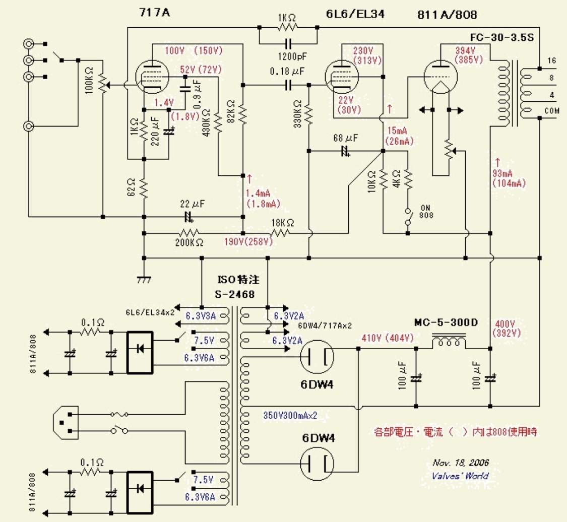

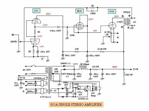

I think this schematic match all my tequirement but just 2 things needed
1. Replace 6v6 to EL34 mullard Russian made cheap and ok

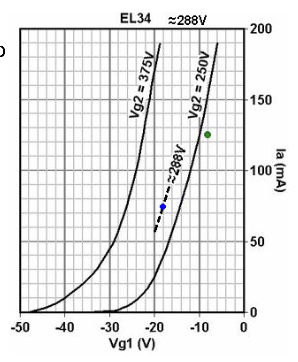

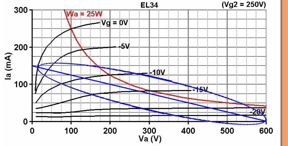

2 EL34 should be fixed bias to prevent unbalanced tube that I encouter with 45 SE how much negative voltage of fixed bias of EL34 if replace?
I guess if replace with EL34 fixed bias negative voltage will be around -15V
I don't have knowledge I just clone other i admit it.
