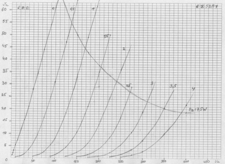

Did anybody actually get any 6J52s?
I have tried 6J52P in two different amps. They sounded pretty bad compared to the D3a, harsh and metallic.

I recently build a line amp with Siemens D3a. Running at 150V and 20mA into Lundahl 1660 4:1 Line Driver. Sound was nice as its normal with this tube.
I think its really worth the price ( I paid 16 Euros ).

These tubes, like their european equivalents, E180F & E280F really have a fantastic sound when used in an SRPP configuration.
Really amazing!
The problem I see with the D3A is the low g-k voltage, you never really get a 70x gain because you end up in a positive grid when you are pushing for the desired overall amp gain. 6e6p in most applications gives more ultimate power.
Its great for amplifying low level signals like in a DAC or phono preamp.

Surely that D3a is wired triode not pentode ?
Sorry for resurrecting, but I tripped across this schematic while looking for how to select resistor value between g2 and anode on D3a. It says D3a pentode, but the diagram shows triode mode ? g2 direct connected to anode ? Am I right ?
The schematic is in post 1 but the thread went off to discuss alternative russian valves, group buys and Fawlty Towers ...
I ran across this schematic of a parallel 2A3 with a D3A as a driver (Redrawn from Audiodesignguide.com)....I can't seem to find any info on this tube!
Most of the more "common" tubes have entire colorful histories associated with their development. This D3A I can't find anything..what was it used for , when did it first come out et al.
