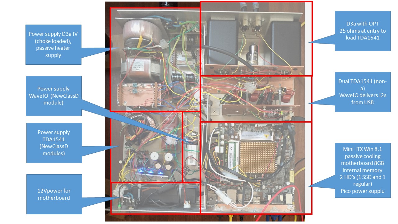

So here is my layout.
The sound is incredibly good I must say even when I only use a standard USB cable (will replace this with silver). Only some buzzing and weird by-sounds. Maybe my layout/grounding implementation needs work. Currently working on the last details and the (wooden) housing. the things weighs about 15KG.
Forgot to mention that on the other side of the aluminium are the capacitors (7 33uF motor start caps per channel).
I would arrange the whole wired up one.
"buzzing and weird by sounds" are a clear sign of oscillations. Even more if eg. you touch the tube with your bare hand and the noise changes.
Let me guess, apart from the bad wiring ( no shielded wire for microphones ), did you skip the input resistors ( 1kOhm most the time ) ? Is your PSU good enough and are both tubes decoupled from each other with additional RC filters ?
