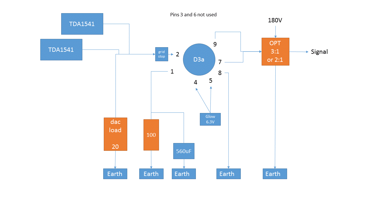

Greetings. I wish to create an IV stage for a parallel TDA1541 dac. The d3a tube with an OPT seems the best option to me (I like transformers more than caps in the signal path). I would of course like to have low output impedance and output about 2V.
But I am not a real tube designer so I have drawn a schedule (based on various sources) but have some questions about it (orange):
1. Is the 20 ohm the correct value to load the 2 times TDA1541's?
2. Is the 100 ohm value correct?
3. What will be the gain with the OPT 2:1 step-down versus 3:1 step-down? Also the output impedance?
4. Do I miss anything that might be beneficial for this circuit?
5. Did I do anything stupid?
Thanks 🙂

I have similar configuration but only with one TDA1541 per channel.
I'm using 33R as I/V resistor. Theoretically the value should be somewhere between 22 and 68 ohm.
Instead of 100 R cathode resistor and cap you can try LED diode.
The 20 ohm Riv might be too big value for the TDA1541A because of the 25mV
recommended off-set by the data-sheets. Any larger value will increase distortion.
So the value of Riv = (2 x offset [V]) / Abs(Iout)[A], Riv = 2 x 0.025V / 0.004mA = 12.5 ohm. That is for ONE chip. For 2 it will be 1/2, 6.25 ohm or 1st lower value. Essentially NON inductive part. And mounted closer to the gain stage than Dac chip...

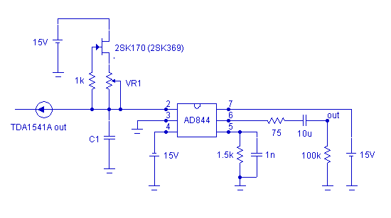

But You should apply Current injection at output of about 1/2 Abs(Iout)[A],
that is 2mA. It could be simple JFET current source adjusted to 2mA. Close to each Io pin.
After that for 2V out You will need about 40 times gain stage...
In Your case the interstage transformer should be from very high quality to acheive good bandwidth. That is mainly covered by the internal resistance of the tube, and primary inductance of the trafo, capacitances of the trafo.
Take a look into the datashhet of the D3a, in range of about 20mA it have little bit higher than 2Kohm internal resistance. That desreves much primary inductance for low end range. maybe close to the 3 digit first value... While the amplification factor is about 80 times, so the step down trafo if used, it should be 2 : 1. Put some 100ohm resistor to G2 🙂

It is hard to obtain +15 when tube output used. +15 and -15V are present when OP or JFET or BJT stage are at the output of DAC... But You could use the same example with +5V
power supply already present as TDA1541A power... It is not Analog line but for the try will no harm the chip or other devices. BUT first adjust the 2mA current without connect to chip. After adjusting 2mA value (measure), then connect to the chip and measure again optionally readjust. Measure from +5V to JFET. 🙂

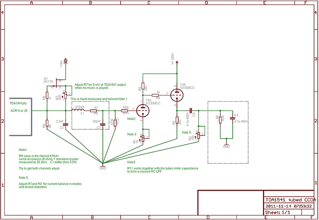

Find enclosd my schematic, may be helps for understanding.
I am reading this thread and I want to comment. I read the document written by Pedja and there is no current injection. The output I out consist of a -0 to -4 mA a.c. signal and there is an average -2 mA current at the output which is bad for the opamps bias. In the opamps or discrete transistors that - 2 mA signal current bias can bias the input stage wrong. In tube amps you can deal with this or ignore it. What pedja's is saying is that if you create a voltage potential and you raise the signal to let say 3 to - 1 mA this will affect the DAC internal functioning, as this is referenced over 0 mA of average output current the dac output will receive a positive voltage in its output stage. I experimented with this and transistors will sound better with a null reference at input and I think the dac likes to see some voltage at the output. In tubes there is no need to do this. Also the lampizator schematic has not worked well for me resulting in excessive distortion and amplification. A simple passive resistor followed with a one tube cathode follower is what sounded best with tubes and I also built a headphone amplifier straight from it. However, with transistors and feedback there is much more resolution and it fully retains the details and musical texture of this unique dac.

As you will see in my schematic I use step-up transformer after I/V resistor which eliminates any DC effect. I experimented with several tube output stages but for me the SRPP mini-tubes design of Lampizator works very fine and up till now the best sounding result. I also use them in a pre-amp design. No idea why you had problems with them.
This design has been reviewed by an independant person running an exclusive high-end shop and compared with expensive DAC's form Antilope and Wadia but became the clear winner. So it can work!

See the solution from First DIY DAC, Using TDA1541A (part arond Q1).

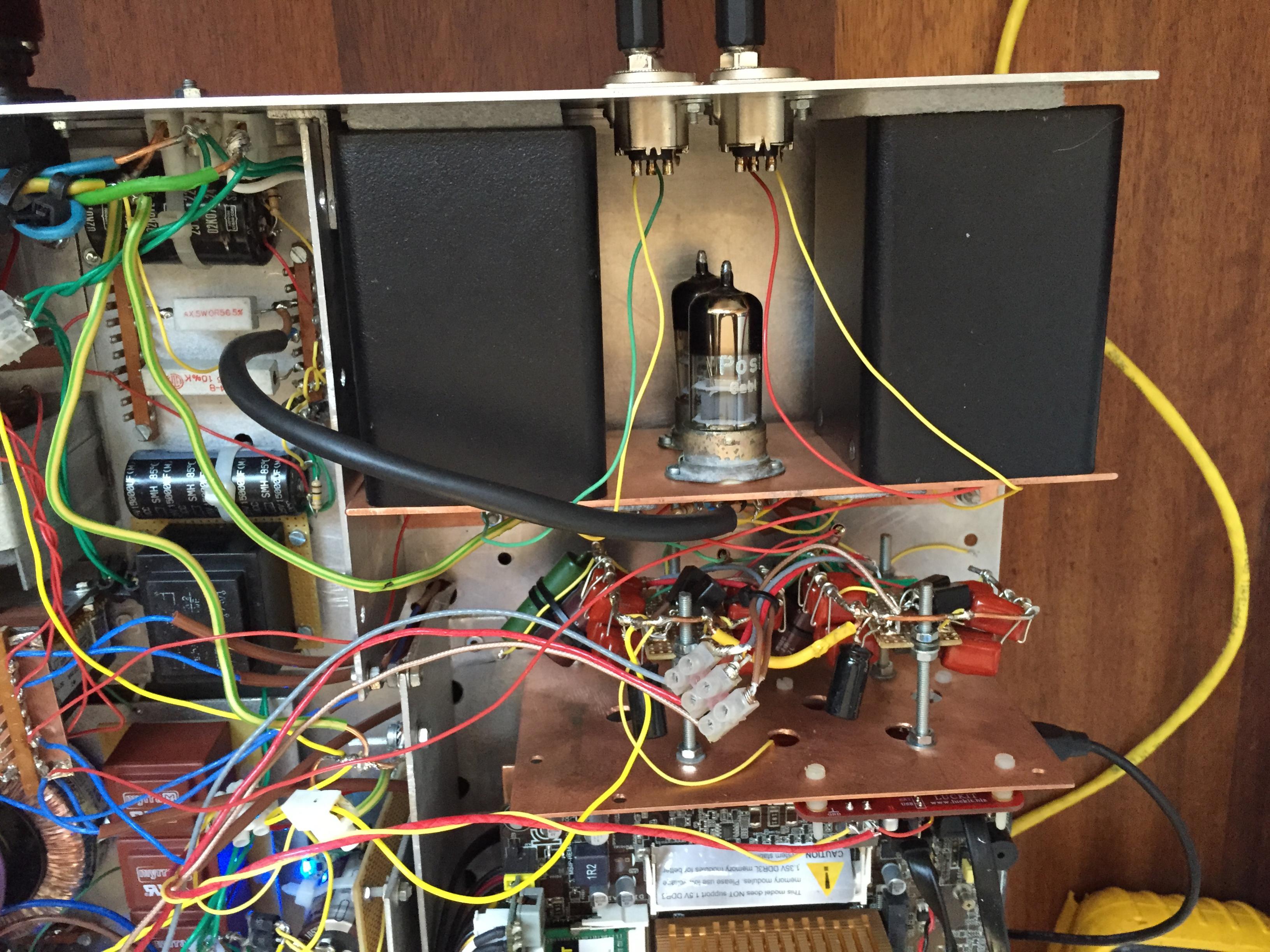

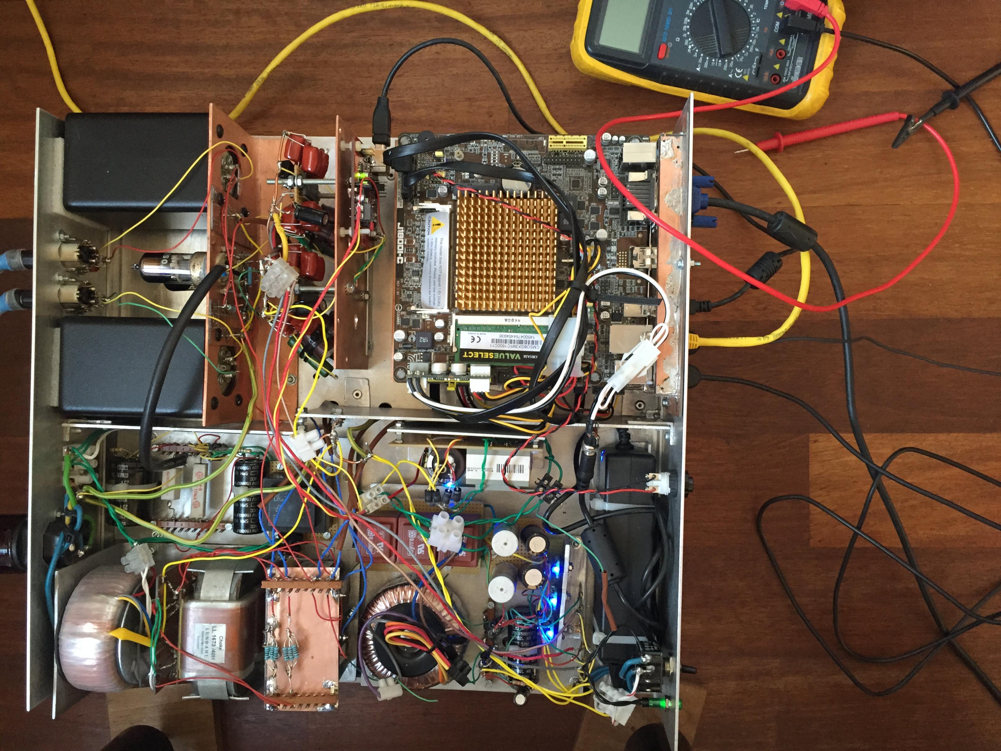

Hi jev, it is a great construction!
What is the circuit? where is the tda1541 ??? did you have the transformer for balanced outputs?
