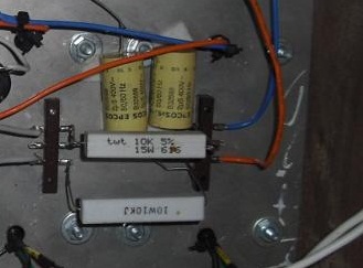

Friends I need help, I'm already a few days ago with this amplifier can not find the problem..
The problem is with the D3a tube, not give me enough amplification, with 1V peak-to-peak (1 kHz) at input give me 2.5V to the output.
The anode voltage is 190V (10k resistor load) and the cathode is 2.1 V with a resistance of 104ohms (20mA aprox). Filament 6.6V.
In one tube G2 is connected to the anode and g3 to ground and on the other channel g3 to cathode and g2 to anode, in both channel I have the same result.
The tubes test good in my Eico 667 tube tester (95%)
Any idea?

Sorry for be unclear, the measurement is in open circuit, I put a 100k resistor to gnd for measure the output voltage (anode-cap-resistor to gnd). Please see the picture.
The cathode is bypass with 220uf cap, maybe low value?
The voltage signal (1V) is measured in the 1k grid stopper resistor.

Hi! These two yellow caps in the first picture, right above the 10k resistor. It is my impression they are connected to the 'wrong' side of the plate resistors. They are probably meant for decoupling of DC supply, but it looks as if they have been connected to the anode side of the 10k resistor. This could explain why you are not getting gain. Still, the picture is not very clear.
Other things: are you sure the 100k resistor after cap is indeed 100k (and not 100R)?
These may sound silly suggestions, but I made/make these sort of errors myself as well.
General observations regarding layout. The D3a as high transconductance valve is said to oscillate at the minimum chance. I saw you used grid stoppers, which is good, but I don't know if placing the plate resistors so far and connecting them with wires to the plates is a good practice. And as Vincent said, some care around G2 as well. These are probably not the reasons for getting low gain, but may be reasons for future problems, especially oscillation.
Best regards, Erik
