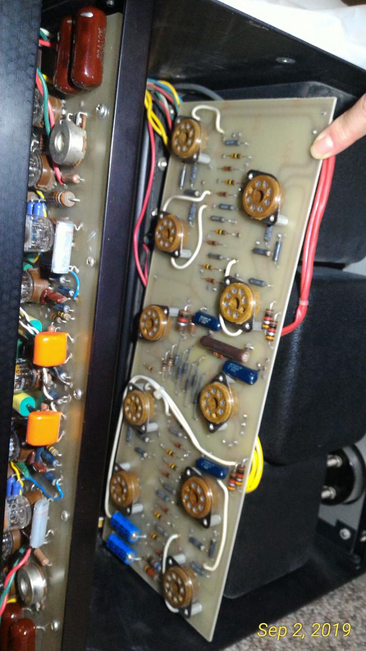

opened up the amp and got the pcb in the middle exposed. measured everything. 10 Ohm/3W dale resistors by V19 and V15 were done in. Will order replacements this week. The bias pots seem to check out too, phew. The screen regulator tubes are in the mail 😉. So hopefully in a week I can get the amp back in shape
p.s. re: balanced input : I see now the symmetry R7/R8 so I got your point re: keeping R7 in the circuit. Will have to check the board layout and how best to do that. Thx.

You want the input grids to always have a ground reference, whether or not there is an input connected.
That's what the two 470k resistors do. The pcbs are very delicate, use extreme caution when desoldering.
Check all the rest of the resistors on the board while you can, because it's easy to do right now.
Also clean the pots with good contact cleaner now.
