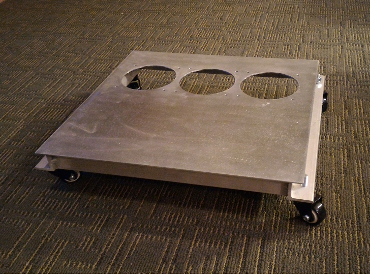

and this is how I will be moving it around 😀
You have brakes on those wheels?
no brakes. I will probably wedge a wheel if it moves on making connections.

And I thought the amp I was building was going to be heavy. Holy crap, 150 pounds? Hope you don't have to carry it up any stairs.

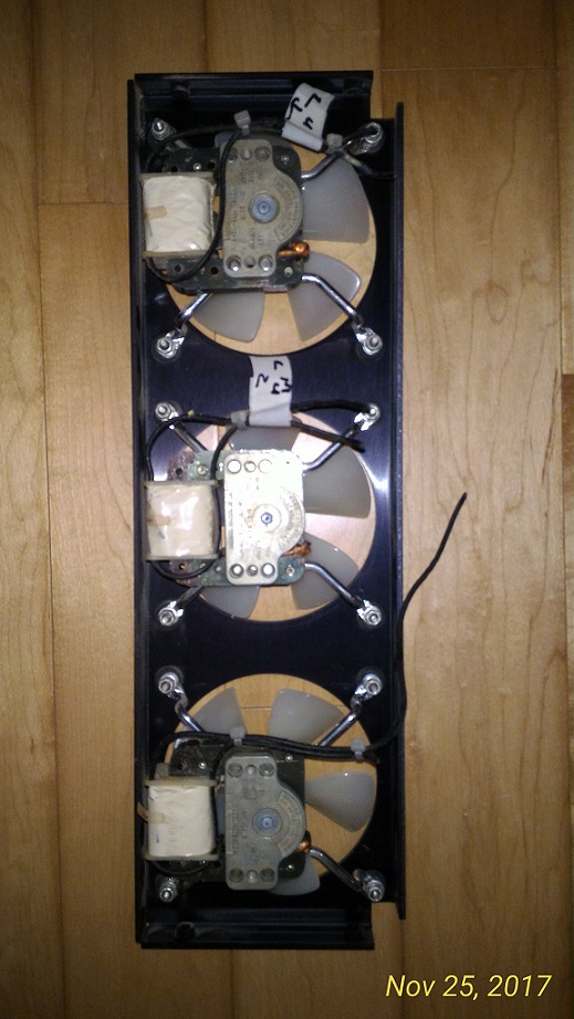

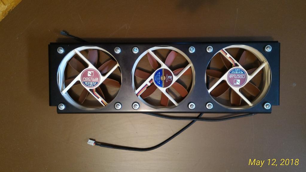

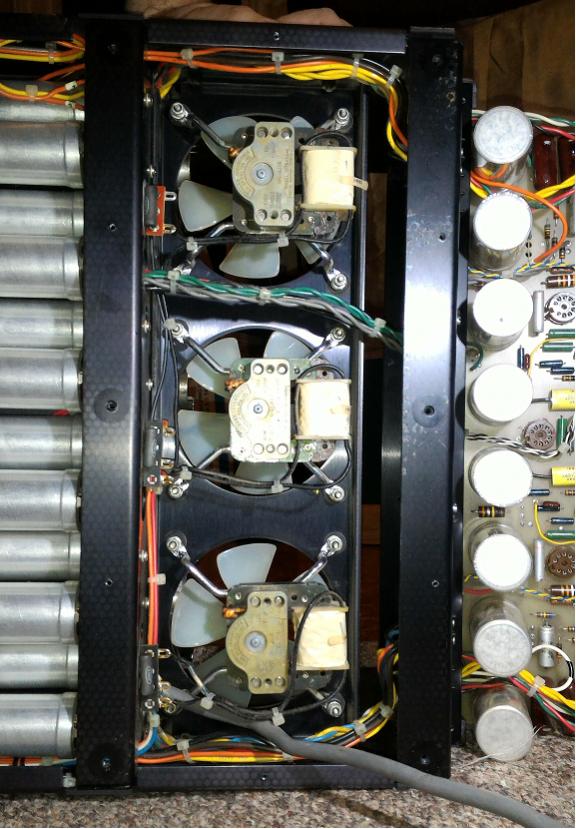

original fans are known to be noisy so they will be replaced with a modern quiet alternative. they are grid voltage driven and there is no data available (that I could find) on their air flow performance.
3 12v 4 to 5 inch fans should do the job. run them from the heater ( 6.3v) winding with rectifier and 1000uf / 25v cap. rectified voltage should be around 10v so the fans will be quieter.
I have been using Noctua fans successfully in my FirstWatt clones; class A, run hot
, so that choice has been made already. Thanks.

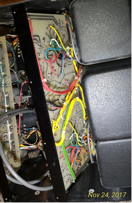

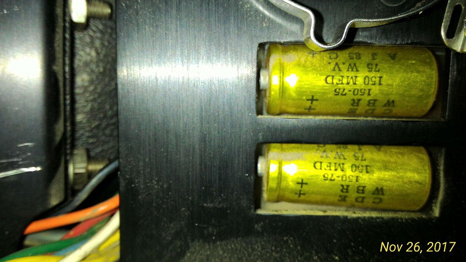

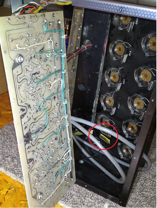

here is the detail that shows how crazy the package is in this amp. they have cut outs for two caps in an 1/8 inch steel plate . for those who wanted more pics I also show the back of the same plate, i.e. wiring under the tube pcb.
I remember a guy complaining online how much ARC charged him for refurbishing electrolytics. Well I could tell him that they probably did not make anything on the work, especially if they did all the pieces.

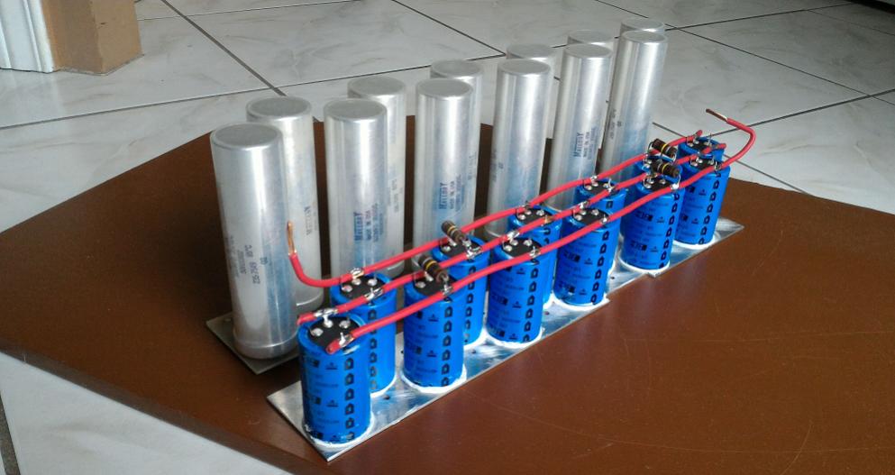

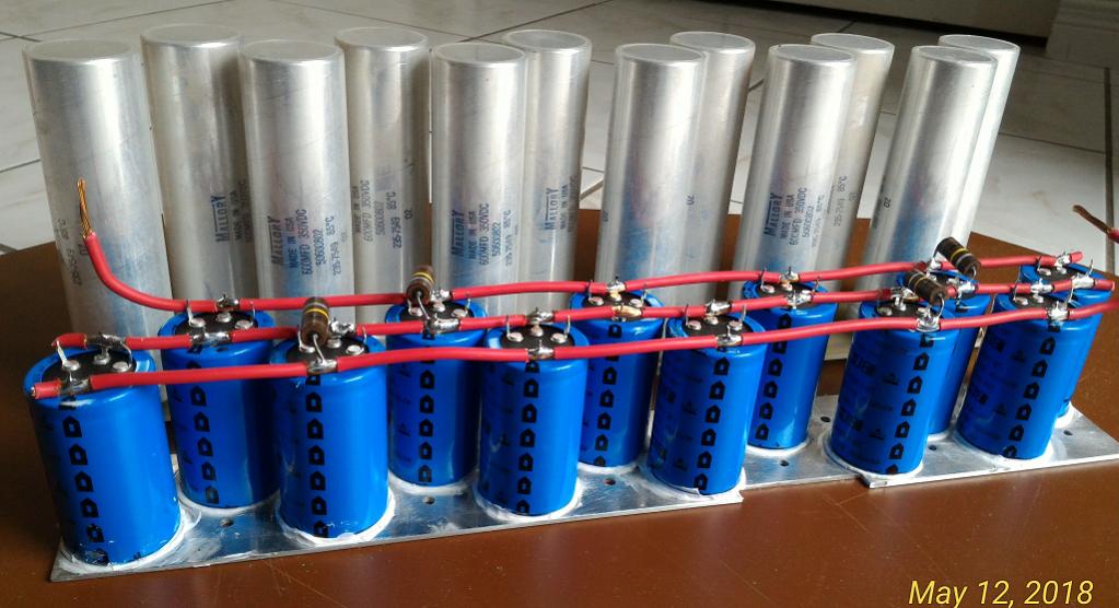

the bank of toll PS capacitors is being replaced with modern caps. It was not possible to find caps with the exact same footprint. The best I could do was to match the distance between the + and - pin but there was no way to match the two dummies used for the added mechanical support. So instead of desoldering the original caps I decided to save the original board intact and substitute an aluminum board for it on which I siliconed new caps upside down and used gage12 wire as a busbar. Imagine for the bleeder caps I found the same as the original ones from the mid 70's ("made in Canada") 😉. a friend had them in his old stock.
meant the bleeder resistors!..but you get the typo.. probably should not have been posting past midnight 🙄
no brakes. .....
just use loooong screws , through the amp and platform
