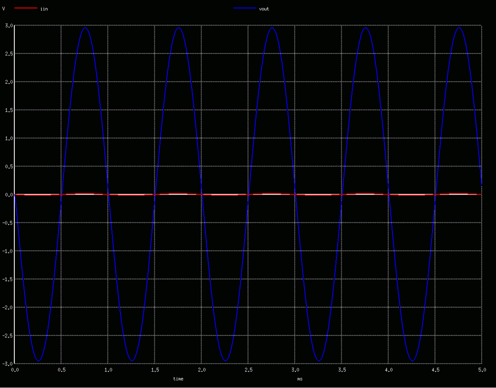

I will try to do some simulations soon, because I plan to use ad1955 which outputs +/- 4mA.
You might be able to change the 1.5k and 3.3k resistor to give you a different gain or perhaps you could just piggyback the irf610 with another. At least that is some of the things I guess could change the gain.
Thnx for the sim. Christian

I just tried R3 @ 3K and leaving R2 @ 3.3K - now I have the gain, and much more detail and air, but still some sort of "gentle" distortion, especially on transients..... Is it important that R2 is also doubled compared to the original schematic ?

The 6.6k is quite important - otherwise you'll only hear clipping. You could solder two 3.3k in series.
cviller said:The 6.6k is quite important - otherwise you'll only hear clipping. You could solder two 3.3k in series.
You were so rigth !!!
Two 3.3K's went in series with the existing ones, and the distortion on transients went out, and along came a large soundstage, and a bass attack that is the best I have ever heard in my system.....

You might need to adjust other things if you turn up the rails... perhaps it will be easier to give the other 610 (Q3 in my schematic) the full +/- 30 V range - right now it is connected from +30 to ground through a 1.5k resistor. And Q3 is the one responsible for the clipping when the drain of Q4 goes below ~4 V it shuts off.
