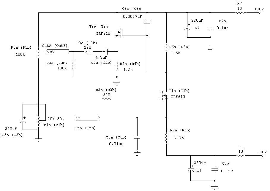

D1 Problem.....
Finished a D1 I/V stage made on lab board a couple of days ago, and i find that I cannot adjust the source voltage sufficient using the 20K trimpot - the channels starts out around -3.3 volts, and I can adjust them to -835mV and -1015mV - and here they are stable to around +/- 1 or 2milivolts - that should be okay ? apart from beeing to much 🙁
Can it be an error ? how do I check the correct function of the I/V converter ? sending audio through it ? Should I use another value for trimpot ??
Cheers !

Do you have a schematics of your board? Have you made any changes to the one in the service manual?
Any chance that you have connected the pot to V- instead of gnd?
20k should work - at least it did for me.
Buhl said:Can I check it sending an ordinary line level signal through it and on to an poweramp ?
I don't think that will be wise. The circuit needs a current input in the 4mA range, I guess that a line level would sound horrible and it doesn't really test if your configuration works. You could end up burning your speakers.
You could try to lower the value of R5. I used a 47k when I had to set the input to 2.5V. If you still cannot get it to 0V, my best guess is that something is wired incorrectly or you might have some wrong resistor values. What are your rail voltages and on both sides of R1 and R7?

Hej Cviller !
All resistor values are as in the schematic, and my rail voltages are +/-29 volts. I will try 47K@R5 ! (and run the circuit over for errors again....)

Just a quick one before I power up -It may sound silly, but should the gound plane on the dac board not be connected to the ground on my D1 I/V board ?? and shold a resistor be placed between the two grounds ??
Cheers !
Hans - who is only a wire from sweet sounds....hopefully ;-)
