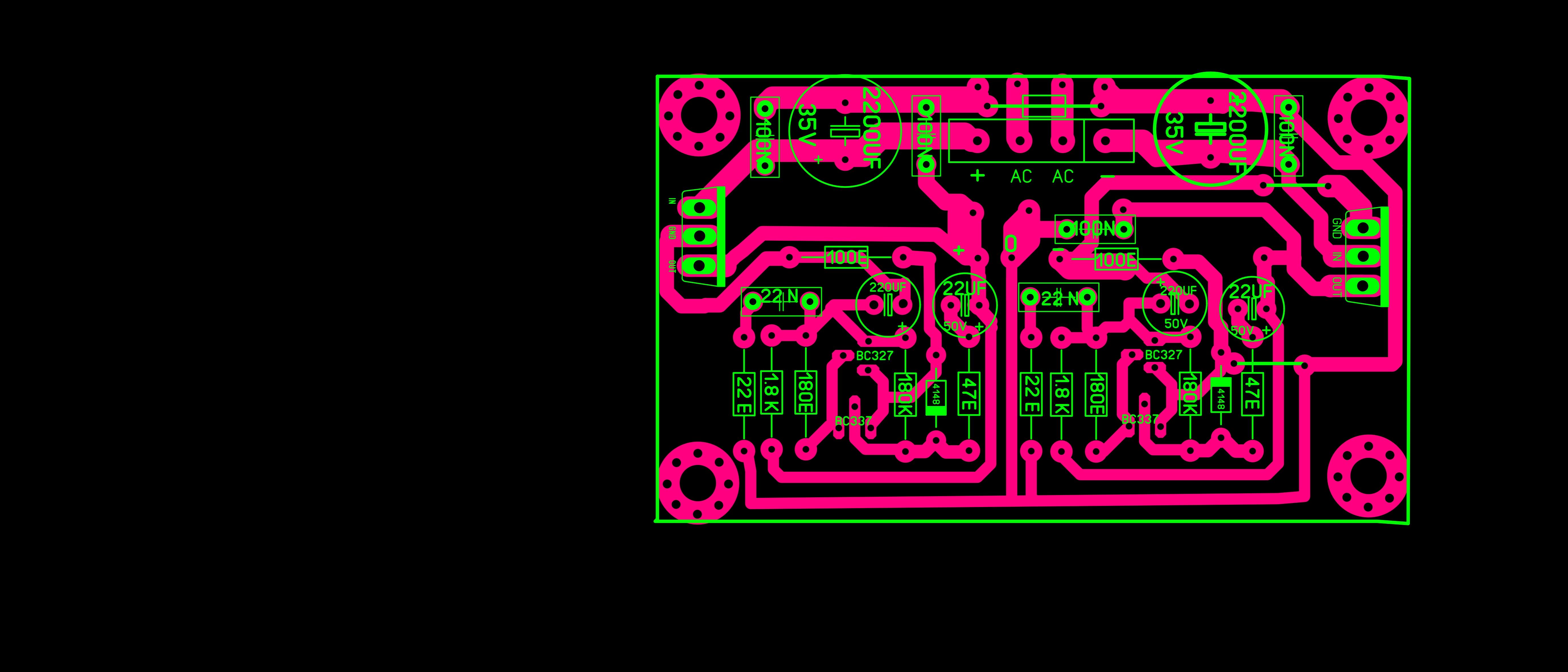

greetings i want to make this pcb please can you tell
the 2 trs used as i could not open the schematic
warm regards
Andrew
Here's the schematic and layout (C1/C4 are on the backside along with the jumpers):

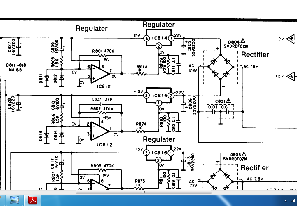

for 78xx, 79xx you can use Technics denoiser:
You will need a very good (and expensive) opamp to match the noise performance of a humble BC337 or even a S9013.
The 1.5K input resistor alone will generate 20 to 30 times the noise of a transistor.
The advantage of an opamp is that the 100Hz gain can be pushed to arbitrarily high levels, to reject the ripple.
Other characteristics will be mediocre.

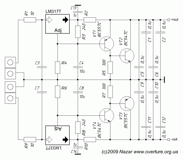

Elvee,
I remember that Nazar_lv was introduced this circuit as "Capacitorless regulator" but it didn't take too much attention. Probably he was referring to same AC principles as your Denoiser which makes no need for big electrolytic filter capacitors. What do you think?
If I remember correctly, he used this dual rail design on his commercial projects too. Which means it has no stability issues with 2 transistor design on negative rail, right?
S-Audio.Systems // Питание High-end апаратуры без применения электролитов
http://s-audio.systems/public/uploads/PSU/capacitorless-630x547.gif
L78xx/79xx are very good at high frequencies by themselves , they are specd at 100khz. So you only need to improve their lower frequency behavior which is what Technics denoiser does as you mentioned.

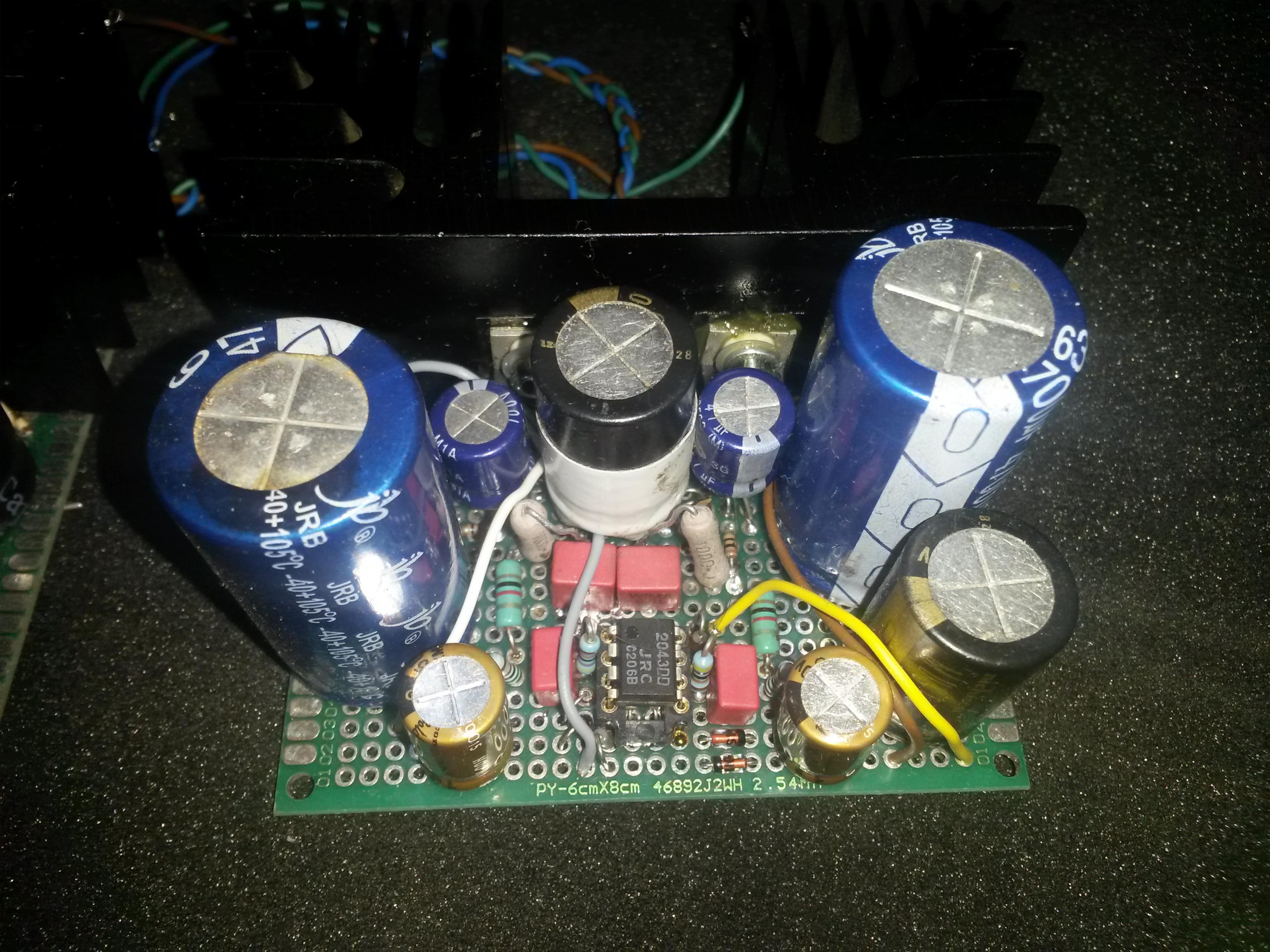

The best advantage of an op-amp is that it supports with minimum space on PCB both regulators when using a dual op-amp. I am using MC7805/7905 with zenner ADJ lifter for higher voltages, as mc7805 is the fastest and lowest noise of the series and here you can see two double regulators +-20v, +-10v regulators and you see much higher capacitors than needed...
Elvee,
They are just "Finesse regulators" by Charles Wenzel. They were mentionned at the start of the thread:
D-Noizator: a magic active noise canceller to retrofit & upgrade any 317-based V.Reg.
They work, but they require uncomfortable tradeoffs like impedance vs. noise reduction.
The denoiser not only maintains the key parameters, but it betters them and the DC capabilities of the initial regulator need not be derated.
The 78/79 might be relatively good at HF, but their noise cannot match a BJT, and the very high theoretical PSRR attained by an opamp denoiser is going to be meaningless if it isn't matched by the LF noise from the opamp and its input resistance.

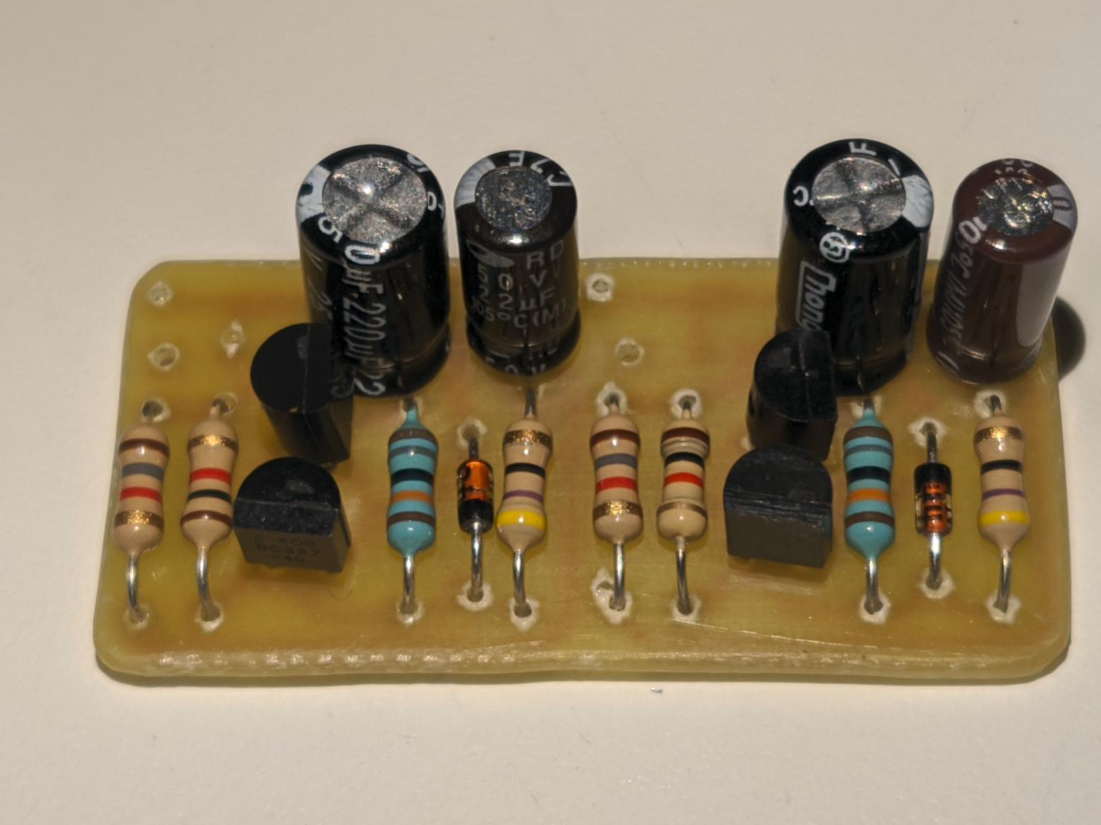

Since I'm almost done with the dienoiser mods in my gear I figured I might test the nonoiser as well. I made a simple tht version that is also diy-able. It's 27mm X 21mm. The inductor is actually the ferrite bead, I didn't have a 3D model for it. You could bypass with a wire and install the bead on the bjt's leg. I attached the Kicad project with pdf for diy and gerbers for fab.
Elvee, if it isn't stable what could be tweaked? I had C/Rcomp for the dienoiser.
This design has not been tested, you make it at your own risk.
