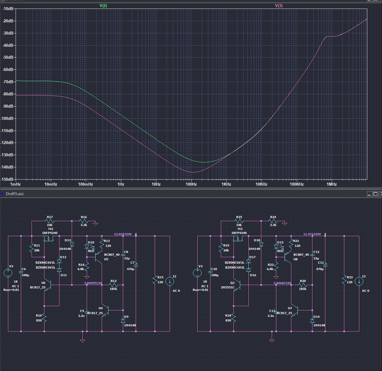

D-Noizator: a magic active noise canceller to retrofit & upgrade any 317-based VReg

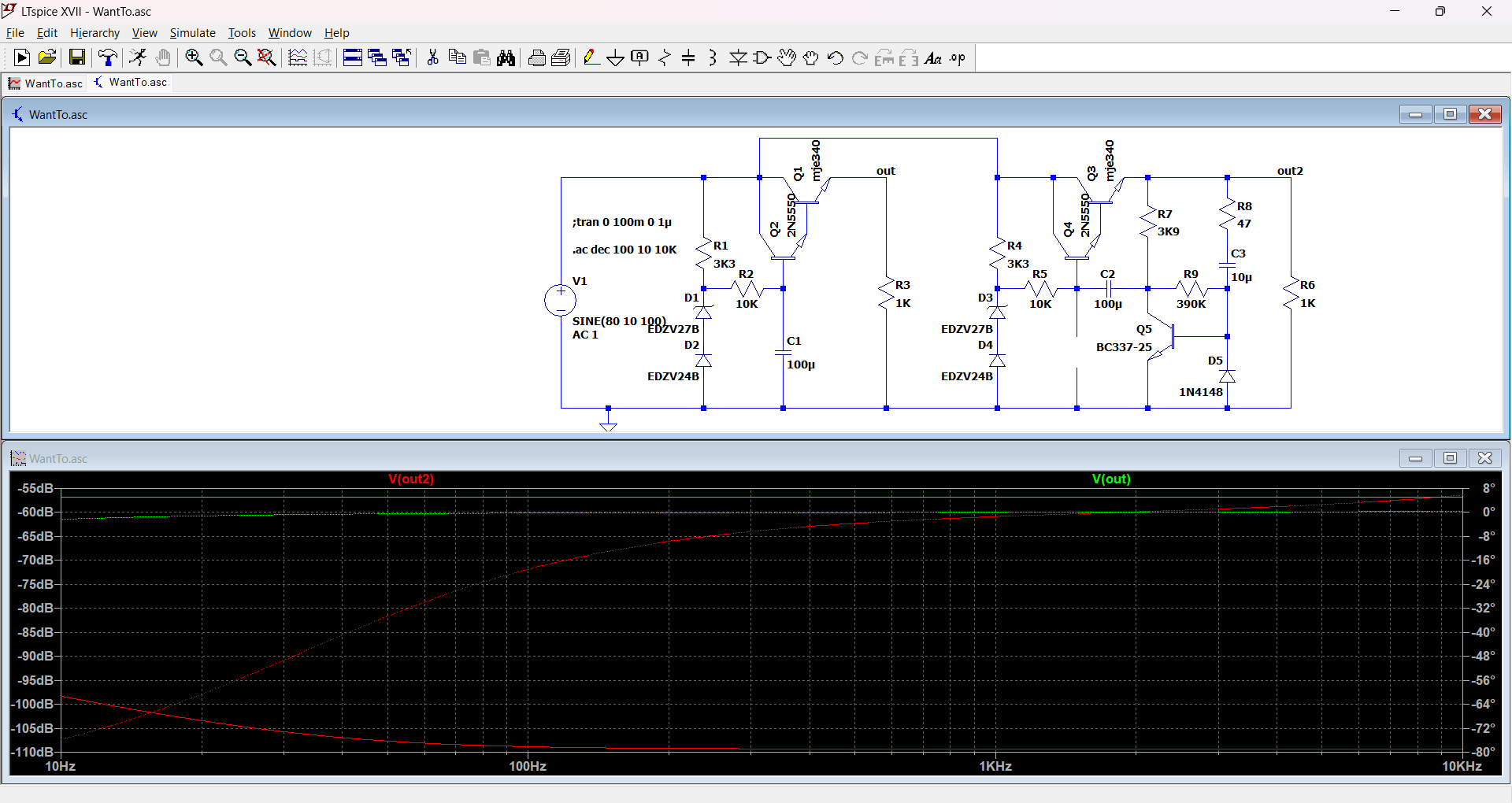

I have made a simulation, and it works as expected:
The red trace is completely flat compared to the green reference.
In the frequency domain, it is even more striking:
The improvement reaches almost 55dB, and with such a simple configuration, stability is guaranteed without any compensation.
The noise should be improved in the same proportions
Reactions: chermann and stv

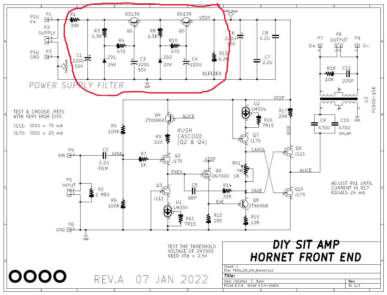

Ship Of Theseus front end cards did similar things; here's the "Hornet" from Jan 2022. If the output current is low (as it is on Hornet), stunts like R1+C1 improve PSRR even more. And "UDP3" (prefilter for Pearl3 phonostages) goes even further by inserting an inductor in series with R1, for an additional -20dB/decade of PSRR.

That is somewhat different: it is cascading whereas Want To..'s idea is synergy, which brings some benefits: a single power device, a single voltage loss, the ability to chose a very low noise correction transistor, to name a few.
Cascading could bring a marginally better PSRR, depending on the Early voltage of the transistors, but optimization of the denoiser values would probably match it

Yes, it certainly is but you have to jettison the excellent static accuracy and stability of the 3xx regulators -which for audio circuits is mostly irrelevant anyway-
BTW, Trileru and myself have proposed no-compromise discrete regulators: the best of both worlds

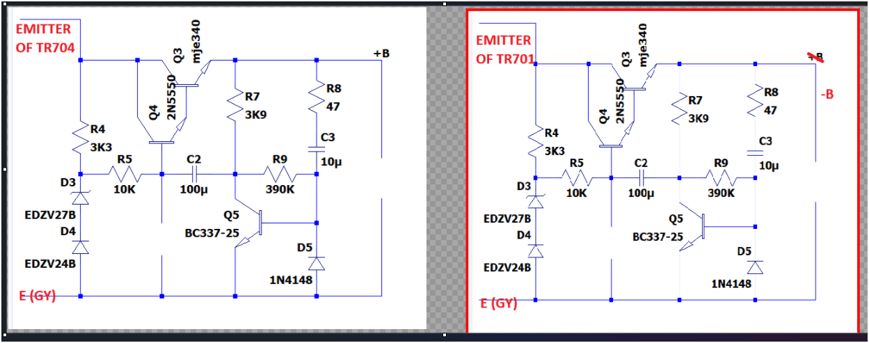

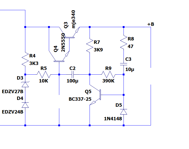

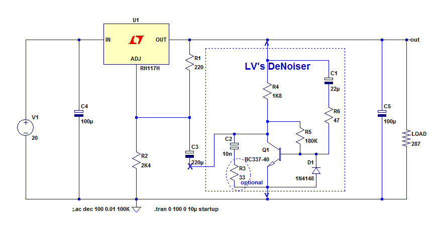

Don't overthink the layout more than necessary.
Start from here:
and connect the two small arrows of the denoiser directly to the load.
There is no need for further complications. Preferably use 10nF for C2, to be on the safe side

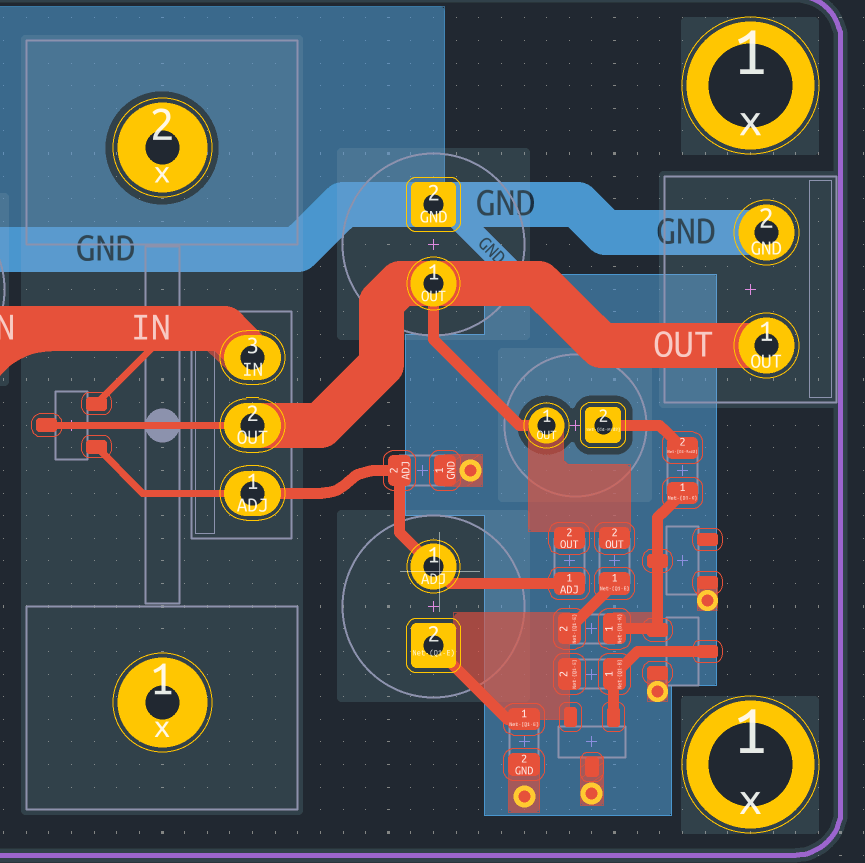

A small ground plane with the entire DeNoiser circuit, and then connect it directly to the output terminal?
Is it better to be the output terminal or the ground terminal of the output capacitor(C5)?
I'm a beginner.
approach with two transistors, a small ground plane and then connect to the capacitor terminal.
is it wrong?
It is preferable to tie the sense connections directly to the output/load.
Ground planes bring no benefit here, since all the circuitry is very low impedance, and does not require electrostatic shielding.
They can be a dangerous thing too, since you have no idea of the actuals paths followed by the currents
I don't see what more I can do: I have drawn the positive side only but the negative side is the mirror image and requires no more explanation.
This is the positive side again, with the B+ label, and I cannot see how to clarify it further:
Simply graft the circuit onto your existing regulator, and it should work as expected
No no: Q3 and Q4 play the role of TR703 and 704, there is no need to duplicate them.
The only addition is Q5 and its associated components. C2 remains the same, but its ground side is lifted and connected to Q5.
I used 2N5550 and MJE340 because they were available in the sim, but the original transistors can be left in place.
For the negative side, you have to use opposite polarity transistors, as in the original circuit, and you have to use a BC327 for Q5 (and swap the polarities of the Ecaps and diode)

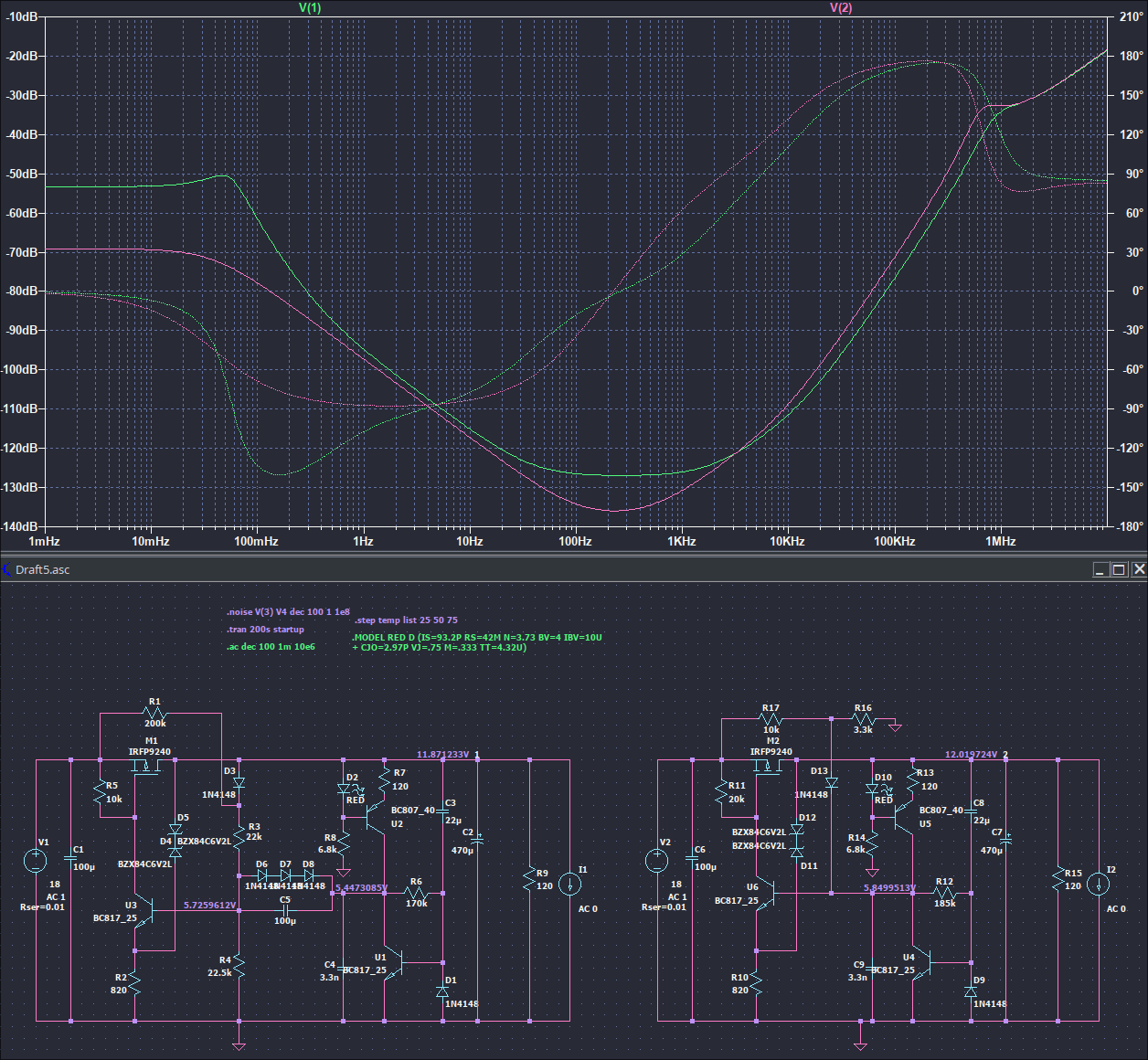

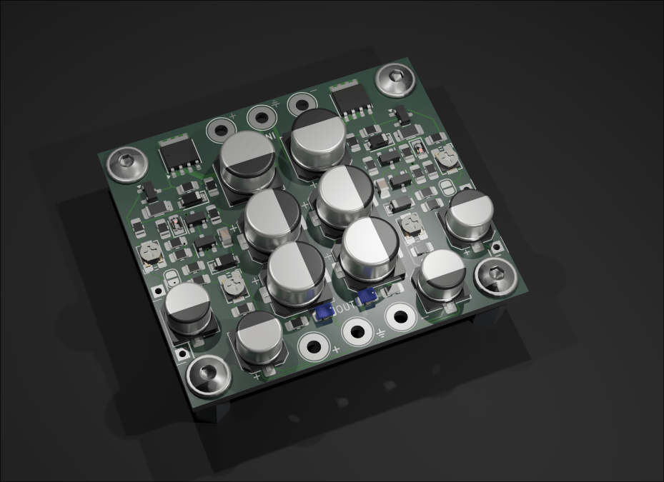

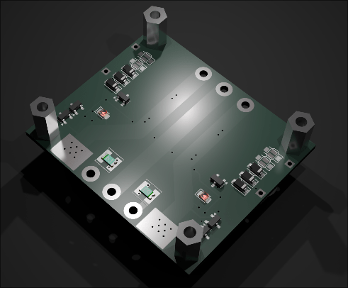

You can have a look at my version for discrete regulator with Elvee's Denoisator (with LED CCS). Should have >120dB of PSRR, and very low noise.
Works with bipolar as pass transistor but has higher output impedance. I might order a similar PCB as previous SMD LM3x7 one.
I attached the sim file though you might need the spice models
  • discrete_denoisator.asc

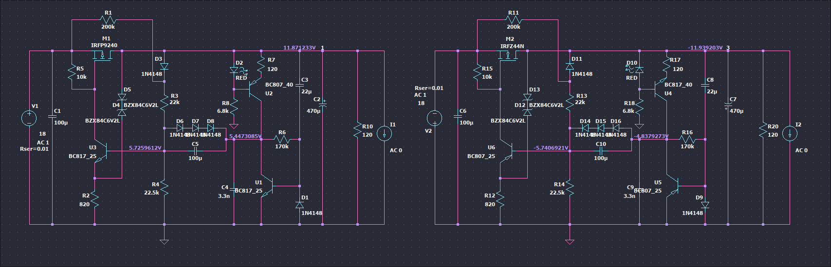

This discrete version could potentially have a DC coupled Denoisator but the startup circuit needs some adjustment. Seems to get some extra PSRR and Vout is set from R12. Less parts, higher performance, no overshoot at startup but tempco gets a hit. Sim shows some 300mV over 50C span so might work fine for some circuits.
edit: I also remembered this version of regulator "likes" 2N5551/2N5401 pair in Q1 position (2nd photo), I think I noticed it in testing as well. Are there SOT-23 versions for this pair? That's a nice boost in PSRR.
