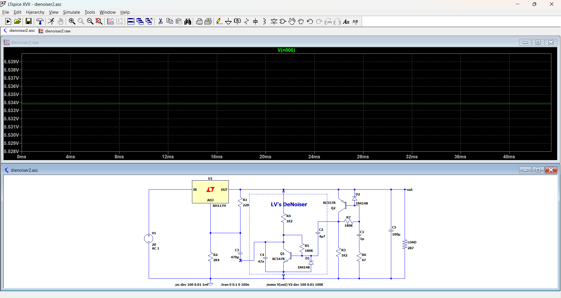

I have tested the two-transistor version.
To make it stable (in sim only, of course), I had to increase the compensation cap to 47nF, and use a very low esr 100µ output cap, but the stability looks very marginal, and the regulator model is more tolerant than its physical counterpart:

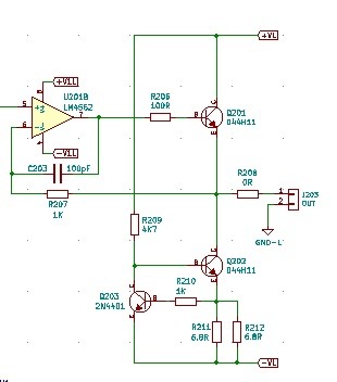

I've been very busy, haven't been able to keep up with the topic as I'd like, so allow me a few questions.
1 - is this the last simulation attempt?
2 - at some point there was concern about stability with the LM337 for the negative rail...
Is there any problem using two boards in series to have symmetry?
As long as the input is from separate transformer windings, I believe it's ok, or i'm forgetting some important detail?
regards.
This is a sim for a "forked" version, but I don't think it has actually been tested.
For tested and proven versions, refer to the index in the first post.
The VRDN project from Mark is an example of two complementary regulators in series, and it works well (mostly). Some 337 of some origins require adjustment of the compensation components values.
The 337, even in isolation has always been more finicky than the 317: ESR of the capacitors, minimum loading current, etc

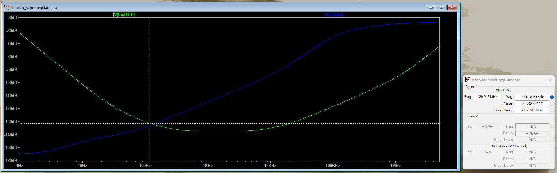

Thanks for your answer.
I replicated the simulation but used TI's model for the LM317, as it seems more honest according to measurements in previous posts.
I plotted the graph together with the Super Regulator by Jung, the fight is good 😊
Super Regulator is so aggressive at subsonic frequencies, can you explain where this is relevant?
Jung's is a true DC regulator from end to end, whereas the denoiser is DC for the 317 section only, with the "super" section AC-coupled.
This makes sense for audio, because there is little to reject below 100/120Hz, but it allows greater performance where it matters most: the audio range.
The LF cutoff can easily be lowered if you fancy it: simply increase the two coupling caps to any value. It will increase the settling time though

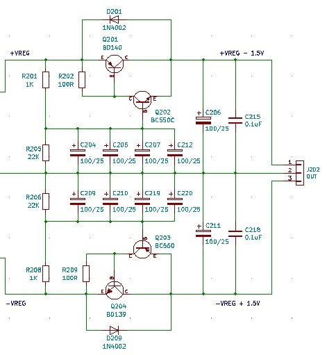

Hello all, late to the party. I would like to experiment with a DeNoiser and/or NoNoiser circuit on an existing build. The build is for a headphone amp.
The power supply I am using is a simple 317/337 followed by a cap multiplier:
I would like to try a DeNoiser or NoNoiser circuit. I like the idea very much because (1) reduced footprint size on PCB, and (2) I think would dissipate less heat. My concern is the the current I am using for the output stage.
The amp's output stage is a TO220 with a current sink set at 200mA. I've experimented with anywhere from 75mA to 200mA, and to my ears there is not much difference between 100ma and 200ma, but 200mA sounds ever so slightly better. I want to preserver that.
My question: would the DeNoiser or NoNoiser shown here here be able to handle 200mA constant current?
Max available current is 1500 milliamperes IF you heatsink the LM317 appropriately. Most designers in this thread either use no capacitance multiplier at all, or else connect the CapMul before the regulator; "upstream" of the regulator. (You've got the regulator upstream of the CapMul).
The denoiser doesn't actually see the output current: the 317 or 337 does all of the heavy lifting.
Regarding dissipation, you will save the drop of the cap-multiplier, not huge.
Note that the denoiser will greatly improve the noise and output impedance compared to your existing configuration, but not the PSRR: a typical cap-mult reduces the ripple by ~60dB, give or take 10dB depending on the early effect in the transistors.
The PSRR supplement afforded by the denoiser is "only" ~30dB, but this is probably a moot point, since the ripple residues will be drowned in noise anyway.
The nonoiser or dienoiser can do better, but they are more demanding regarding compensation and stability aspects, and since a regular denoiser should be more than sufficient in your case, that's what I would recommend.
Another advantage is that it can be easily retrofitted to your existing regulators without too much hassle

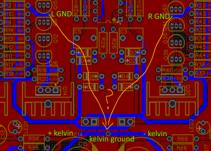

I created a combined version of tombos version but run into a slight issue. The regulator is on the same board as the headphone amp with a ground plane for both. The problem, don't know where to put the kelvin connections ground. Currently its as close as i can put it but i doubt its the most optimal spot.
The sensing lines don't carry current so they can be thin. But most importantly they should run as close as possible to eachother to minimize the loop. In my experience sensing place is irrelevant as long as you have a clean design. In one of my earlier ADC design it didn't seem to matter where I measure the noise on the PCB, it was the same everywhere, and I did the sensing right on the output of the regulator, on the PCB. Running the sensing wires across the board might make problems worse not better.
