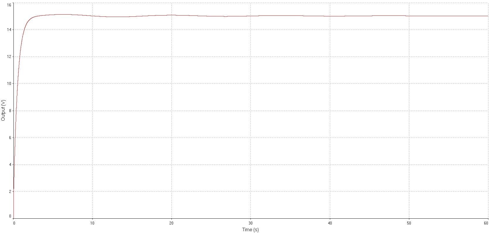

Taking inspiration from mark Johnson's project, i created 3 denoisers to feed a TDA1541A DAC, and the results are good (in terms of listening), the tension at the start is quite constant, even if I still have some doubts about the exit post and the relative ESR.
Not having an oscilloscope I can't understand if the regulators oscillate.

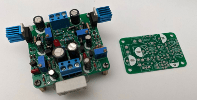

I received the new boards, assembled the dual version one and I finished my ADC+LNA gear, so I'll start testing these days.Any news about updated boards and tests?

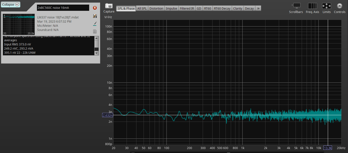

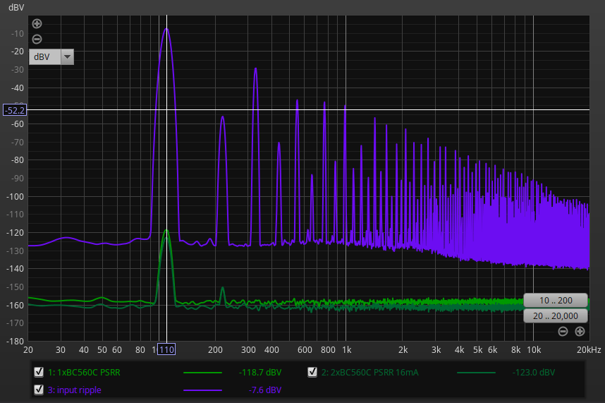

I got to measure different BJTs and there doesn't seem to be much difference for CCS Denoisator. ZTX sat at 3.9nV/sqrtHz level (or 560nV in audio band) and BC560C at 4.6nV/sqrtHz level (660nV in audio band).
What did work nice was using two BJTs in parallel. It does lower the noise by a good bit, and also adds about 6dB of extra PSRR. For Denoisator this is quite a good option.
For NoNoiser the S8550 worked pretty good, noise was similar to BC3x7. For Denoisator the difference between various BJTs was not so great. Using two of them in parallel makes for a lower noise than using say one ZTX.
Also the IR LED from an optocoupler works just as good as a "normal" IR LED.
The extra PSRR seems to work out about 4dB in my case.

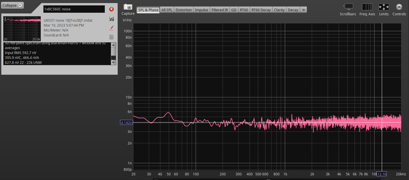

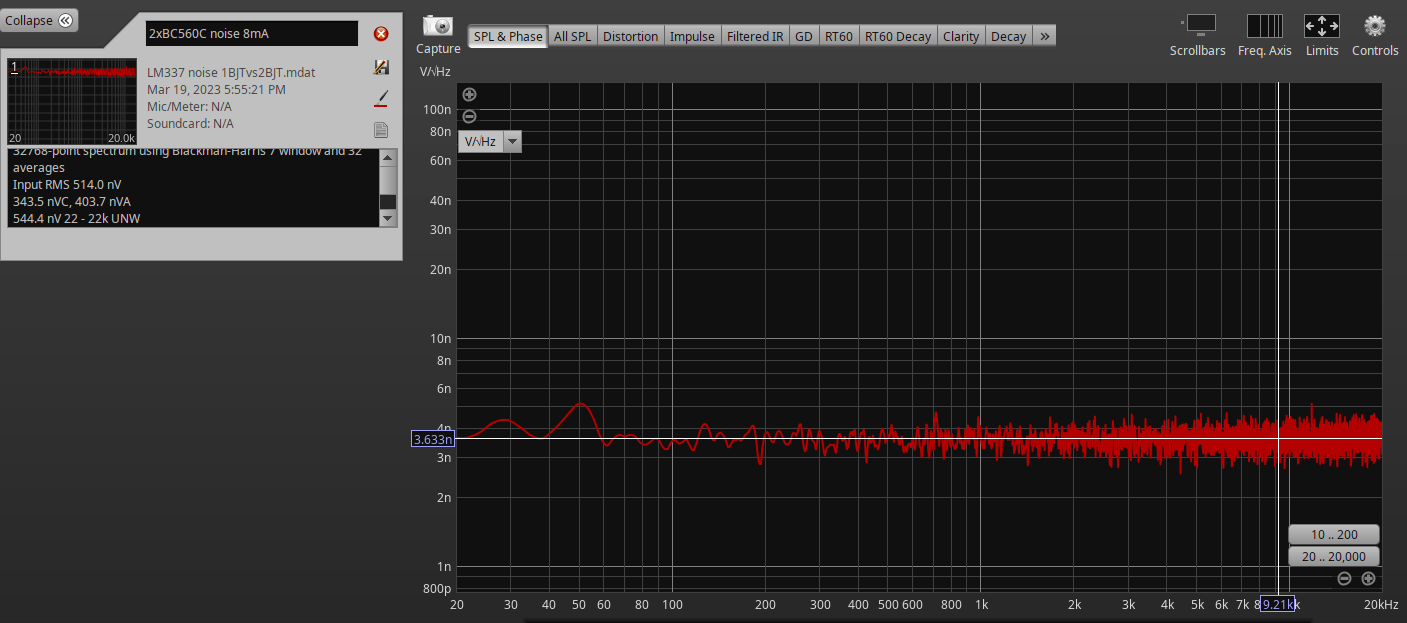

Noise seems to work out at a bit less than half. Indeed it halves between two BJTs in parallel at 8mA total and 16mA total. Just adding the second one for the same 8mA total does seem to lower the noisefloor a bit. If I double the current the noise then halves. Overall I got less than half of noise when adding the second BJT, and doubling the current.
The attached measurements are for LM337 in CCS Denoisator configuration, first one is the noise for a single BC560C as denoiser BJT, 8mA total. Second one two BC560C in parallel at same 8mA total current, third one 2xBC560C with 16mA, and last photo is the PSRR with 110Hz signal.
On the noise measurements total noise in audio spectrum is mentioned on the left side part of the measurement.

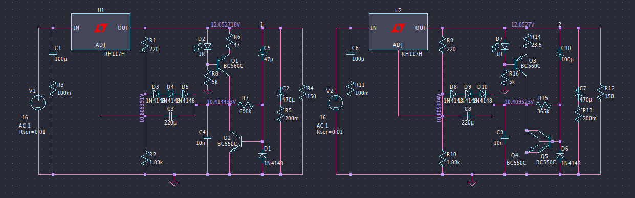

Can you explain the adjustments you have to make on the CCS Denoiser's resistors for each different transistor?
Do you parallel in both transitors?
How do you adjust the current to improve psrr? With the voltage setting resistors, using lower value combos?
I used the values from this schematic:
If you want to use two BJTs in parallel you need to double C5 value because R7 will need to be around half for same Vce of BJTs. This is to keep the same LF corner frequency.
R6 halves as well to double the current through the denoiser circuit.

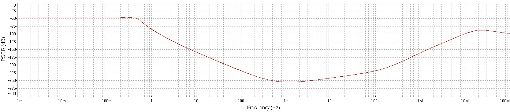

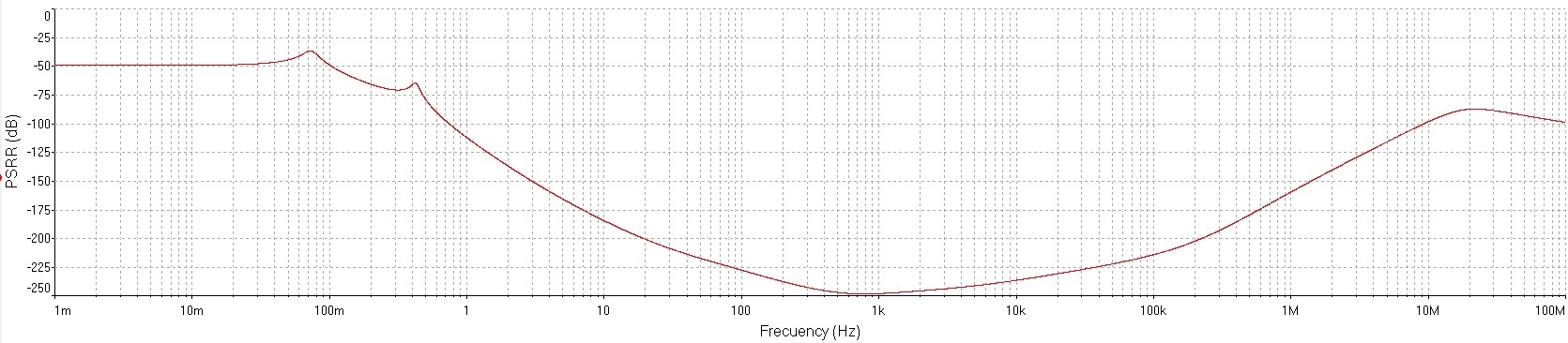

Also a good example to show the difference in simulated PSRR with RH117H model and TI's LM317-N spice model. The latter is closer to actual measurement.
1 and 2 are with RH1117H model and 3 and 4 are with TI's LM317-N spice model.

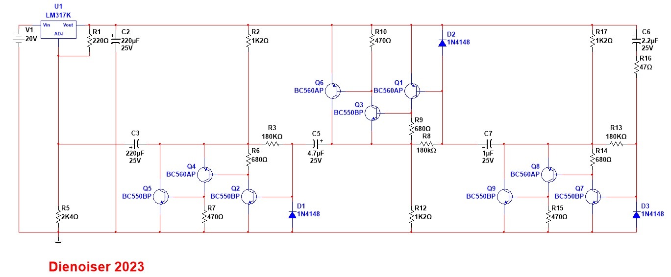

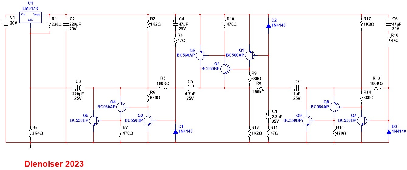

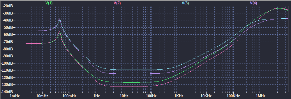

Each stage composed of 3 transistors could be simplified with one like the original denoiser that starts this thread. It is obvious that this new circuit will require adjustments in the values of its coupling capacitors.
Likewise, all variants will have to be put to the test rigorously, despite the surprising numbers of the simulation.

This noise reduction game is completely useless.
Even the connection cables between the output of this module and its load will capture tens-hundred times more noise. And it uses an infinity of pieces. The simple version with 1 transistor is more than enough. Maybe only the slightly more advanced versions with 2-3 transistors.
I agree 100%. I only expose a way to overcome those first limits. Afterwards, everyone will choose how they will achieve what they require for their circuits.
I am convinced that there are circuits that do not even require the original denoiser, since the thresholds of a middle ear would not distinguish it.
Best regards
Best regards
