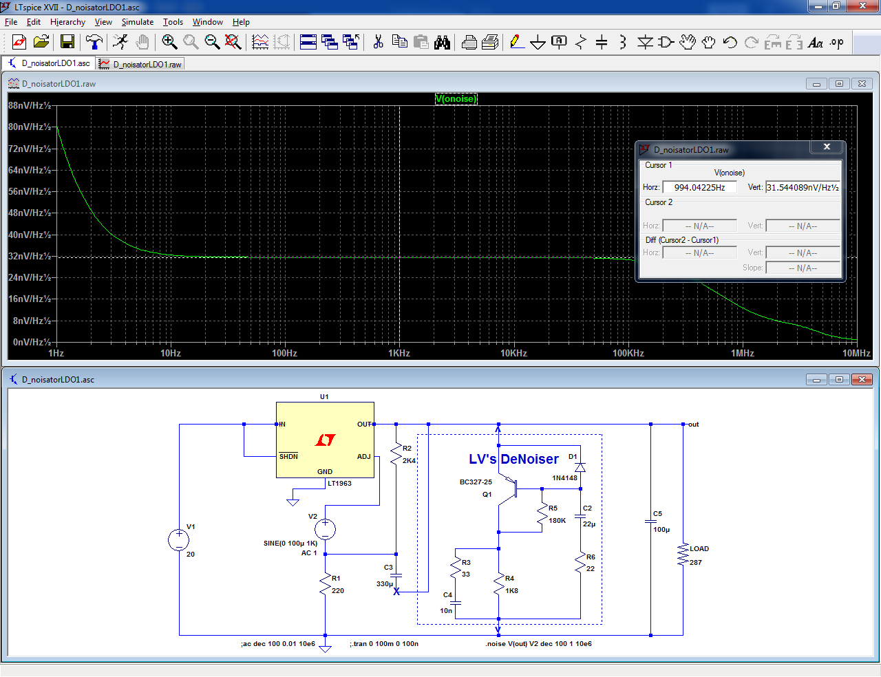

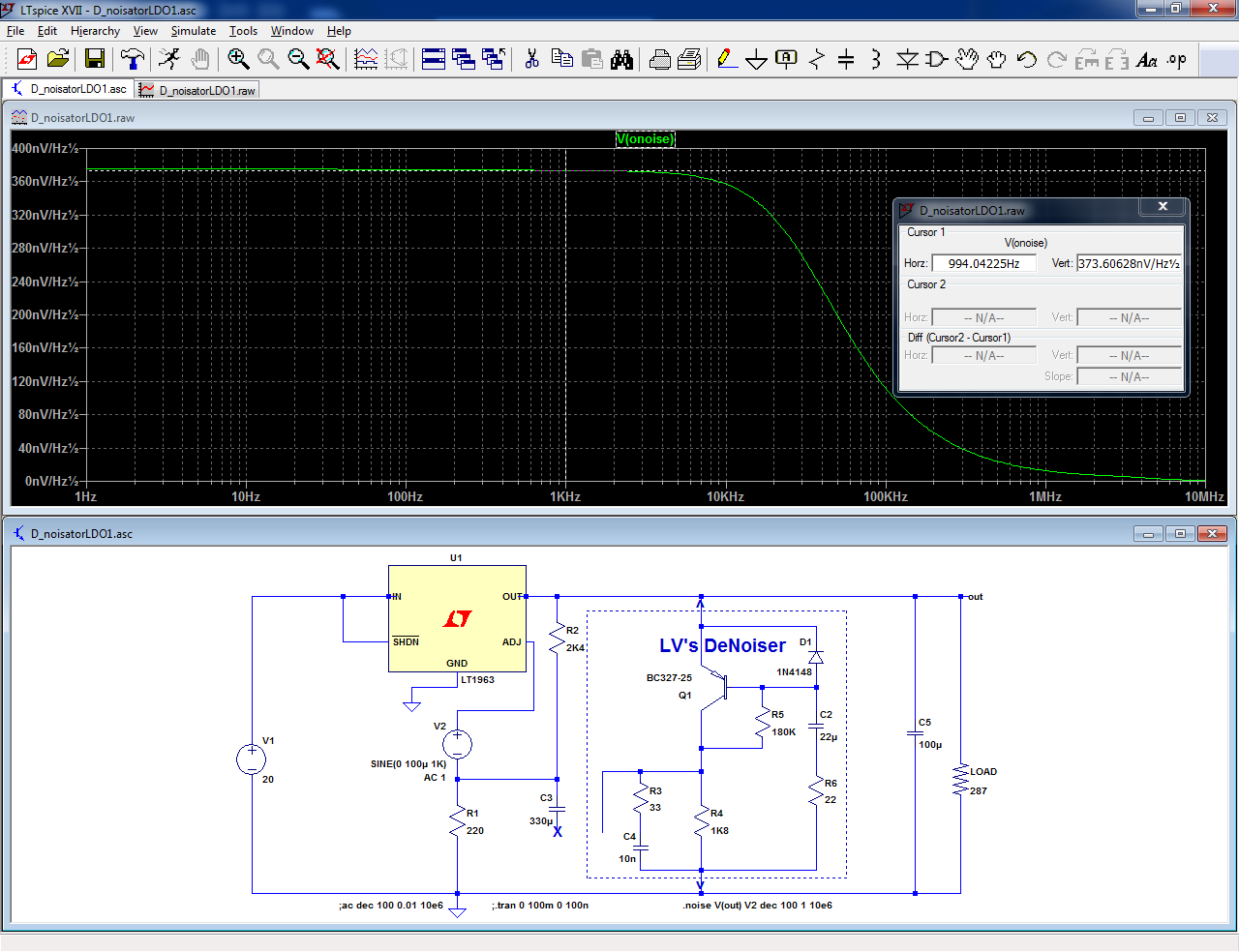

Since the LT1963 has a reliable model, it is possible to simulate the noise performance of all the options.
First, the plain vanilla regulator circuit, with just the two resistors in circuit:
373nV/√Hz
Then, the poor man's denoiser (bypass cap):
31.5nV/√Hz

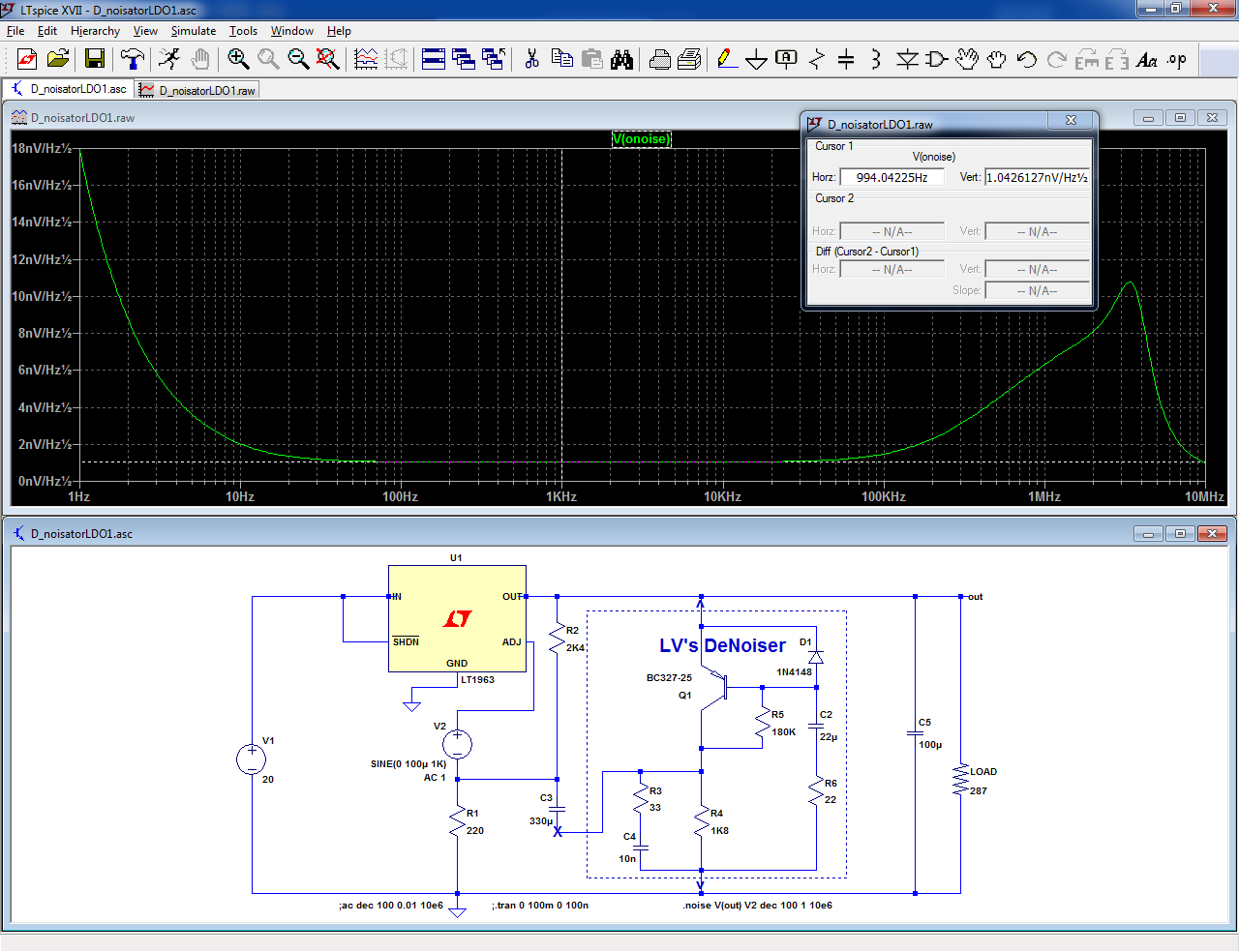

And finally, the complete denoiser in its full, glorious splendor:
1.04nV/√Hz
