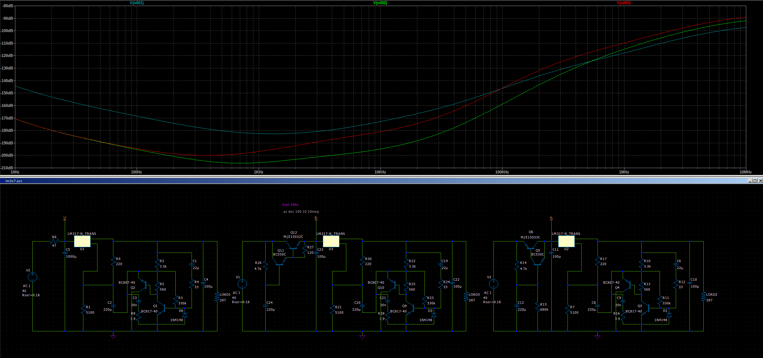

I made a comparison with a simple dienoiser with LM317, measuring CMRR and just changing the input filter.
C, R + C, and CM.
The last two curves seem pretty good to me, so I would go with the R + C.
The only important difference is the slightly higher drop after the input resistor, which was 6V vs 4V on CM.
But I can live with that for that low current supply.
That should be the one I plan to compare with the SuperRegulator on the RIAA preamps. And listen to them.

I think the kind of capacitance multiplier you use matters in this case.
The ones I have on my boards (either Darlington pair either Sziklai pair) would offer around 56dB (at 100Hz) for your simulation conditions.
The Darlington pair has a Vdrop of around 1.42V and would dissipate 0.19W and the Sziklai pair has a Vdrop of around 0.9V and would dissipate around 0.12W.
The RC resistor offers about 30dB PSRR (at 100Hz), has a Vdrop of around 6.6V and dissipates 0.92W.
Also for that output voltage I suggest you change R4 to 3.3k, R5 to 330k, R3 to 560R. Maybe even lower R6 to 33R.
R15 in my schematic should be 560K for best performance at 1A.

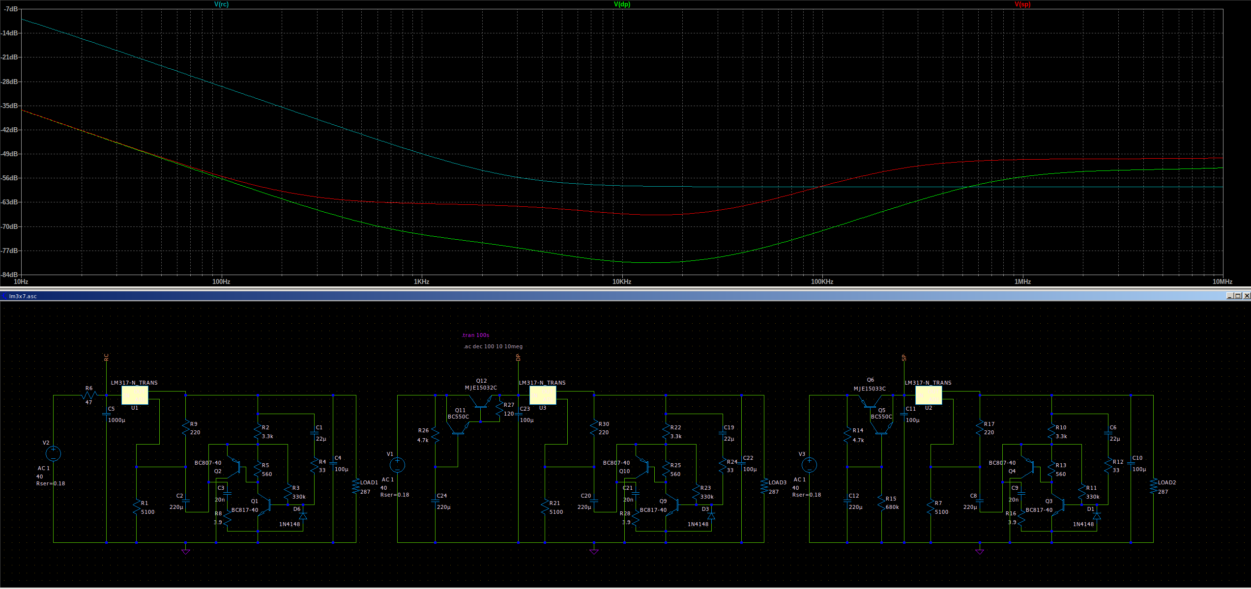

First picture is the PSRR for just the RC/cap multi outputs, and the second picture is the output of the regulator for each case.
edit: if you want the least Vdrop then the Sziklai pair capacitance multiplier seems like the best choice. It has lower Vdrop (0.9V in your case) than a LM317 and about the same PSRR (at 100Hz) as a simple LM317 configuration.
The RC values would also have to change if you increase the output current from 100mA to 1-1.5A.
Say for 1A output for the same circuit, no change to the capacitance multiplier, it still offers the 56dB PSRR at 100Hz, just that now the Darlington pair drops 1.75V and dissipates 1.8W, the Sziklai pair version drops 1.1V and dissipates 1.1W.
To keep the min voltage across the regulator we need to dial down the value for the RC resistor to around 6.8R, it drops almost 7V and dissipates 7W of heat. And in total it offers just 13dB PSRR at 100Hz.
So no change to the capacitance multiplier, maybe a small heatsink on the pass transistor.

Trileru, I just did not understand the high CMRR numbers for your three curves, compared to mine.
Something against CM or Sziklai are that they demand a heatsink, which I would also need on the 317. But current demands of the RIAA preamp is about 15mA on each side, so maybe single aluminum plate for transistors and regulators would do.
They require a heatsink past 500mA or so. They don't need one for 100mA output.
What don't you understand from the graphs I posted compared to yours?
The dB figures on the left, supposedly showing how low they can get in CMRR. Yours go down to 84dB, mine to 190dB.
I mentioned the photo on the left shows only the capacitance multipliers/RC filter performance. The LM317+dienoiser performance is identical for all three versions so it's simpler to look at the difference between the two cap multi and RC filter only.
I mentioned the specs on the right, because I remember Elvee mentioning that anything below -100dB on CMRR was more than enough and probably inaudible.

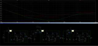

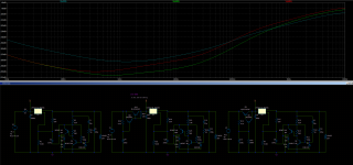

The only difference between both circuits and curves on the left are right is the current you are running on them?
Do you have ASC file for LM317, please? It will be used for tube heating, 12.6V 1.2A.
Regards
What VAC on the secondary (loaded)? What is the resistance of the secondary winding?
What about the series resistor with C4 should stay or go? Perhaps leave the space to use it bypassed and see if it's necessary.
C4 should be between 22nF and 47nF, and I also recommend adding 1R to 3.9R on any implementation for dienioser. With the output capacitors I recommend usually dienoiser works with around 47nF+3.9R.
There's three circuits in that photo.

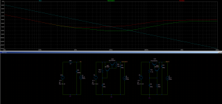

The left most one uses a RC filter on the input, the middle one a Darlington pair capacitance multiplier, and the one on the right uses a Sziklai pair capacitance multiplier. Same input/output voltages for all, same current.
I made another sim with just the RC filter and capacitance multiplier versions so it's less confusing. Each one's PSRR is added to the one from the LM3x7+dienoiser when you measure the PSRR on the output of LM3x7.
