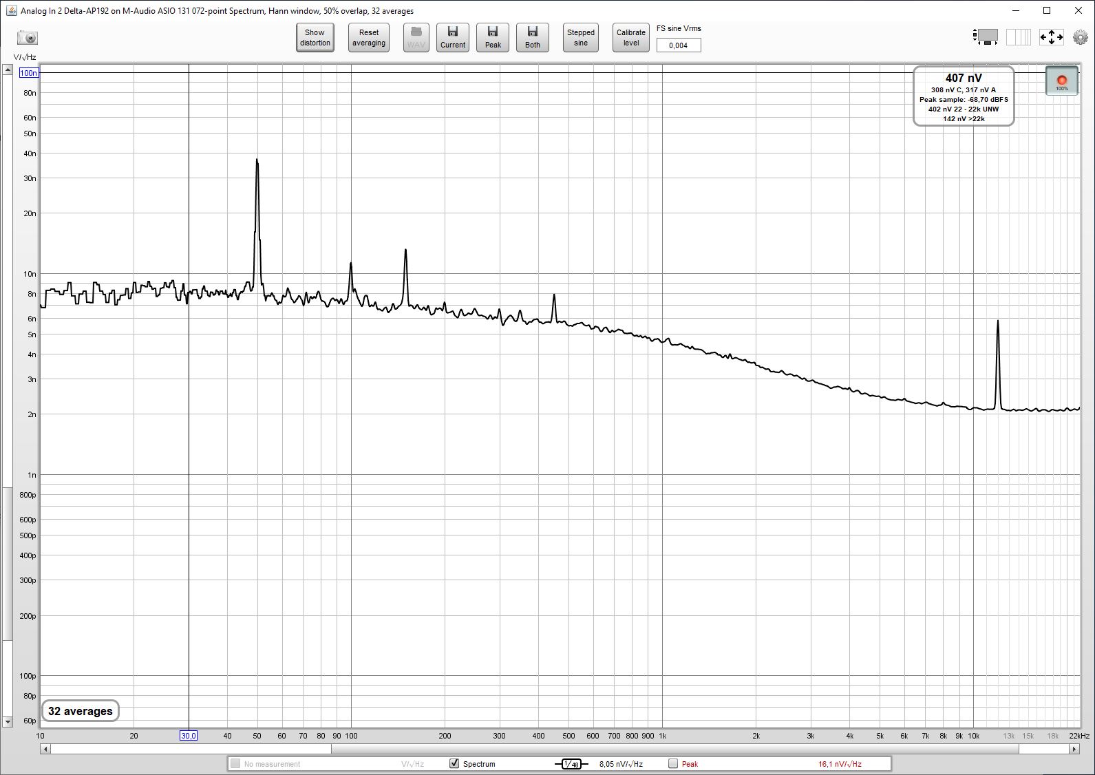

The noise floor seen on those measurements does not relate to actual noise. You can find real world measurements of denoiser here. Although I have measured slightly lower noise with denoiser (see attachment).
Yes I agree that my measurements are not to be taken as valid for absolute values. They are used as an indication, I make measurements on the dB scale to check for PSRR.
The denoiser offers the advertised -30dB reduction in noise (vs Cadj) at the point of sensing, where I always measure with the LNA. From my experience, the denoiser always offers this reduction in noise when the circuit is working. What suffers due to improper layout is PSRR. That depends on grounding and other interactions in the circuit.
If the noise reduction is there but PSRR is not reduced the same, that is a signal of improper grounding/layout. If the noise is not reduced then the circuit is not stable/working fine. These are two different aspects.

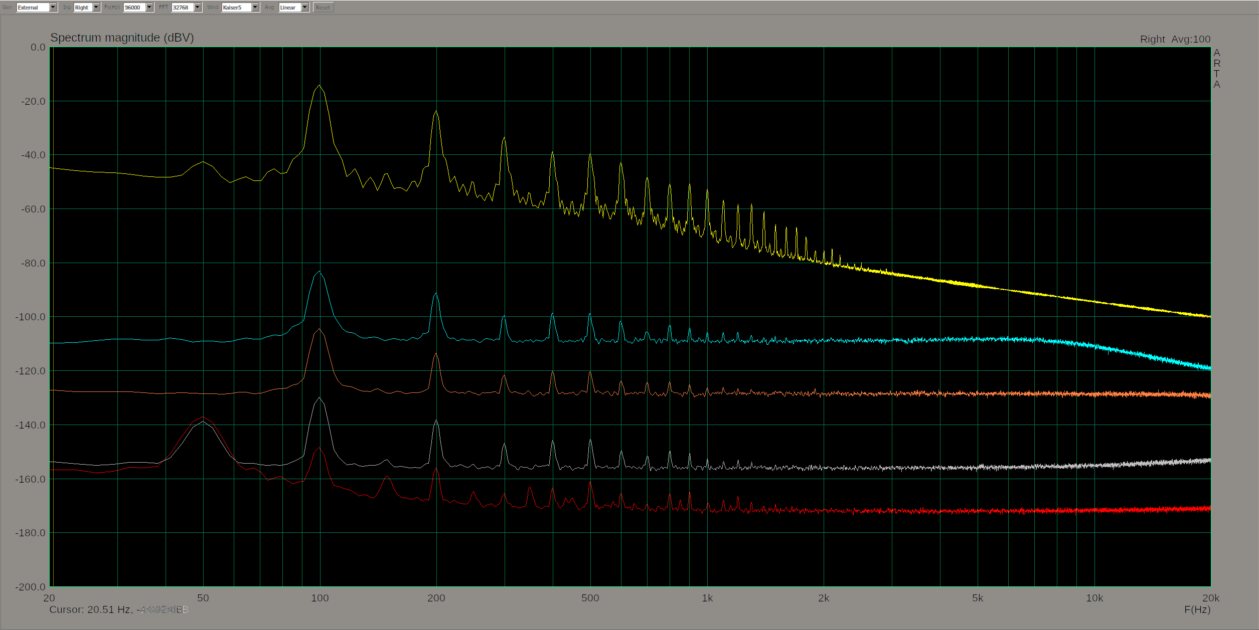

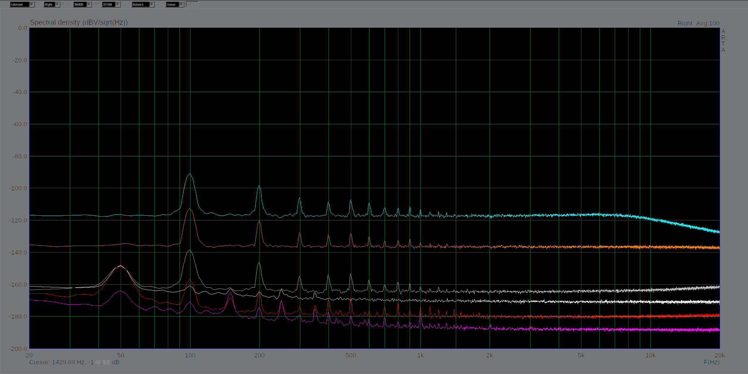

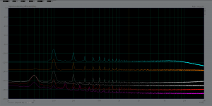

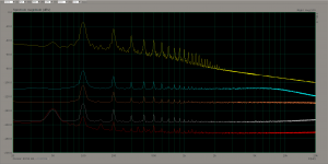

I want to mention here as well that while doing most if not all measurements I had the 0dB point set in ARTA at 3672mV. Somehow I got 1.3Vrms and 1.3Vpp mixed up. Measurements might make more sense this way.
I also measured a 1k resistor, I then measured the input of the LNA shorted to ground, and the difference was around 16.4dB to 16.8dB. That would roughly translate to around 0.6nV/√Hz. I don't really care if it's 0.4nV/√Hz or 1.2nV/√Hz, it's lower than what I'm measuring and I don't see the interest in doing a more precise measurement for this value. The LTSpice sim showed around 0.4nV/√Hz for noise sim for the LNA circuit with the parts and values I used. Its power supply has LM3x7+dienoiser, with an input CRC filter.
I made another set of measurements for the LM337 with the v1.4 board. I didn't use the capacitance multiplier.
I set my 0dB point correctly at 1300mV in ARTA. I made a zip file with each measurement with the value of interest, I only attached two photos to this post, in which I overlay all measurements for PSRR and noise.

I made a zip file with each individual measurement with the value of the signal of interest. The files with the N_ prefix are of the dBV/√Hz measurements. I attached here just two photos so to not be cluttered, and I overlayed all measurements in each.
The first photo is of PSRR measurement. I set the scale to dBV this time, I also added the 1000x gain, I used 1x gain for the input ripple measurement, I connected the ADC directly to the filter cap through a 47uF cap.
The traces in the photo are as follows from top down:
- yellow trace - input ripple
- cyan trace - normal LM337
- orange trace - LM337+Cadj
- grey trace - LM337 + denoiser
- red trace - LM337 + dienoiser
Second photo is in dBV/√Hz and traces are as follows from top down:
- grey trace - LM337+denoiser
- white trace - 1k resistor
- magenta trace - LNA input grounded.
I hope this set of measurements better represents the performance of the LM3x7 + de/dienoiser on the latest versions of the single boards. Since in my previous measurement the LM317 measured almost identically with LM337, even with the wrongly calibrated values, I presume these measurements are also an indicative of what to expect using the LM317 with the V1.4/V1.5 boards. I might as some point repeat this set of measurements for the LM317 as well.
I used LM337N from TI here.
