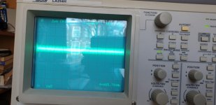

This is the test fixture I have been doing measurements on. There is a positive and a negative side. In both, by adjusting jumpers, the denoizer can be switched on or off, or the 220 uF cap over R14 can be switched to ground or be lifted. After the denoizers, I built a roughly 1000x times amp from an LME49990. Noise levels of even a bare LM117 are too low to be shown direcly on a scope or be measured with a volt meter (at least, the ones I have).
For those who want to do some sims to find out where I might have gone wrong, here is the spice file. I would love to have a model for the LM337, but the one I found on the net doesn't seem to work. As long as I don't think it sims properly anyway, that point is moot.
With the denoizer on, the noise climbs to .12 uV, but it must be even lower in a well shielded setup. I can see the sort of variations in the noise voltages, .12 was the maximum. And it reacts to presence of a hand or finger like a Theramin, it is very sensitive to EMI. In short, shielding will be important to get the best results.
I am building a sweepable powersource, in which I can superimpose dirt on top of the DC voltage. Let's see how we fare with PSRR. I will also do some stability tests and will try to sweep Zout. But first we have to solder on.
Edit: for good order, I am using BC549/560C low noise transistors, since that is what I had laying around.
