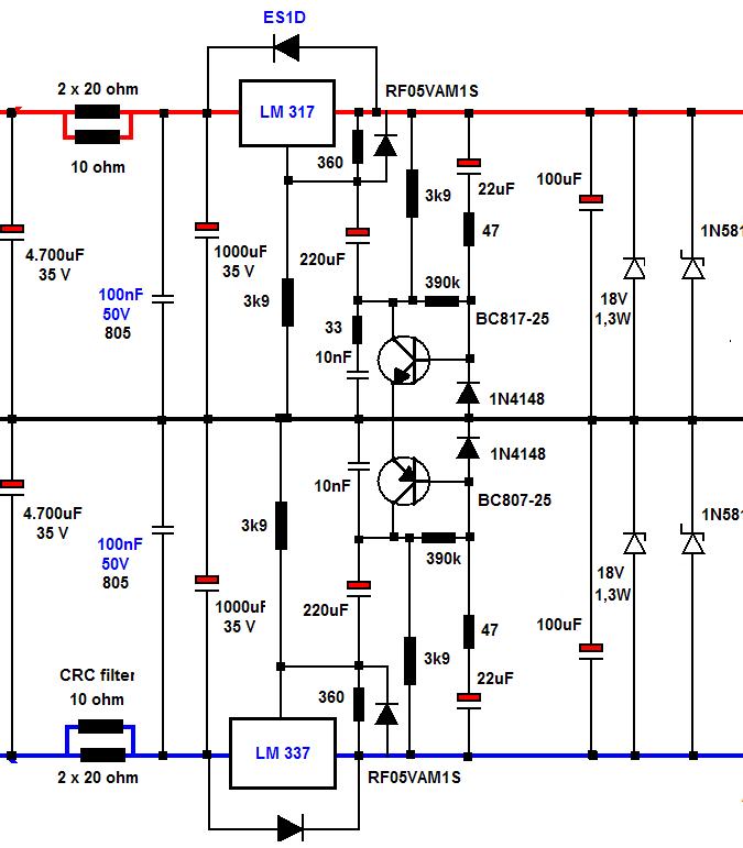

Elvee can you confirm schematic is ok, especially for the negative regulator?
It is correct

I see your Nonoiser schematic has BC557 as PNP. Is BC327/BC807 a good alternative?
I finished the LNA and was testing the supplies. Positive side seems stable with the dienoiser and denoiser. Negative is stable with only denoiser atm. Dienoiser is acting up. I had to increase the comp cap to 40nF and coupling cap decreased from 470uF to 220uF and it seems stable but sits at around 13.7V instead of 15V. Shorting the NPN for denoiser version makes it stable at around 15.2V or so.
Diego, did you make a lm337 test with the dienoiser?
Will test some more, also gonna replace the bjts as I had them wrongly installed at first. Took them out, tested them then installed correctly. Maybe there's something wrong with them.
After some tinkering I managed to get it stable, but it needs the series resistor with the comp cap. I tried with 33R in series with 10nF and it was stable but at around 13.5V or so. Then I paralleled the 33R with another one for 16.5R and it went unstable. Then I added another 10nF still unstable, then another 10nF and it's stable at -15.02V. So around 30nF with 16.5R. 10R wasn't stable.
So I need to revise the dual designs to add a series footprint for this resistor. Or you could tombstone the cap and resistor on the same footprint.
Will test some more. Anyone else got a stable lm337 in dienoiser config?
Another curious finding. I was injecting DC at the input of the regulator. When I used the AC supply it went unstable again. Then I noticed that I used a higher input voltage from by bench power supply.
So, for -15V out, it seems that the input voltage has to be minimum -20.9V. At -20.8V it isn't stable. That's almost 6V minimum drop. What could cause this? This with 30nF/16.5R comp network.
edit:
Increasing R to 33R allows for lower input/output delta, it's stable at -17.4V input for -15V output. At -17.3V it goes nuts again. Bad side of increasing to 33R is that output is lower than -15V. For -20.4V that my CRC filter outputs into the regulator the output of the regulator is stable but at -14.14V. Removing 10nF for 20nF with 33R the output is -13.9V, stable for -20.4V input and minimum input is -17.6V, less it goes unstable.
Apparently stability is tied to the amount of Vdrop across the regulator, at least for LM337. This might explain some instabilities people had.

If I tested the dienoiser for real (I don't even remember), it certainly was with the 317 only.
All the symptoms point to a very marginal stability with the 337, and without remediation, it could prove unstable with some brands of 337.
The compensation needs to be reviewed and made bullet-proof, to accomodate any layout, 337 variety and output cap
I managed to find a good working point. I use 40nF with 33R||47R which is around 19.4R. With -20.4V input I have -14.97V output (2.43K voltage setting resistor for lm337), and is stable. It's stable down to around -17.5V input but if I decrease the input the output decreases about 10:1 or thereabouts.
Seems that increasing the resistor value decreases the output, and increasing the capacitance allows for a smaller difference between the input and output. Just capacitance without resistance isn't stable.
I tested lm317 and it doesn't display this behavior even down to 1.25V delta. Stays stable while decreasing the output voltage. In fact I couldn't get it to drop out of regulation, just decreases the output voltage so it's 1.3V or something above input, even if below what the voltage setting resistor is at. For lm317 I used 20nF with 22R.
I also replaced the bjt with bc550/bc560 just to make sure I didn't break the bc337/bc327 pair I initially had. Same thing. All other components check out fine, and negative denoiser version seems stable with 40nF/20R. I think it was stable even with just 20nF and no resistance.
So good news is that the lm337 dienoiser can be made stable, bad news is that you might need around 3V minimum extra on the input, with 40nF/20R in comp network, and also means I need to add the R footprint for the negative dienoiser versions.

Regulators have 240R for R1 and 3.091K for R2. That makes for around +-17VDC output. For some reason of the regs was 0.3V higher (can't remember if positive or negative one).
First I removed the adj cap and replaced the output caps. Simulation with denoiser showed a higher than comfortable first swing, past 18V, for 17V output. The Magni current feedback circuit uses TL081 opamps for dc servo, which are rated at +-18V maximum operating supply. I had to lower the output voltage of the regs to around 16.35V to account for the initial swing. I paralleled R2 with 43K for a 2.88K total R2, which sets the regs for around 16.3VDC out. I figured the circuit is ok with that. The only consideration is the relay coil which uses 12VDC. There's a 5.1V zener that usually drops the voltage to around 12V. Checking the datasheet for the relay shows a minimum working voltage of 9VDC for the coil so it's ok. I might replace that diode with a 4.3V one at some point in the future. I also had to adjust R1 for the negative regulator as it was sitting at -16V. I paralleled it with 10K which brought the output voltage to -16.3V. I had a mishap as I wrongly used a 1K resistor instead, which bumped the output voltage to -18.3V but I quickly turned it off. Hope the opamps didn't suffer any damage. I might replace them in the future just to make sure.
Now having the correct voltages for both regs I decided to connected the denoiser add-on board that I made. I used the recommended values for parts. Positive was working fine, went a bit over 17V on first swing and settled to around 16.35VDC. But the negative denoiser would go to around -15V and settle at around 14V. Something seemed off. I bumped the comp cap to 30nF then 40nF and made no difference. I then decided to add a resistor in series with the comp cap, even if Elvee didn't recommend it for stability reasons. I used two 47R in parallel for a resulting 23.5R. I also had to cut a trace and carefully mount the cap+resistor network as the diy board didn't have provisions for series R for the comp network. But it worked out fine, and negative regulator sits at -16.35V as well and pretty stable. I decided to then find a good spot for final assembly of the denoiser circuit. I chose the middle of the circuit, there's only two or three points of ground on the top side, and closest to the output transistors was in the middle. I used one channel for positive and one channel for negative. The ground for each channel on the backside is separate. Used a dab of melted plastic to keep the board from vibrating. I decided to not go for coax as the distances are short and I figured I could upgrade later if I notice obvious issues.
So, apparently Denoiser for lm337 also needs a series resistor for comp network to keep it stable. The one on the LNA doesn't display this behavior. That's a normal to220 lm337. But the one in the Magni is a lm337d2t made by OnSemi, in D2PAK footprint. Which is basically a to220 package with shorter tab (and wider on the backside). Worst case scenario I would have cut the tab from a normal to220 one, shorten and bend the legs and it would most likely have worked, but that would have been extra pain. Glad I could make it work without resorting to that.

I really like the Denoiser , more than a year ago I noticed Elvee's circuit and it was just what I was looking for , because the ridicoulous expensive , impossible to solder and cool , "new" IC's were dissapointing.
I build 4 of them , 2 x LM317 and 2 x LM337 , as I showed early on on this thread. I had tested them , some trouble with ceramics on the output , but ok.
I took a pause with that project because of the corona sh-t and made other stuff.
A couple of months I started it again and placed it behind a CRC with 10 ohm as R, so easy to measure the current when it was coupled on a test HPamp. There was 1 of the 4 regulators that drew more power , but thought it was one of the opamps that needed more . ( the 10 ohm R's are the same). When I disconnected the amp , and put LED's , it was the same , then with no load , the same again. So 1 regulator draws 4 to 5 mA more than the 3 others.... Space is tight and I made an small vertical PCB sandwished between others with thick hard copper wires , very service unfriendly ... that is my fault . Measuring components is impossible , but a few on top side. Disconnecting the PCB is a real pain , I don't like connectors . So here I am with 1 Denoiser acting up.
So where does the 4-5 mA go ? Obviously maybe the 18V zener or the 1N5819 are leaking . Those I could reach and decoupling them didn't do anything. The R's around the LM are ok other wise the output voltage would be wrong.That leaves the 3k9 , = the 1k8 in Elvee's circuit. ( I build the low power version , after Elvee tried it with even higher R values ). Even if the transistor is saturated , the 3k9 would not draw 4 mA more than the other 3 transistors which have their collector at around 4 V. The LM can't draw more , the adj =60uA , more would change the output voltage as would the 2 protection diodes if they leaked and then again where would the current go ? So that must mean that one of the caps is leaking ? The 1000uF and 100nF on the input , the 22uF and the 220uF of the Denoiser or the 100uF on the output ... very unlikely.
And because I can't reach any of them but the 100uF on the output, to solder them out , impossible to measure.
The ouput voltage also -sometimes- is 20mV less , which could be when it oscillates ? Changing the 100uF on the output = the same , putting 1000 uF = the same and putting a 1 ohm before the 100 uF changes nothing. I can't reach the 10nF compensation over the transistor.
Freq counter to 10 Mhz shows nothing , as do 2 DVM showing 0 mVac.
The oscillation , if there is any is not picked up by the voltage detector with thresholds 11,5 and 17,3V, but opto's are slower (10's of usec). And no the voltage detector doesn't draw 5 mA . Weird because the 2 LM317+DN and the LM337+ DN are identical in components and layout.So now I 'm making the oscillation sniffer that Elvee posted .
So Elvee , which of the 2 should I make ? (not the one with the coil).
I have BAS40 , BAT54 and the leakier but less VF 1PS76SB and 1PS79SB ?
Even if there is some oscillation , why is the other identical fine , and where does the 4 mA go ? Loss from a high freq loading and unloading of the electrolite 100uF?
Then it should be even more with an 1000uF , which it is not. Weird.
Again I'm in trouble because I build it too compact and barely serviceble.
While Elvee's Denoiser is great and cheap and easy , sticky problems are a nuisance. Biggest negative I see is the untollerance of ceramics on the output.
Look at data sheets of opamps and buffers like LME49600 and BUF634 , they nearly all like 100nF ceramic over their + and - which is a no no with the Denoiser.
If I put a diode before a ceramic , the Denoiser is ok .
