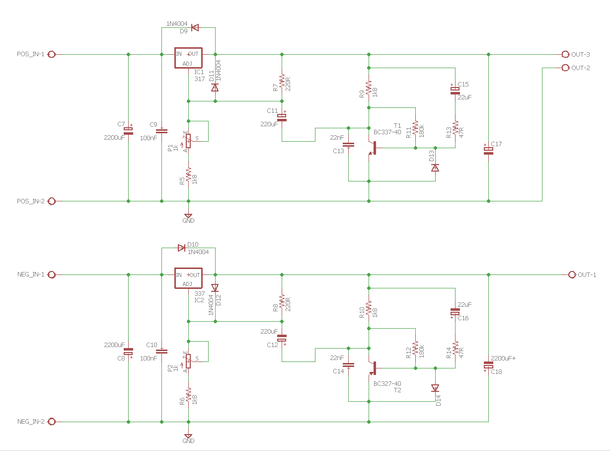

Here is schematic, i used OPA211. On schematic there aren't any decoupling caps, i have use 100u,10u smd,100n smd on both +/- supply rails, and 9V batteries to power up OPamp.

Yes, it can work very well for the 5V output voltage with some component values adjustments.
At first, my design was not intended to become public but one form member was in search for a single rail design. I really recommend Mark Johnson’s VRDN project as it is professionally made up to highest DIY standards and contains BOM and building instructions.
VRDN: bipolar regulator PCB for line level ckts: ±11V to ±20V @ 1.5A with "De-Noiser"
For dienoiser version, BOM is dependent on output voltage and current. If you really intend to build this PS, I can prepare tailored BOM for 5V / ?? mA.

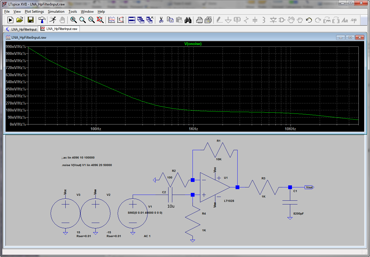

The noise floor is not exceptional, and I had to make my own LNA to really evaluate the denoiser.

am I correct to think that R2 set current and RV1 output voltage
RV sets output voltage. R2 is part of RC filter and it’s value should be as high as possible but maintaining reasonable voltage drop and dissipated power.
BOM with values optimized for 5V output is in the attachment. According to the LTSpice simulation, with these values regulator achieves over 140 dB PSSR (surely somewhat less in practice).
Optimal dienioser values are different for various output voltages. With BC transistors, output noise level could be less than 0,5 µV and with ZTX ones less than 0,1 µV. Output impedance is in range of µ ohms.
Suggested part numbers in the BOM list are by no means exclusively acceptable or best possible. The most critical part is C8. It has to have ESR in certain range. To low or to high value and regulator could oscillate. That’s why there is a position for resistor in series with C8 so ESR can be adjusted and it is possible to use long life, low ESR, big value capacitors.

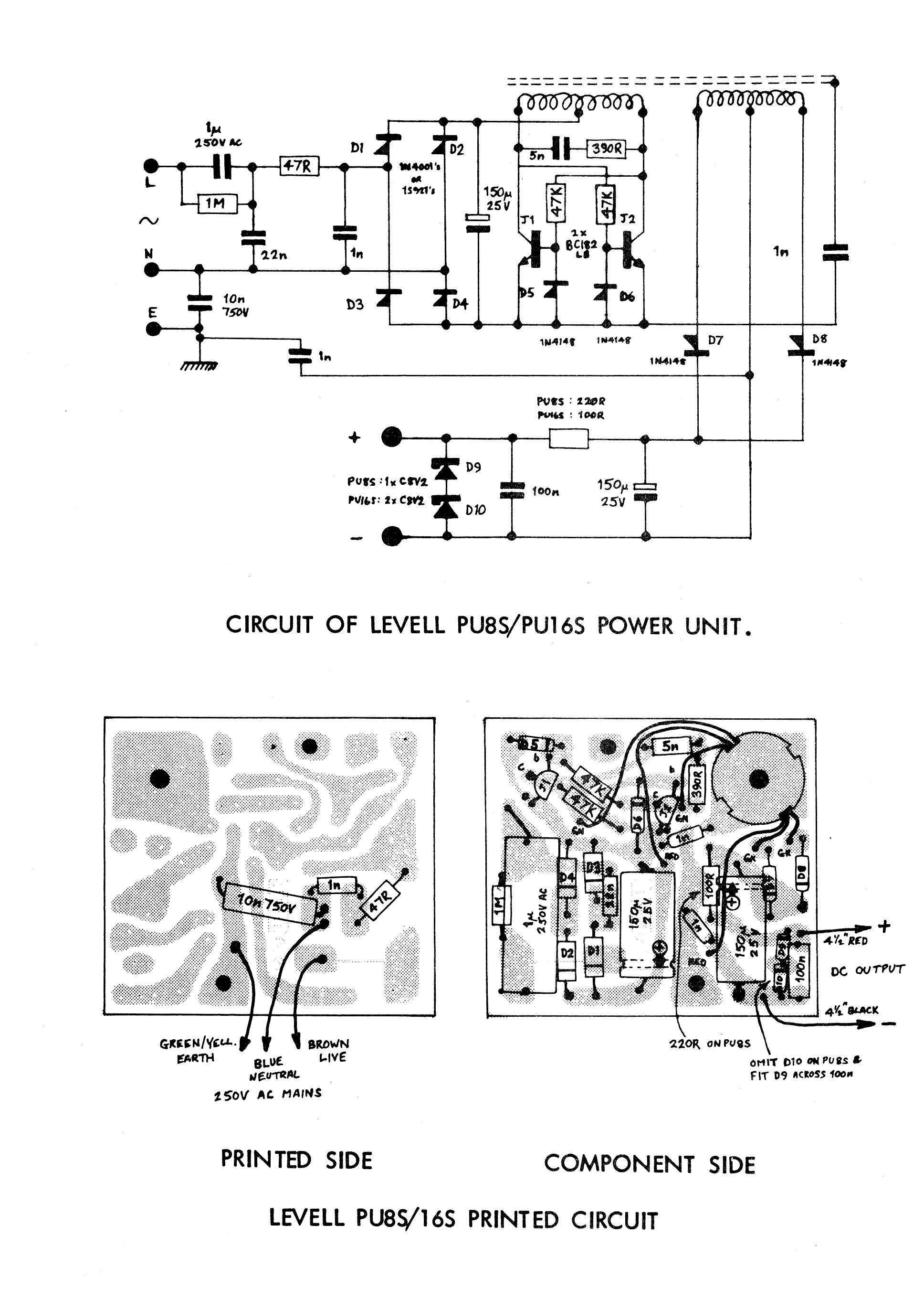

I tracked down a schematic of the original mains power supply Levell sold for this unit and it appears as if it would be much, much noisier than your design.
I shall compare the noise floor to the figures above and see, but I am much reassured that it will be fine.

It is OK with three remarks:
LM337 needs resistor (probably 33R) in series with C14 for stability
Output capacitor should be 100 µF with ESR in range 180 – 300 mΩ, or you can add small resistor in series with C17 & C18 and use big capacitors (low ESR)
D11 and D12 can be 1N4148
