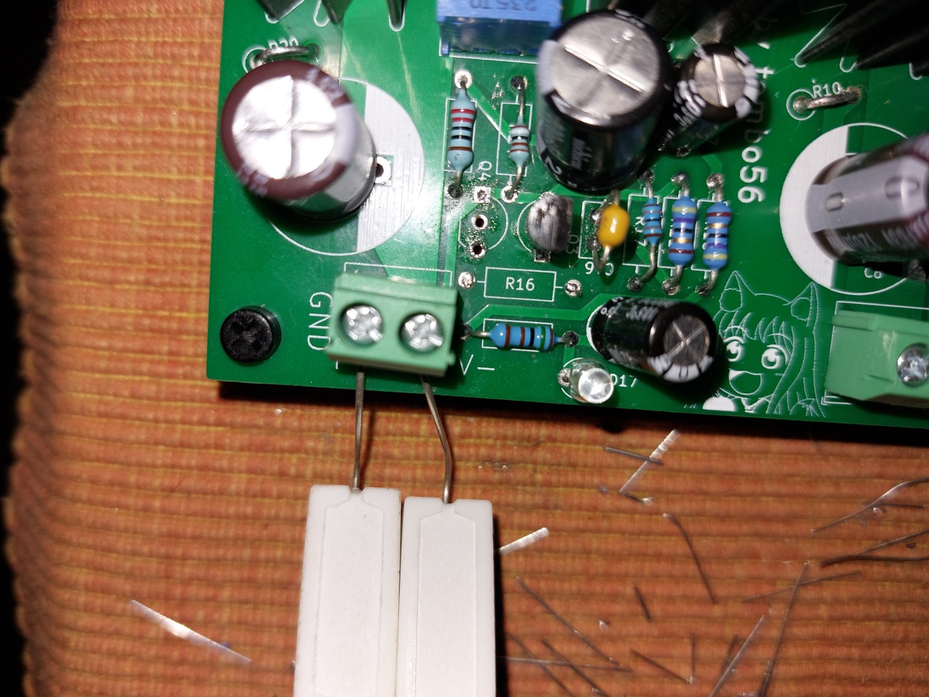

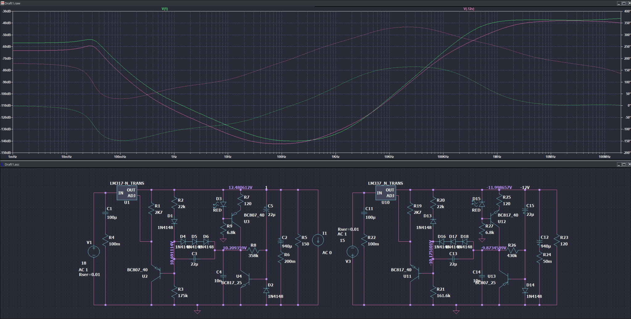

Changed it to a denoiser and its now rock solid. It takes around 8 seconds to get to stable voltage of 12.81 under load. The transistor is directly jumpered to R16s closest pad. The dnoiser is better than running the regulator without one.
Reactions: tombo56
I didn't create gerbers; @Trileru did.
I hope you are talking about the regular denoiser, because the dienoiser cannot be stabilized, as Tombo said. For the regular denoiser, you can find useful tips about the suitable types of 337 in the VRDN thread.
You'll have to browse through a large number of posts, but it is worth the effort
I did manage to assemble the SMD board but didn't test it with LNA. Still Vout seemed stable even when poking with metal tweezers at denoiser circuit innards.
This design should be close to 140dB for PSRR and lowest noise out of all designs, though I'll have to run the LNA tests.
Also this is for around +/-12Vout. LM337N from TI seems stable so far. Output caps are nothing special. I provisioned the board with extra 0805 footprints in series with output caps, just in case I'd need to use some small inductance there but doesn't seem necessary at least looking at DMM on output. Still, even if it proves necessary I might be able to design the extra inductance into the PCB traces, so as to remove that component altogether.
I want to also test with two BJTs in parallel in denoiser circuit for that extra low noise but I need to find the time for everything.

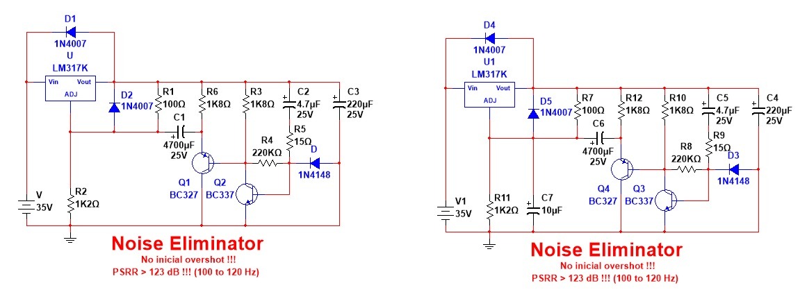

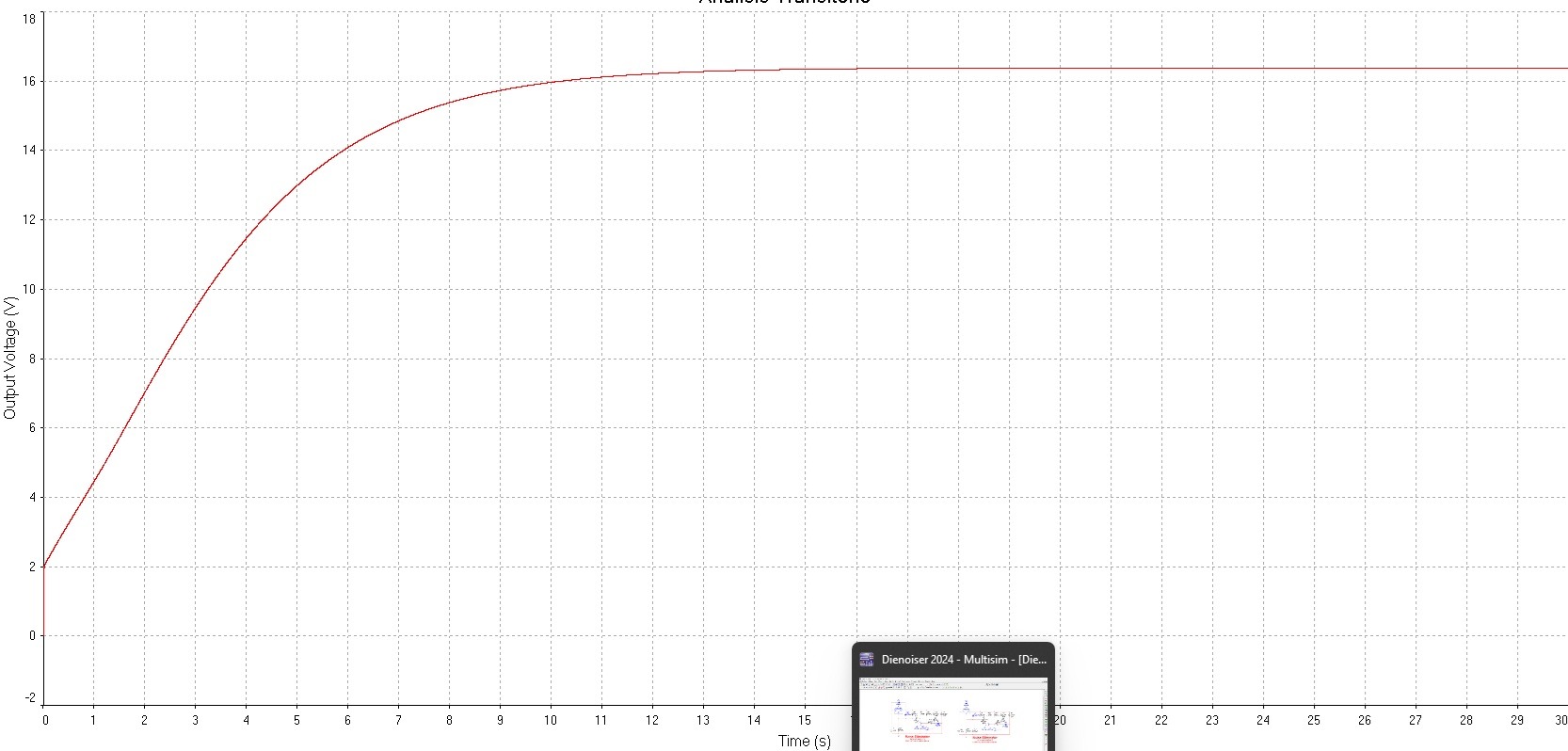

Attached schematic for the values I assembled on the PCB, including BJT gain ratings. I used the Nexperia spice models for BJTs and TI's LM3x7-N spice models.

Sorry, but negative dienoiser version can’t be made stable without changing design. Positive regulator is unconditionally stable and two positive regulators can be used for a bipolar supply.
I also had a crack at negative dienoiser but it wasn't a good experience. Thought I got one stable (with addon board) but in time it started to oscillate. I had better luck with the negative NoNoiser version (with CCS)

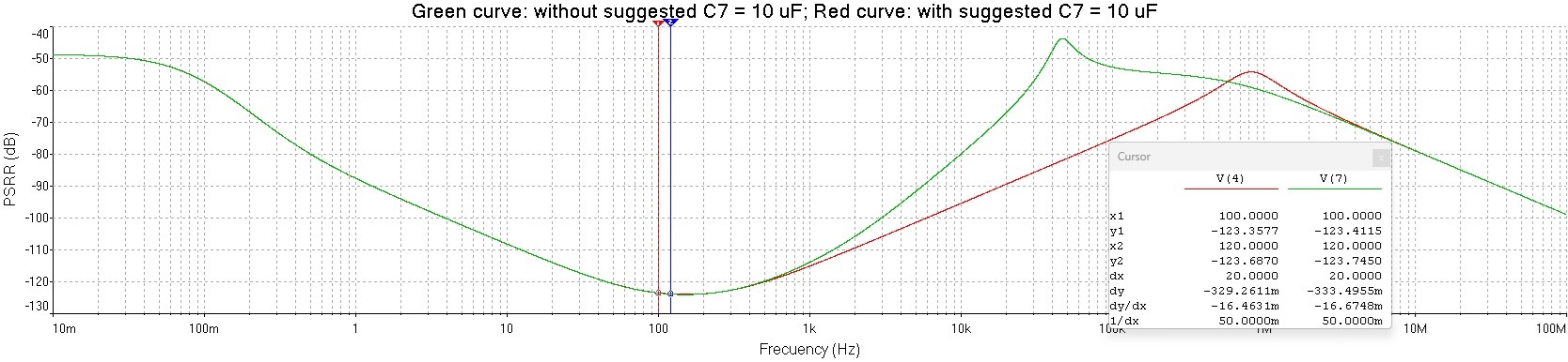

In the previous post I made a mistake in indicating the curves. The correct indication is: the green curve is with capacitor C7 (as the manufacturer usually suggests), while the red curve is without C7.
It can be seen that the circuit is quite tolerant to the presence of C7 (in the low frequency zone), so for the implementation of the "Eliminator" it would not be necessary to eliminate C7.
Only if the high frequency area needed to be significantly improved would I suggest removing C7.
