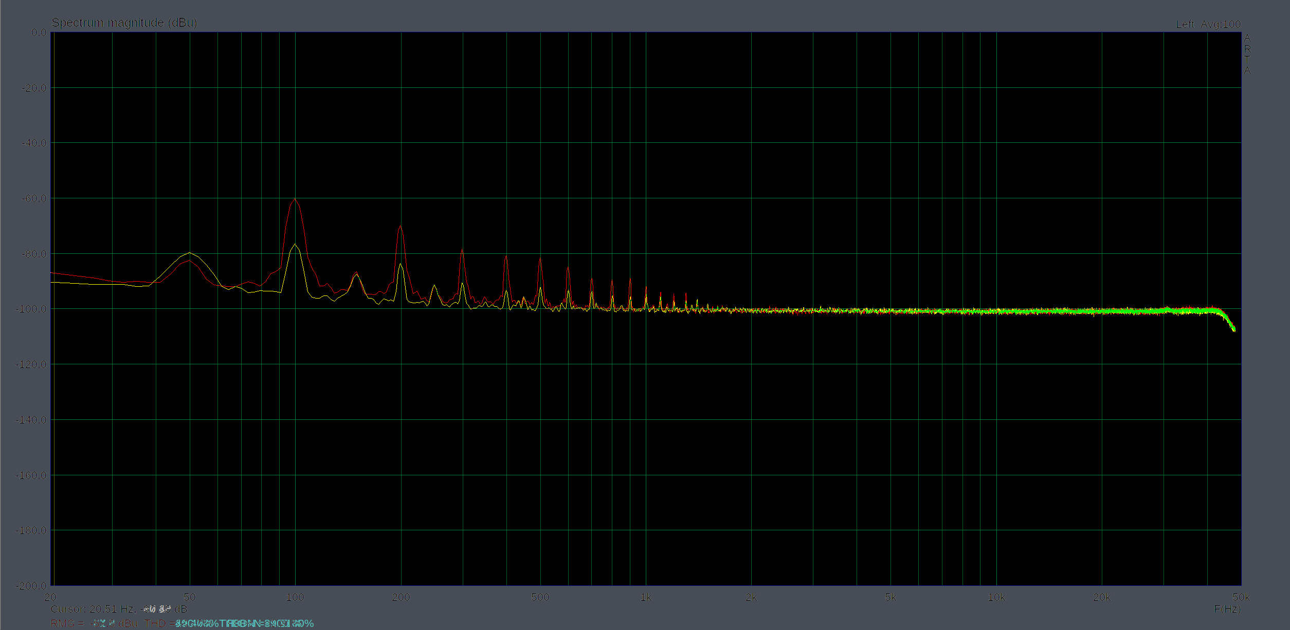

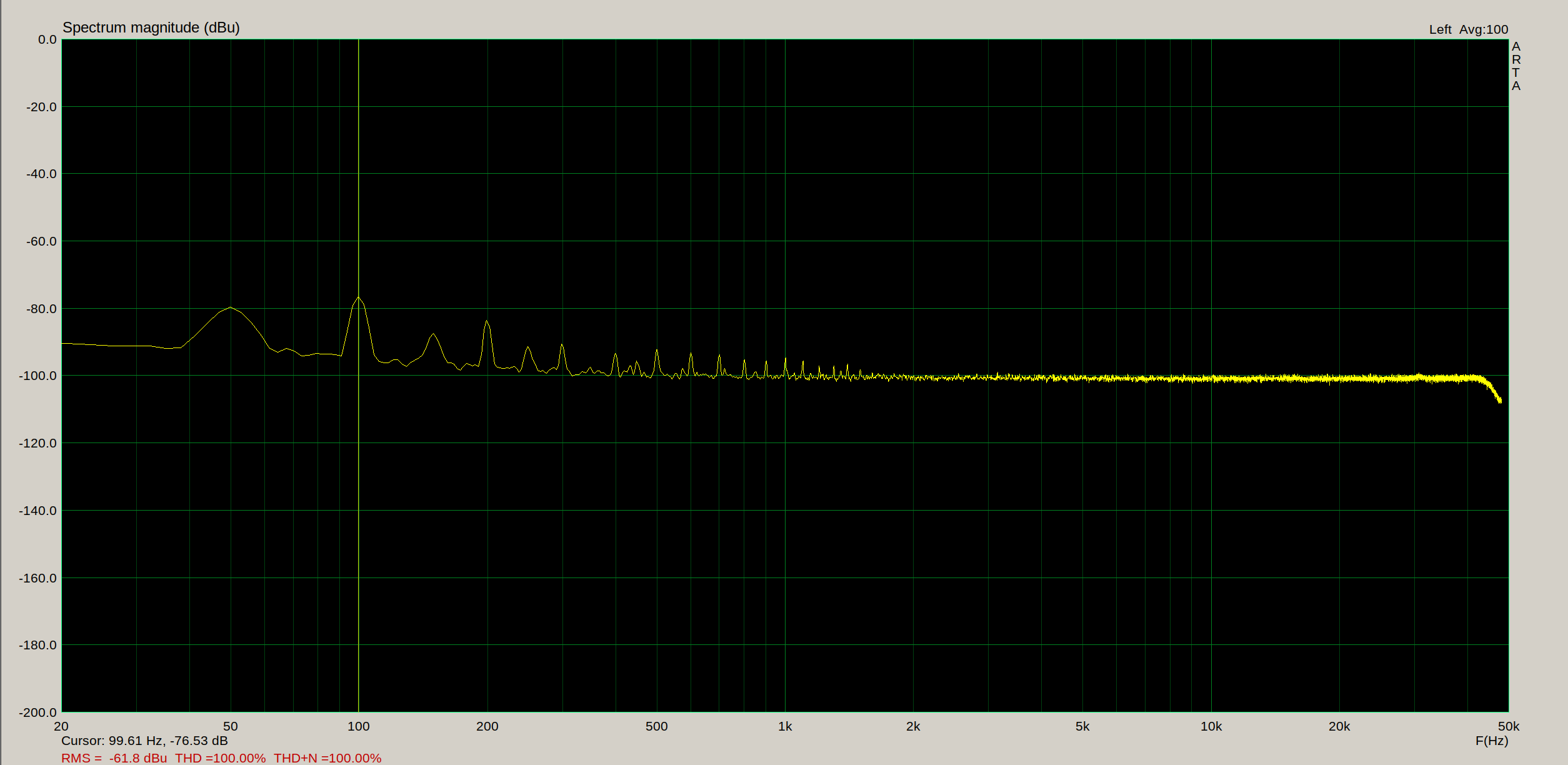

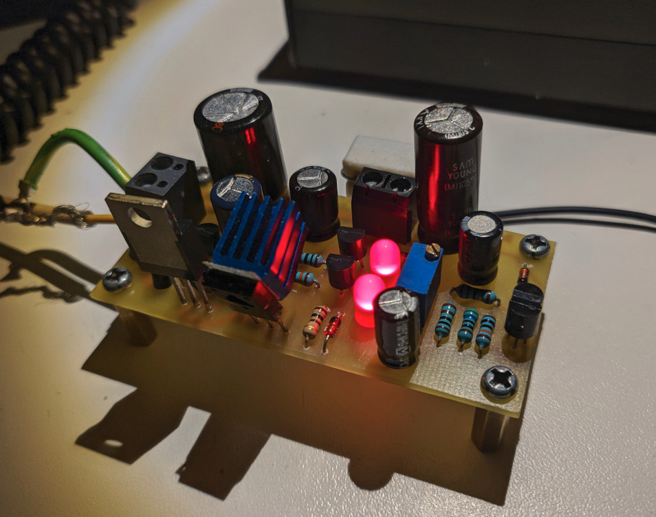

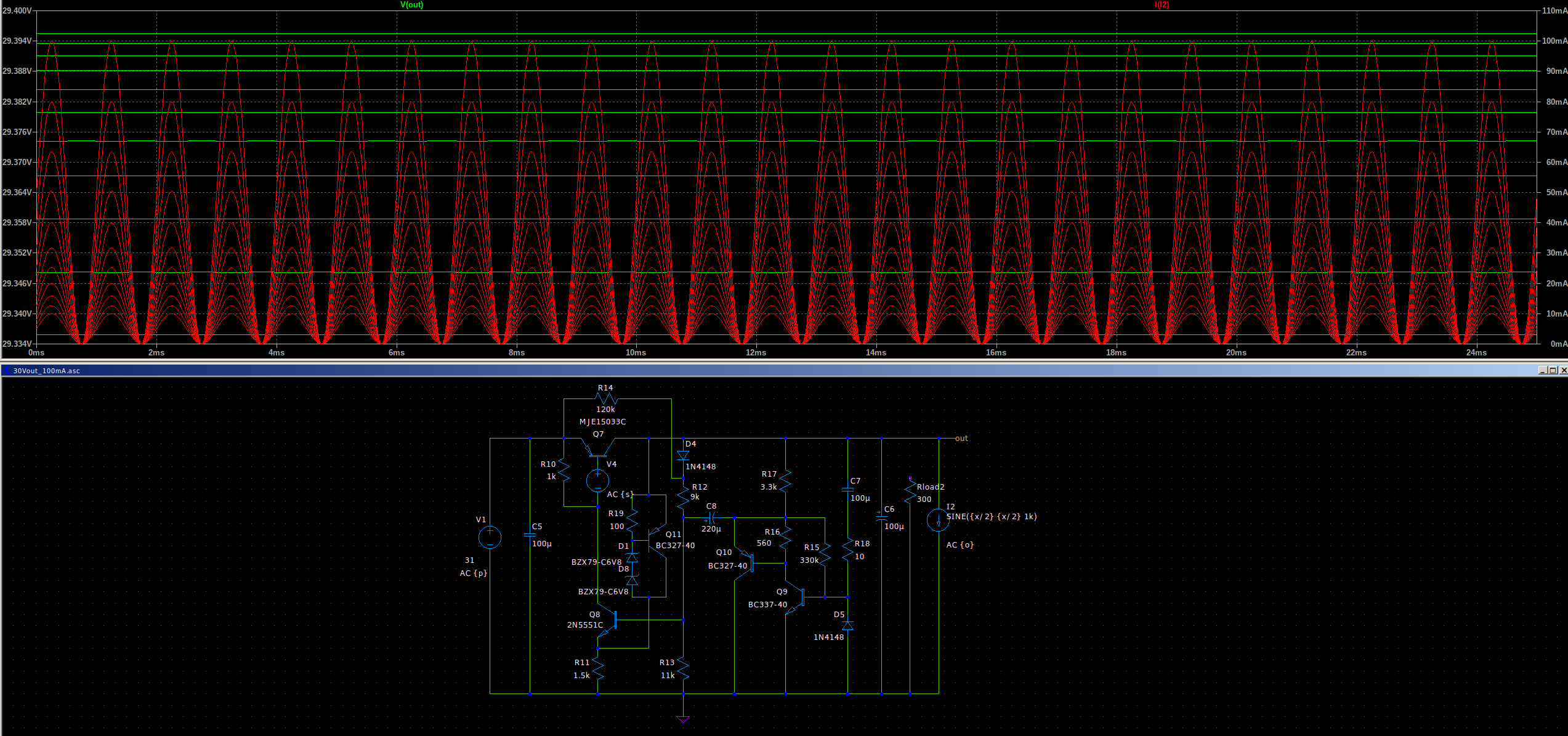

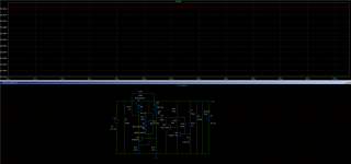

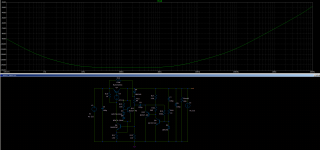

So actually I installed the 2N5551 the wrong way. I made the pcb with a BC337 footprint, and while quickly checking the 2N5551 datasheet I saw that the base is in the middle, but C and E are swapped. Installing the 2N5551 the right way seems to make it work right, and also doesn't need any compensation! Seems stable without any compensation.
I didn't have any MJE15033 PNP transistor, so I used the best I had according to sim, 2SB649. I'll test BD140 as well and maybe a few others I have. I will get a MJE15033 when I get the chance.
The performance seems to match the simulation, at least for PSRR. For noisefloor it seems the same as the previous discrete design. I'm not sure if it should be lower, as the .noise sim shows similar noise, but trying the self-noise sim as the other LM3x7 sims shows it should have a lower one. I'm not sure if this is due to my measuring setup, or I need to put the board in a case to get a lower noise floor.
I attached few photos, first is the measurement without the capacitance multiplier in circuit (with it it looks the same as the other ones, nothing above the noisefloor). The second photo is a comparison between the first discrete design with positive feedback. Yellow trace is the latest design, red trace is the previous one. The input ripple is around -3dB to 0dB so the attenuation factor is the value on the graph with the extra -60dB from the LNA.
Output voltage is 11V, output current around 100mA total.
I'll test more the following days. But this looks very good! Second discrete design + denoiser.
edit: I used two random red leds. I'll try with LM329 as well, should have better tempco but higher noise. Also maybe the potentiometer is not the best for lowest noise, but very convenient for setting output voltage. With MJE15033 it should push -140dB for PSRR.

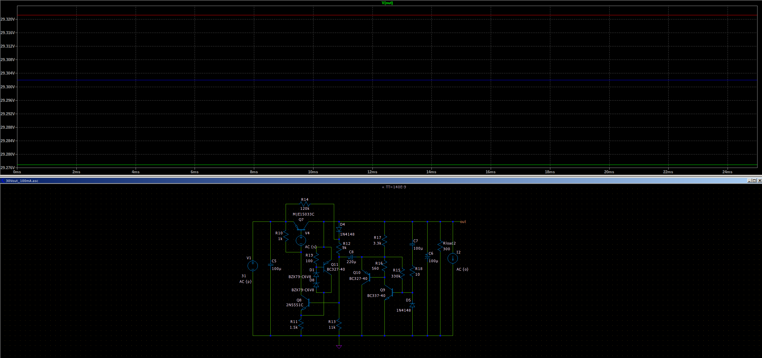

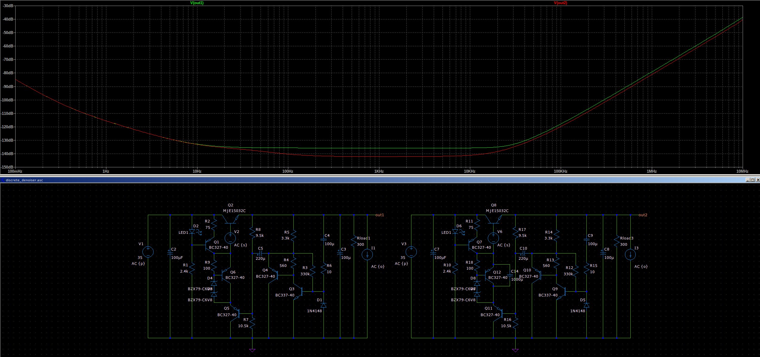

You can lower the noise floor and improve the performances by bypassing Q27.edit: I used two random red leds. I'll try with LM329 as well, should have better tempco but higher noise. Also maybe the potentiometer is not the best for lowest noise, but very convenient for setting output voltage. With MJE15033 it should push -140dB for PSRR.
Since it is a LDO topology, it is normal to have a drop of ~Vcesat

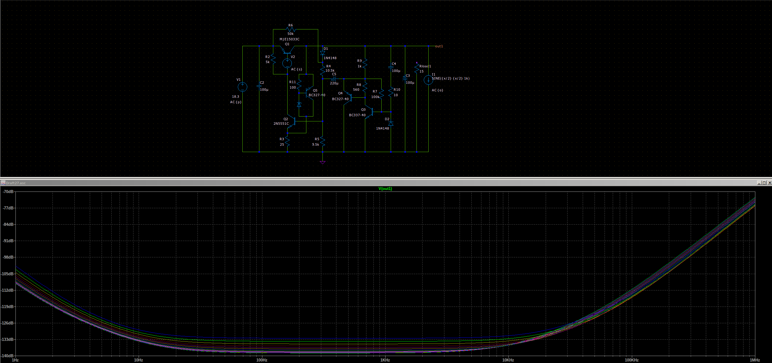

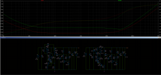

It seems the LM329 variant benefits the most from this, but not by much, around 5dB or so. And I had to use a 470uF cap, but 1000uF would cover the audio spectrum better.
The best compromise for noise and tempco seems to be a normal 6.2V Zener. I think LM329 is an IC? With it it wouldn't be a full discrete regulator.

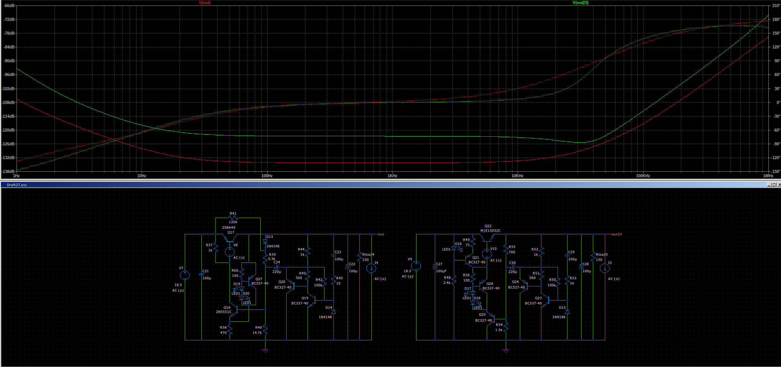

Negative version with MJE15032 has a bit lower performance. I guess one could use two positive versions with dual secondaries. For the negative version one would have to just flip all polarities and replace each bjt with its complementary, same pcb could be used.
Simulation shows some instability without compensation for denoiser. I might add 33nF/4.7R on the pcb to be on the safe side. If there's anything happening it doesn't seem to affect the audio spectrum that I can measure. I still have to measure with an amp attached.
I'm also curious about trying to push more current through the regulator. Would be great to get few amps out of it.

Actually adding 30nH to the output cap specs seems to clear any instability issues in simulation. No need for compensation network for denoiser. Might be why I didn't notice anything at first measurements. I used a rather tall output cap which might have some ESL.
edit: ESR of output cap doesn't seem to matter. Results are similar with 50mOhm and 200mOhm.

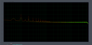

You can get an idea by a.c. coupling the output of the "de-noised" regulator to a low THD signal source and looking at the FFT on the output supply rail.
I mentioned few pages back that it improved my DAC and headphone amp. I also have a DAC pcb that I'm waiting for. I designed it with LT3082+dienoiser for all 5 positive rails and LM337+dienoiser for the negative. I should have gotten it few days ago, but instead the courier gave me a jacket. Which curiously also fits me. So now I have to wait again for snailmail and hope this time they don't mix the packages again.
If you are talking about the discrete supply, I think it would be rather boring directly listening to its output. I could probably hear my thoughts.

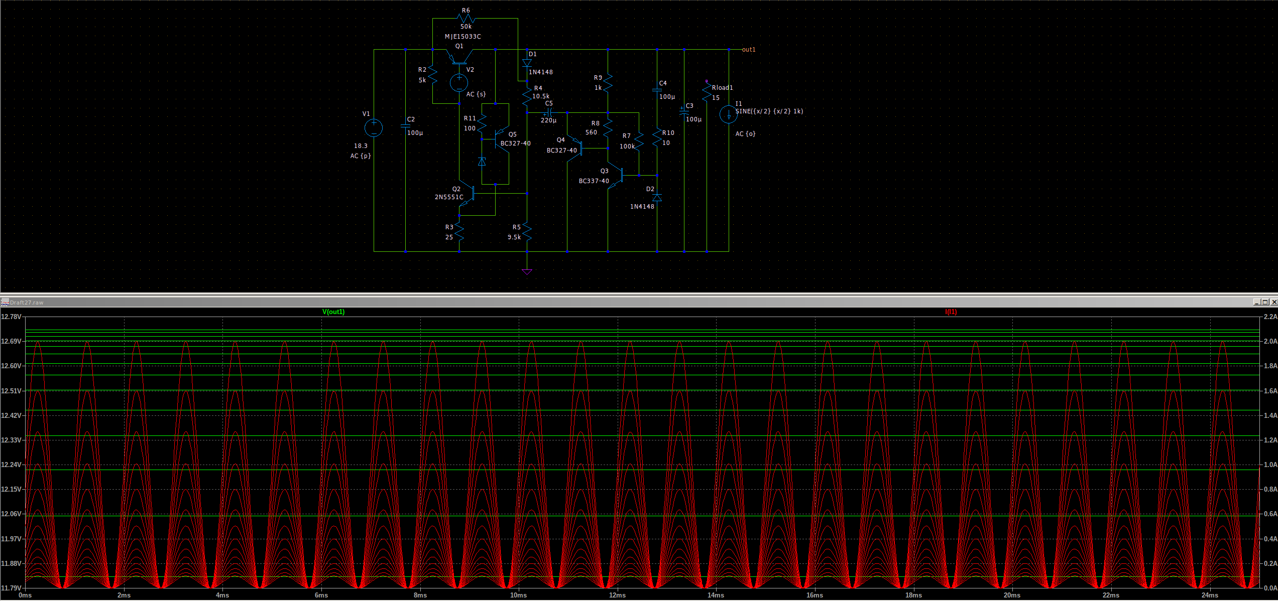

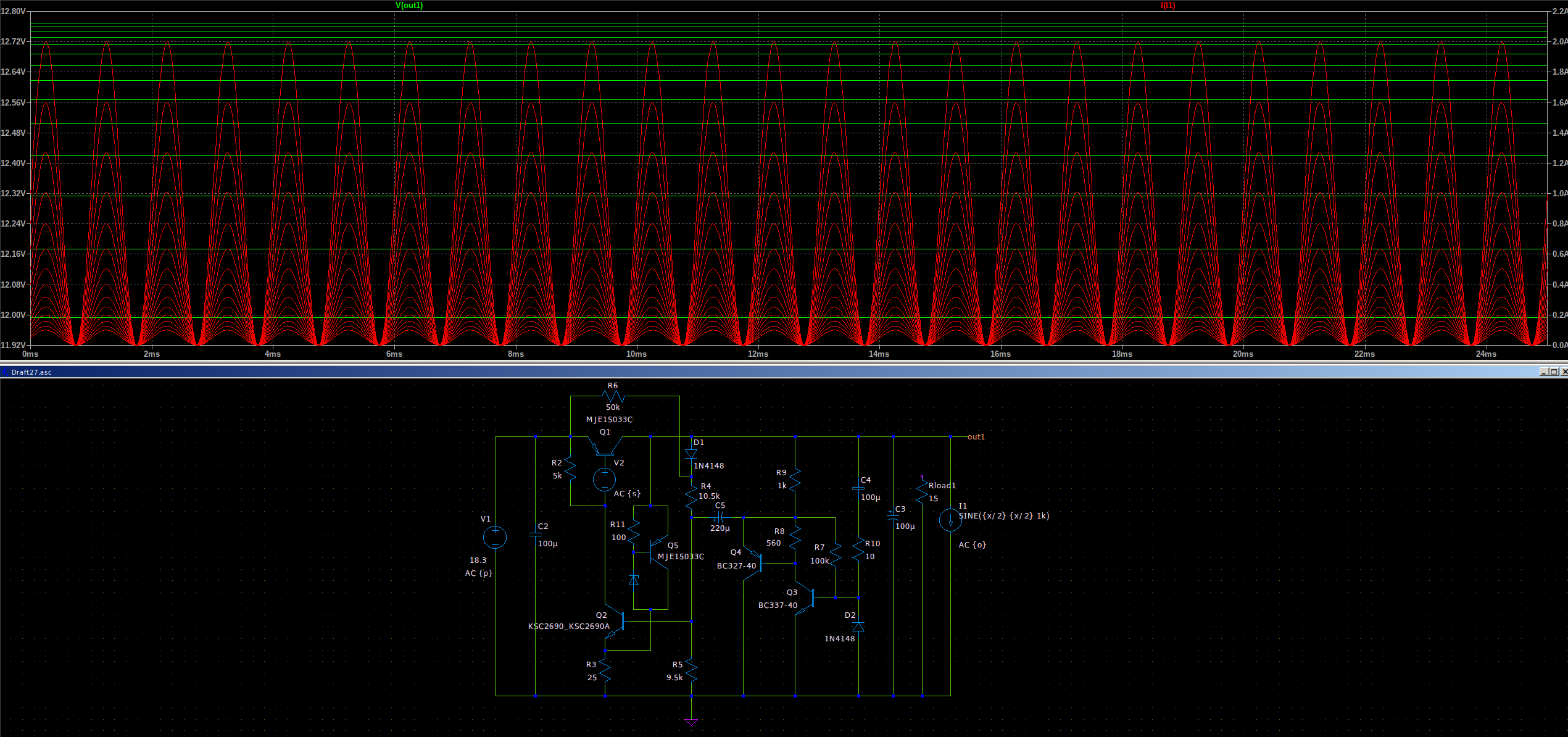

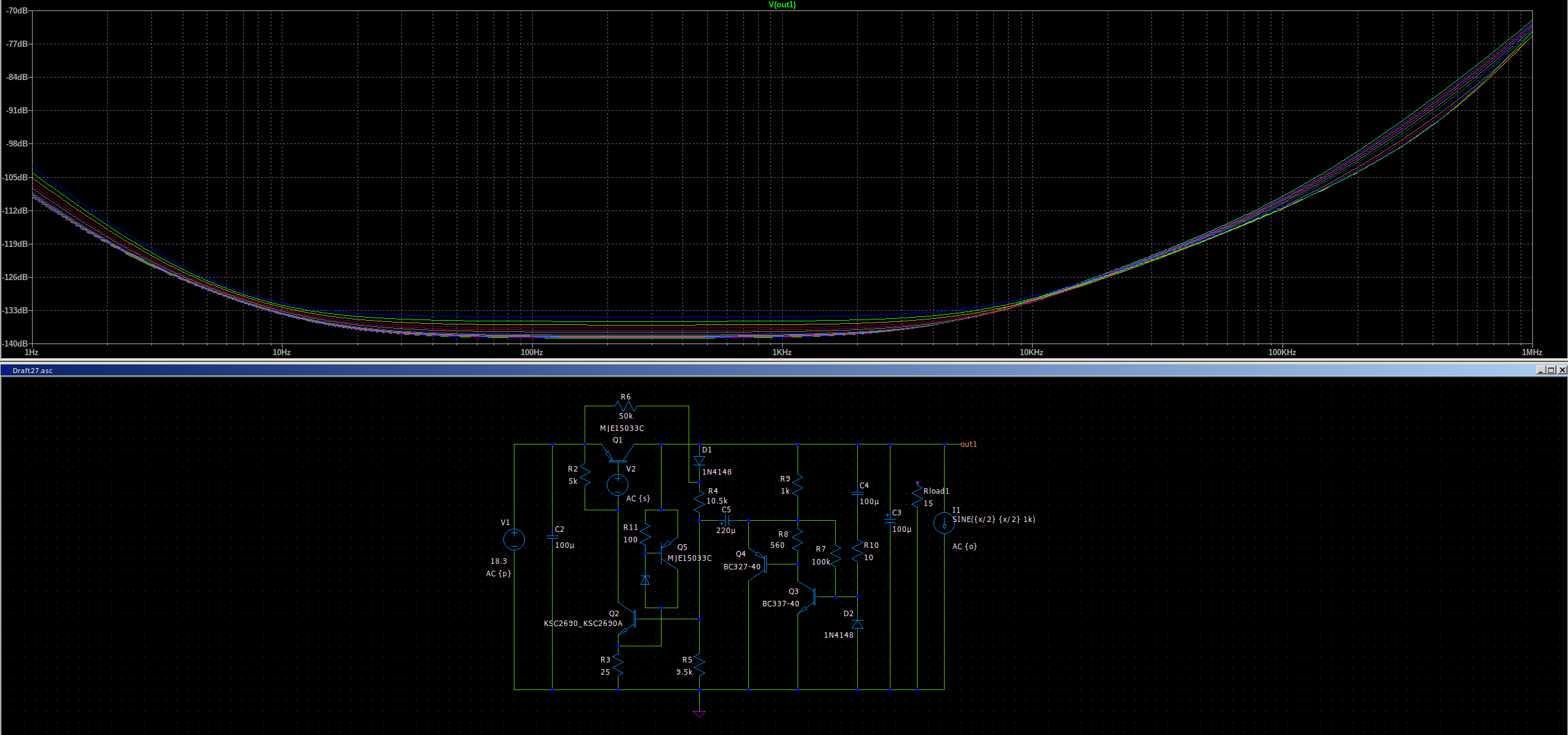

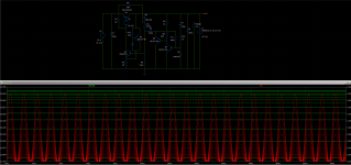

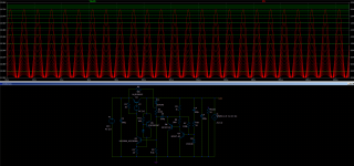

Seems that I can get 2A out of it but the output sags a bit. The output impedance stays real low, why does it sag like this? It's even worse with a resistive load.
In this configuration R3 dissipates 1W in heat, and Q5 should be replaced with something like a TO-126 package as it dissipates around 1.5W. Performance seems to hold at 2A. The only issue seems to be the drooping output voltage, especially when I test with a resistor as a load.
The photos are with a stepped AC current load, 100mA to 2A.
edit: seems like more powerful transistors help with lowering the droop.
also higher voltage lower current seems to work fine. I simulated a version for around 68Vout and results seemed good.

Yes I think it should be doable. What max current do you need?
I simulated for 68Vout with very good performance. This supply should be very flexible, and cheap.
Current up to 100mA, it should be more than enough.

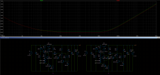

For some reason with these values there's even better performance. I added a simple Zener part that I could also find a spice model for. It could be replaced with a 12V variant. Tempco seems pretty good also.
The resistor divider could be replaced with a 20k pot for fine adjustment.
edit: spice model is from Nexperia website.

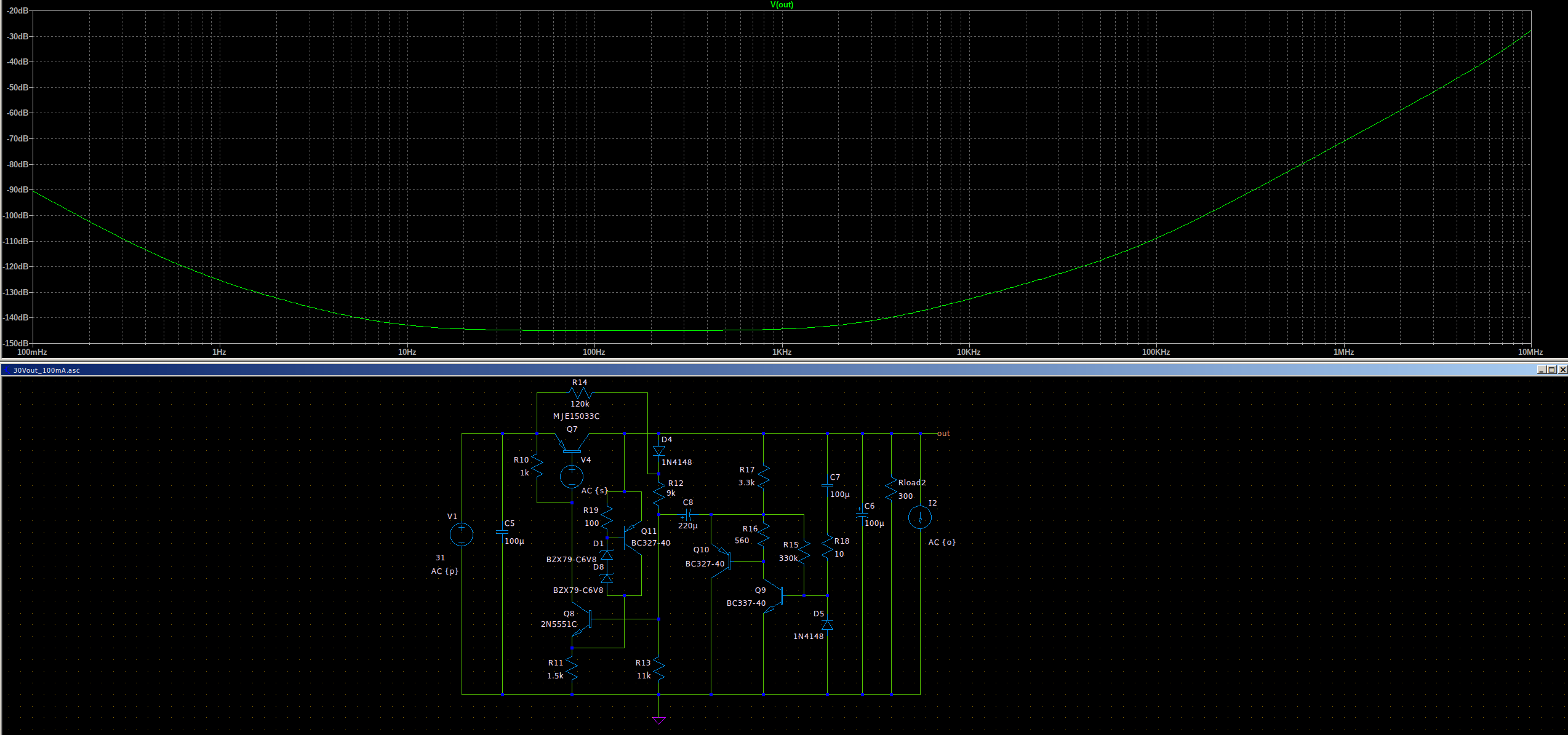

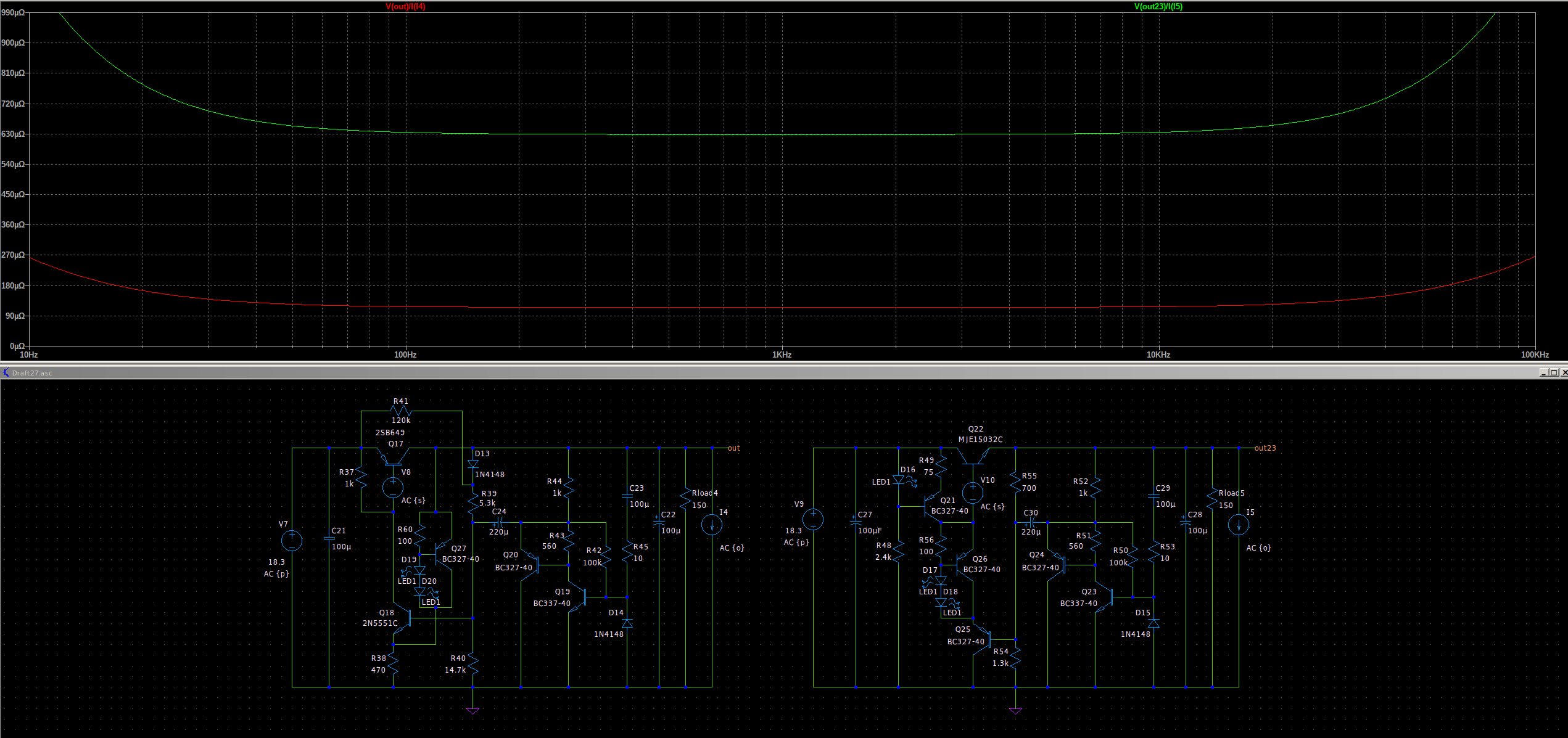

Seems like the positive feedback version benefits more from this. Also seems that both designs do better for PSRR with higher voltages.
1000uF seems to cover down to 100Hz, and now it offers -140dB at 100Hz. 30Vout and 100mA. Output impedance is also lowered.
