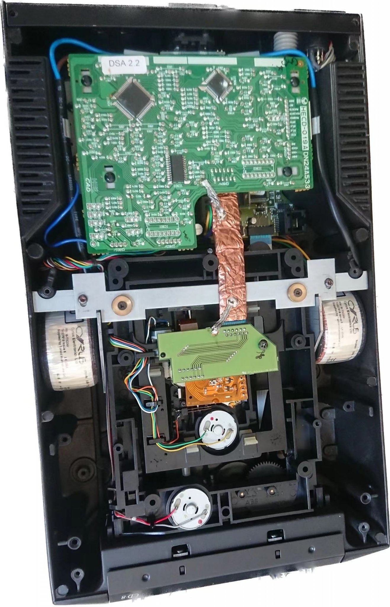

Re. All repaired, but i'm thinking that this has caused the issue with no sound?
Difficult to say without a circuit diagram. Powering the player with the damaged traces may have damaged something.

I did repair the traces, but wonder if i've damaged the voltage regulators with all the heat required to remove them? I'll contact Cyrus and ask if they can supply a circuit diagram, be interesting to see how helpful they'll be 🙂
Can you not test the voltage regulators? I expect them to be 3 pin TO22 devices, 78xx or LM317 devices, they should be able to take a fair amount of heat.
They are cheap enough to replace, cut the legs off, desoldering the remains of the legs should require less heat or solder the new device to the remaining legs, not ideal but it should hold.

I emailed Cyrus last night, and first thing this morning they replied with service manuals for both the CD8 and CD8x, he even supplied another for an elderly dAD3 I have as well 🙂
I agree about the circuit boards not being the best, a few traces underneath some of the SMD electrolytic caps came off, easily repaired though thankfully.

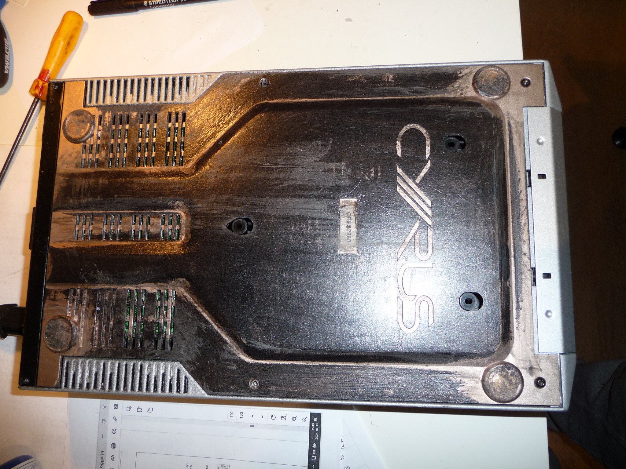

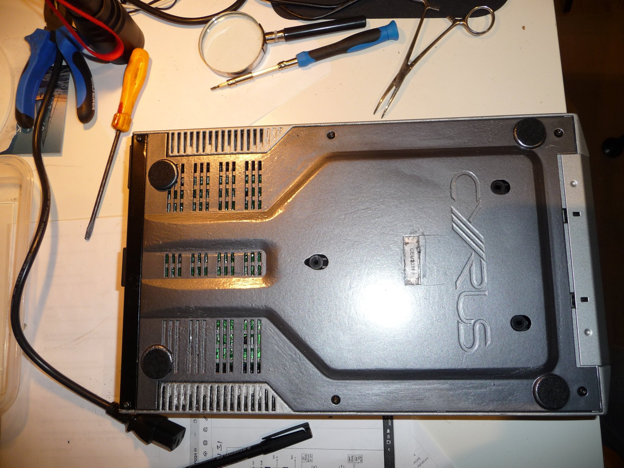

The CD8 was working fine yesterday, albeit it with a sticky drawer, so I had a go at sorting that today. Well after most of the day tinkering with it, the bloody thing is still the same. Only trouble now is that it only reads and plays discs if the bottom is removed!! The CD8x still has no sound from it still.
The dAD3 has a non functioning front panel, no matter what I do to it. However I added a 3 pin IEC socket and grounded the chassis and whereas before it was hit and miss as to whether it played a disc or not, it now plays faultlessly every time (and the drawer works fine as well)
