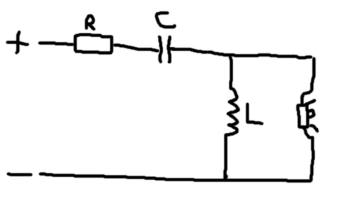

What are your views on "padding down" the tweeter by adding a resistor, or are there better ways of reducing the treble?
This is how the layout is by default at the tweeter input:
R = 3.9 ohms 7W
C = 4.7uF 100V DC
L = 270uH

Sometimes reversing tweeter polarity can help with problems at the crossover frequency.
IMPORTANT: Are your woofers wired correctly. If one is out of phase then you will experience a lack of bass and, therefore, more prominent treble.
If you want to reduce the treble then you could try an L-pad attenuator. This reduces the level without affecting the crossover frequency too much.
