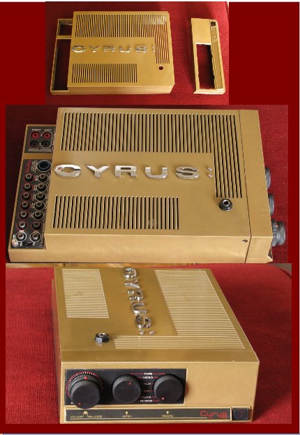

Cyrus Thread mixed up.
'😱' Hi all,
I have just realized that a bookmark I created on this thread, has been leading me on a merry dance, The post numbers, were all over the place, and I didnt even notice. That explains why I thought people were answering the wrong people, and I got topics mixed up. I have now sorted the problem out, and reading again, all seems quite logical now. I thought eveyone was just jumping in on the band wagon, with no sense of direction, but now I know why.
Chris Ive only just started to read replies to things I wrote which have been hidden from me by this bookmark thing. I think it must act a kind of filter in firefox when you bookmark something, cause its missed loads of thread numbers out. but this goes for everyone else that has taken the time to reply to me, many thanks guys, sorry its a bit late.
Ok, I would like to post a larger picture of my cyrus but don't know how you do this without having a web hosted site to give the address. Any advice would be welcome.
I had not realized that regs go noise with age, just thought they either worked or failed. So you would recommend replacing them anyway. What would you replace with any ones which regulate the same voltage, or are some better than others.
The BUV48Cs that I replaced were in two per channel pairs, when I said balance, I perhaps should have said tonal balance of each channel. I did not know if they would be a different sounding Transistor to PT77s, so replace all 4 two per channel to make sure I got the same characteristics on both channels. If that makes sense?.
Hence I now have 3 spare PT77 Transistors that check out ok.
OK you called me, on the relay, Ive so many projects waiting to be started, that I really have to revisit at another time. so spot on there.
Im starting on building a pre-amp from a book on building hi end audio, and so far have only got as far as putting tracks onto Transparency, and securing the Copper cladding and ferric oxide.
I really would like to crack on with this pre-amp. But im a little worried that after all the time money and love spent on this project, sourcing the very best components for it, That its not going to sound much better than my newly restored Cyrus Two. How much better does it get.
But I still feel something driving me to take the plunge anyway. I guess you cant know how much better it gets until you here it.
My source equipment is excellent, and probably held back by as good as it is, the amp. so Id like to try and build my own, but trying to minimise on compromised quality vers cost.
The book this is taken from is called Build Your Own High-End Audio, and is by Elector Electronics and covers a wide range of equipment, from amps to surround sound to loud speakers, to audio testing with spectrum Annaliser, AF measurent systems ect.

As Promised Pics of painted Cyrus Two
Hi all
Here is a pic of the re-vamped Cyrus Two, hopefuly, beats battleship grey Im thinking.

Hi all
