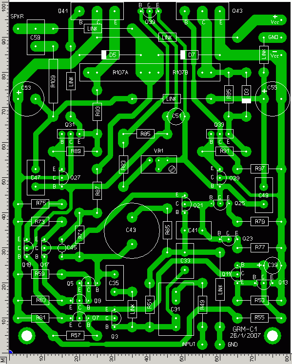

The hi-res image only takes a minute or two to produce but now that the layout has had an independant check I will make some (most?) of the traces wider before generating it. After all, there is no point in etching away more copper than is necessary. If any further comments or suggested modifications come in then it is an easy matter to amend the layout and produce another copper pattern.
I just ran some numbers on 1pair of MJL4281/302 @ a sink temperature of 40degC (Tc<=50degC) and supply rails @ +-38Vdc and the result was a pleasant surprise.
50W into 8ohm at 60degree phase angle and one second SOAR.
but also safe into 4ohm at the same 60degree phase angle of a reactive load.
The downside was the poor power delivered into low impedances.
76W 4ohm, 82W 3r, 86W 2r.
Seems like a good 8ohm amplifer that could also drive 4 to 8ohm reasonably well. Something the original would struggle to stay reliable with.
Attached is the modified board with wider tracks where feasible.

consider adding an on board resistor connection between signal ground and decoupling ground. It provides a lower inductance path between the two sides of the PCB.

Here you will see the three different ground symbols and how they relate to each other. Also note the presence of R121, a 15R ground lift resistor. There is no protection for this resistor so if a fault causes a significant current to flow to the mains ground this resistor is likely to blow. Not a particularly good situation!
AndrewT said:
Geoff,
Andrew
I agree with many (most) of your commments, for example providing protection for the feedback capacitor etc, and these are things that I may well have included had I been producing a design from scratch or modifying (improving) an existing circuit. However, the object of this exercise was to replicate the original Cyrus 1 circuit as that was in what jmateus expressed an interest.
Now if he were to ask for an 'improved' Cyrus 1 then it would be a different matter.:)
Geoff

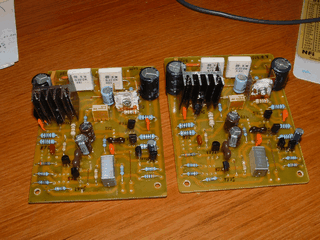

The right side driver doesn't have the final heatsink, it interferes with
the adjusting pot shaft so it will be installed after the adjustment.
That's exactly the planned final amplifiers, two monoblocks. I hope
everything comes out ok, let you guys know the progress.
Wish me luck
The original Cyrus doesn't have heatsinks on the two TO-126 driver transistors which is why I didn't allow any space on the pcb for them.
Post Script: I was also anticipating top-adjust presets. ;)
