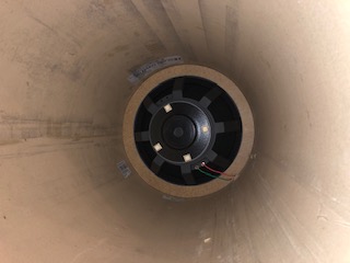

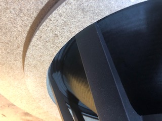

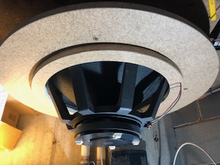

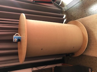

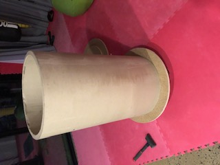

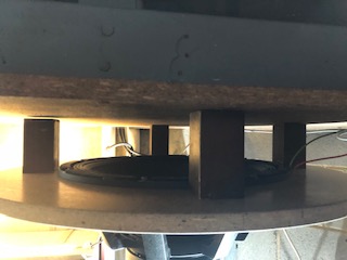

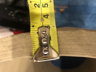

18” woofer in cardboard cylinder.
I built this over the past couple of weeks. I’m happy so far. Still no stuffing and it needs external finish but already sounds grand. The driver is mcm the amp a nobsound. The tube is 940h x 550od x 25 wall. The best bit is I’ve got a couple more 😉
