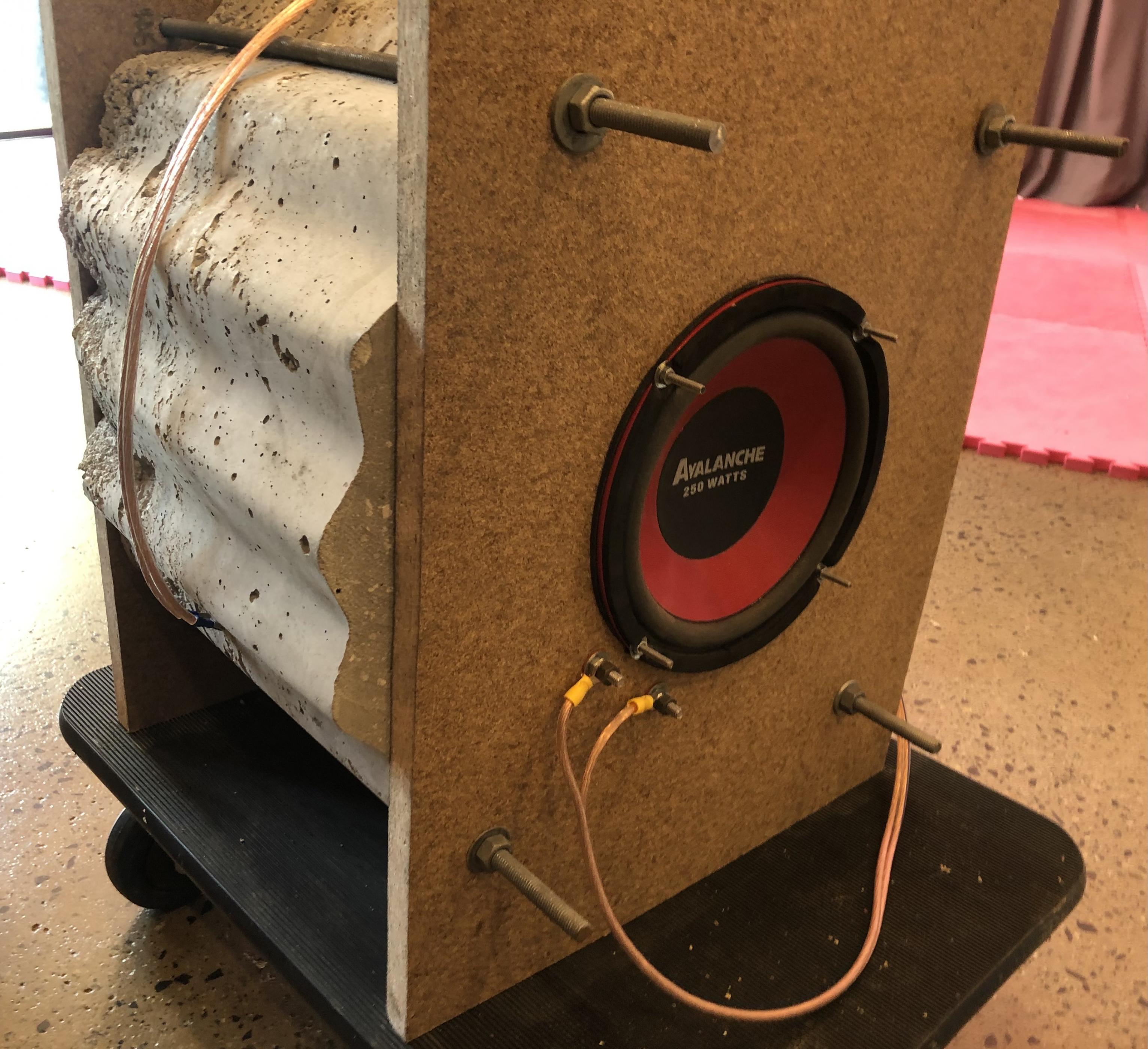

I’ve cast a concrete speaker between two rolled up sheets of corrugated iron. It’s inert as only concrete can be. It’s also heavy @90 kg despite the small size. It ended up in the front garden with a flower in it... not to say it wasn’t fun making it. But moving the damn thing when rearranging furniture wasn’t.

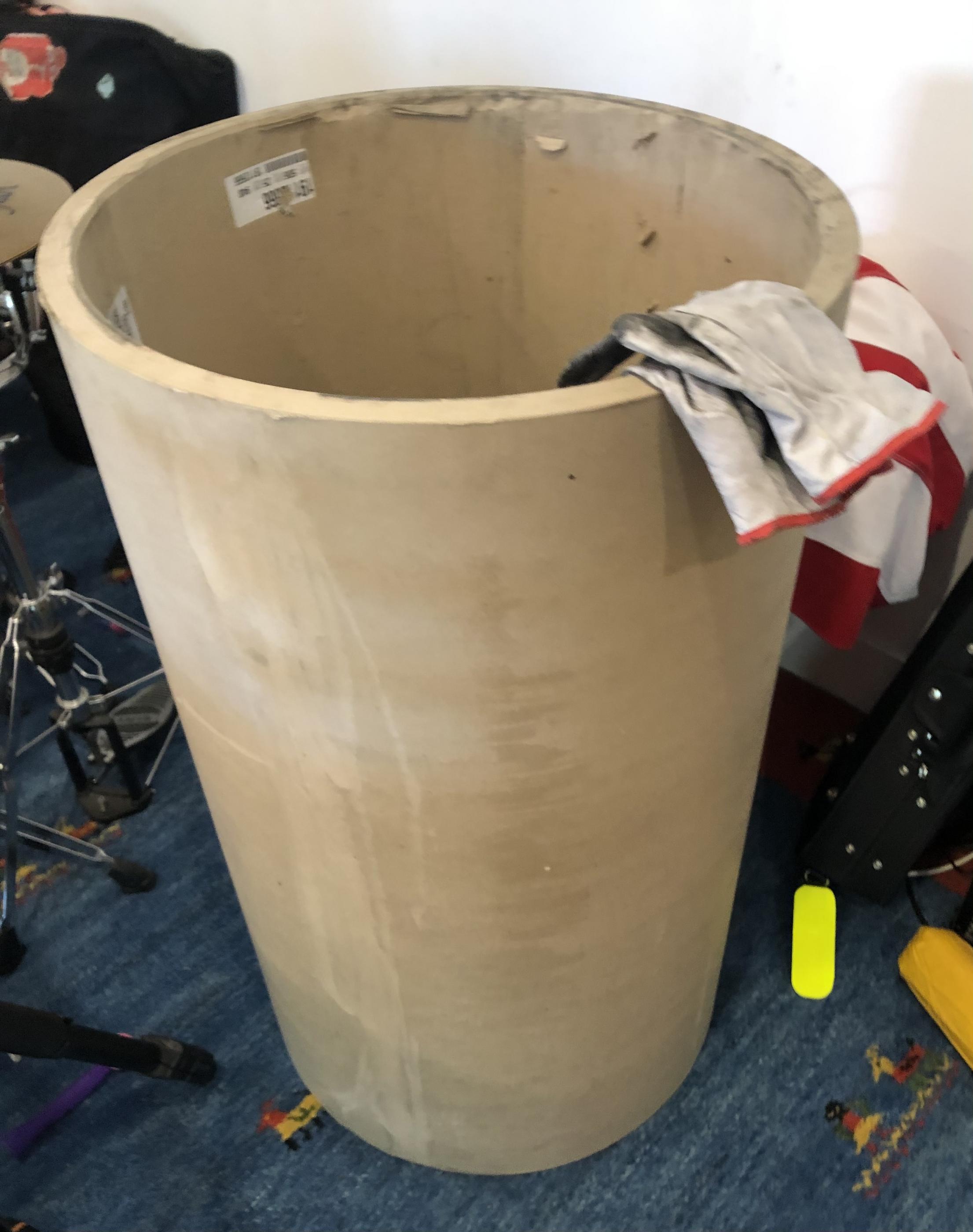

I’ve now got three 950x550mm cardboard tubes with nearly 25mm wall thickness waiting for some 18” subs. The cardboard tubes weigh about 20kg each, very manageable. Compared to concrete anyway. These tubes started their life as cores around which some tons of steel was wrapped. Find a local steel shop and ask them if they’ve got any.
Tried to tack on some pics. Also note I used two sets of threaded rods in the concrete sub to hold it all together, as per the pre tensioned principle mentioned further up in the thread. That works really well.
Send pics of your build I’m intrigued.
