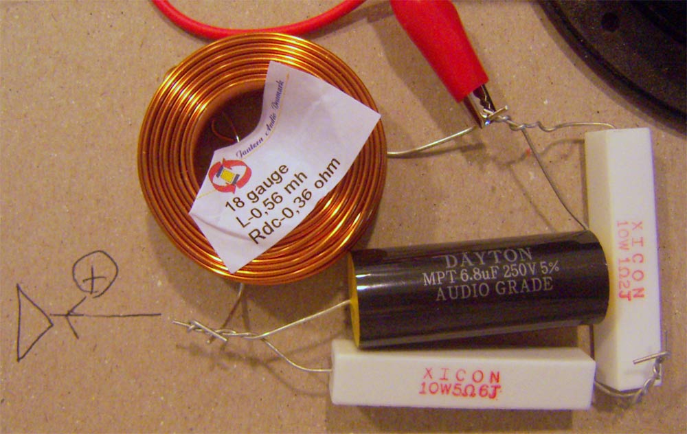

I think these TB's will do nicely, the notch of the 871 might work, specs and imp curve look pretty much alike..
thanks for digging the thread up btw, so I can report on the Needle with the 9cm Vifa 9 BGS 119/8 : wonderfull combination. I tested it with the notch used for the PicoLino2. highs are exelent, comparable to the Omnes Audio BB3.01, lows are a lot better (the larger Xmax and Sd do pay off).

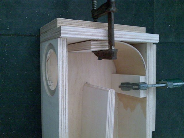

bilding a set off Needles,
maybee this adds something
Well, no. I did some experimenting with this and I found that putting 45 degree corner blocks in a 180 degree bend had absolutely no affect on the bass response of a folded TQWT. It does however increase the bandwidth of the port, i.e., more high frequency output. This is exactly what you do not want.
Your best bet is to leave any corner smoothing out and place some damping in the bend, like a sheet of high density fiberglass on the inside top of your cabinet.
Bob

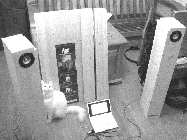

So here's my first DIY audio build.
I used the W3-871SC from partsexpress, a bunch of pine project board, and bought a table saw to make it all easy :)
Unfortunately, about 12 hours after project completion, my cat Leets slashed one of the drivers while climbing the needle. Another $25 to add to her tab of destruction.
So, whats a good way to cat-proof the exposed drivers, while keeping the awesome sound?
Mitch
Re: my cat ate my TB
Pine looks really good. Thanks for the pics.
Re. the cat — heh. She's as good as looking innocent as she is at surgically incising drivers. Catproofing? I'd guess there was loads of info in the general loudspeaker section as I'm sure cats/kids treat fullrange and multi-way systems the same way, generally. There are probably some standard sized grilles around. Then it depends on how you want to fasten them. Maybe for the needles, you could scrounge up some kind of frame+screen from a Logitech set? Dunno. Maybe we can use the fact that the screws that hold the driver in place could hold a screen in place too. Then, the frame is metal, maybe magnets are a possible solution. Then again, maybe not. Also, maybe some sort of grill from a computer fan can be used as a McGuyver'd screen.
