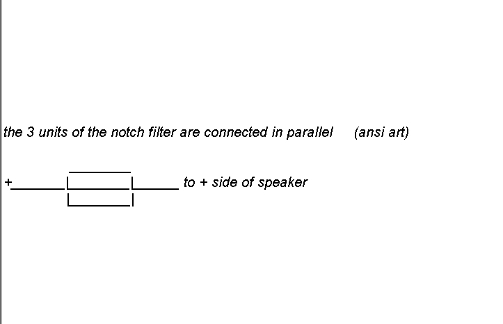

AdamThorne said:
Schematic: they are all in parallel, in line to the positive speaker terminal. Parallel means wire connects to all 3 components on one side, then all 3 components connect back together before going on to the driver.
Parts Express: that's where I got my filter components. I had to sum a 5.6 and a 1.2 ohm resistor (couldn't find 6.8 at the time). That is, solder the two together, end-to-end - the values will add.
- Adam
- Adam

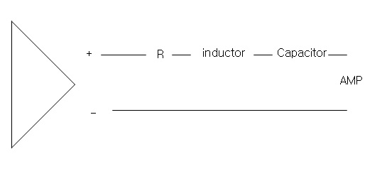

HELP with notch filter
I am in the process of building the needles, slow and steady look at the pic, have a problem, with installing the notch filter as recommended.
I can wire all the parts, Resistor, inductor, capacitor on the + side in series, sequentially? ( I will attach the picture on next message).
1. Does it matter which sequence?, R, inductor, cap, etc?
thanks,
gychang

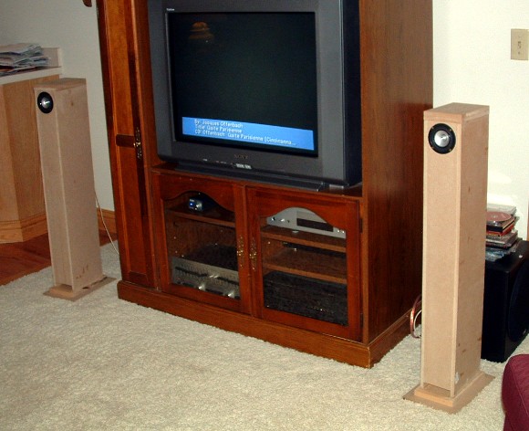

1st project...a success!
1st I would like to thank Cyberg for coming up with this design as it has rejuvenated my interest in audio which had become stale. Limited diy skills, and wanting a good match for my T-amps, both SI and Trend, the full range aspect of this seemed like a good start. I have to say this has got me hooked😀 ! For the 1st time in 28 years I have found some speakers that actually sound great in my familly room which is an audio challenge (L-room shape and lots of furniture in the wrong places).
The Needles replaced Martin Logan electrostats with a power guzzling amp; these were the last speakers of many tried in this room. The stats had poor waf😡 , and did not have enough room for correct placement. The Needles, conversely, have my wife a happy girl because of their size, and both of us happy because they really do sound wonderful.
Using the notch filter on these and no sub, a Jolida JD100 cdp, active pre-amp, the Trends T-amp as an amplifier, and cat-5 for wire. The pre I am using currently is an old analogue unit with eq controls built in (plans to upgrade as I learn more diy skills); I mostly use it flat however have been experimenting with judicious amounts of eq (depending on source and music).
Others who have visited and heard these speakers are equally amazed and think I am some kind of genius 🙄 ...well I let them think what they want😉 .
Just completed a pair of TABAQ's (slightly modded from original) with the Tangband W3 315D driver and plan on doing some comparisons when they drivers have some time on them. Early listening indicates another winner.
Needles in raw mdf, with plans to veneer, and pretty them up.
