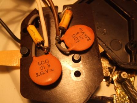

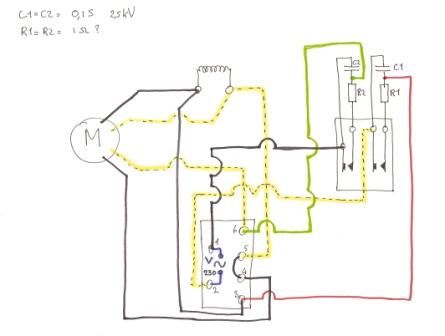

I have some resistors to try your suggestion. But the circuit is more complicated than I thought.
Underneath the lid of the switch I discovered 2 caps and two resistors. I measured the resistors and the are 1 Ω ???. The caps are to save the connectors I think, but why add the resistors? And only 1Ω.
The 2 coils in the motor are in series. And also are the resistors.
The light is not a bulb type but the same type as a red nightlight what you have got in the room for the children.
Where to put the resistor(s)? Can I place it instead of the bridge between connector 4 and 5?

It seems it can be connected for 120VAC or 250VAC.
(For 120VAC the coils are in parallel.)
In that case your "neon" will not turn off on a lowered 240VAC.
The 1R resistors one would assume suit the operating current.
Yes you can put the R between 4 and 5 as the coils are in series.
🙂/sreten.
