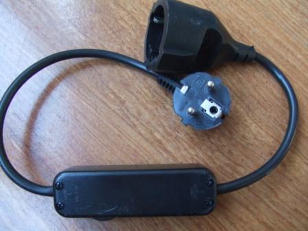

I took a simple small light dimmer, cheap version €12,- suitable for halogen as well. And placed it between the mains of the turntable. By turning the wheel from the dimmer at more than 15 degr. the motor stopped with some noise so maximum cutting of voltage is only about 10 degr. I measured the voltage is was 202 Volt. Then I used my stethoscope (ideal for detecting vibrations, even a toy version works!) and noticed indeed a reduction of about a third of the vibration noise. I tried it several times, about third was cut.

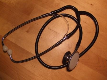

But now the strange thing; with my stethoscope I heard a reducing of about a third of the vibration noise but after listening records the rumble was reduced far more, at least 2/3 and almost not hearable any more. Strange.
I was very exited of this improvement and therefore like to share this with you. Probable the trick is well known but I could not find it so easy on this forum.

Thyristor / Triac (simple light dimmer) control of a synchronous motor
is not a good idea. (unless its an electric drill .... not synchronous)
A simple voltage dropping resistor is a far better idea. A variac
even better with its noise filtering but far, far, more expensive.
Perhaps the motor needs a service and possibly new mounting rubber.

Maybe not so good idea but…..it works just fine with my Garrard.
Sreten wrote:
Because of this great success I am searching for a variac. Don’t mind of spending a few €, I know it works.
Sreten wrote:
The motor is just fine. I checked the bearings and mounting rubber. I service this machine myself.
It is the voltage!

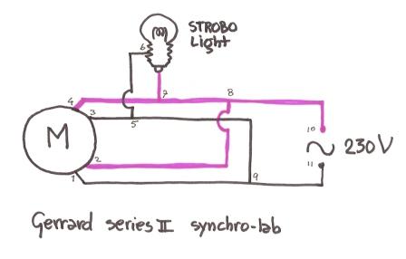

Indeed my Garrard has no capacitor or resistor.
IT WORKS!!! Both detectable with my stethoscope as well with a record. And I am not surprised when it works with more synchronous motors. Tune the voltage with a stethoscope, there is a certain minimum vibration when you change the voltage. In my case it was 202Volt. Lower and it start to vibrate again, until it stops with a lot of vibration.

Some synchronous motors are shaded pole, direct mains power, no capacitors or resistors.

http://www.alliedelec.com/Search/Pr...9700285&SEARCH=9700285&DESC=RWM06226801JA15E1
3W resistors should be plenty high enough.
If the strobe light is a bulb it does matter where you the resistor.
Just go for the most convenient point.
Which for testing might be the fuse position of the mains plug.
🙂/sreten.
🙂/sreten.
