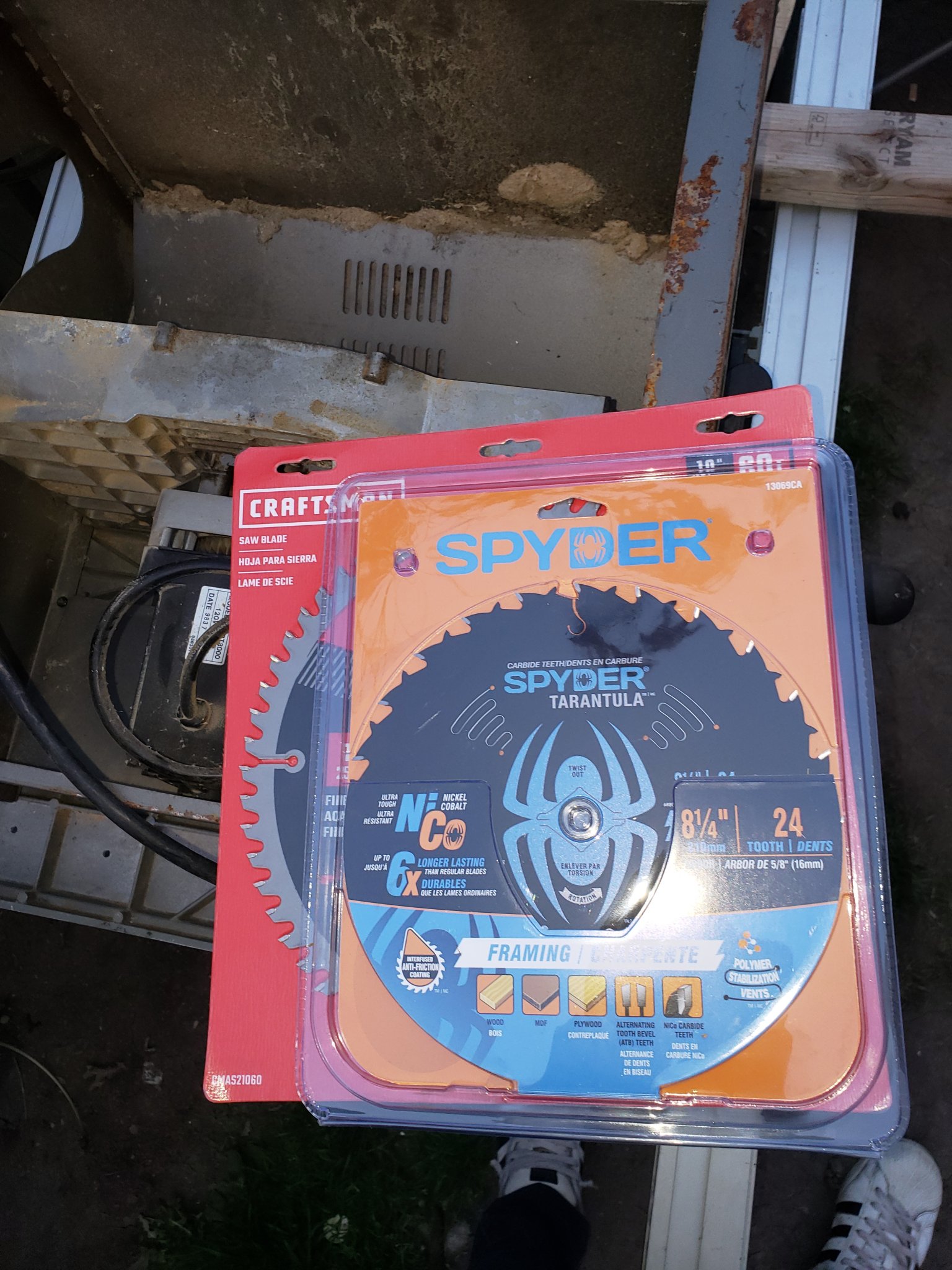

Regardless of the method used, whether table saw, circular saw or router, good blades and bits are an absolute must.
Most of my cabinet work is with either Russian Birch plywood, or solid hardwood for smaller projects, with either box-joint or dovetail corner construction. This plywood is particularly hard on all of my cutting tools due to the adhesive being very abrasive,and it kills lesser blades in short order.
On the table saw I use only FS Tool XL4000 series (mainly the SM6251) blades. They cost a lot, are Canadian made, and will outlive me. Their performance and durability is incredible.
On the Skilsaw I use the Freud LU79R007 blade. This is a great little blade for use on plywood & veneered plywoods with a circular saw. Not particularly inexpensive, but they are often on sale. If you have a good saw and a good guide, these can provide an outstanding finish that will rival any table saw.
My straight router bits are all carbide end mills, either 2-flute for plunging & fast cutting, or 4-flute for slower, fine-finish work.
For dovetail and form bits, Whiteside are my first choice.

I bought the best blades I had cash left for. That shouldn't make a mess of fine plywood veneer.

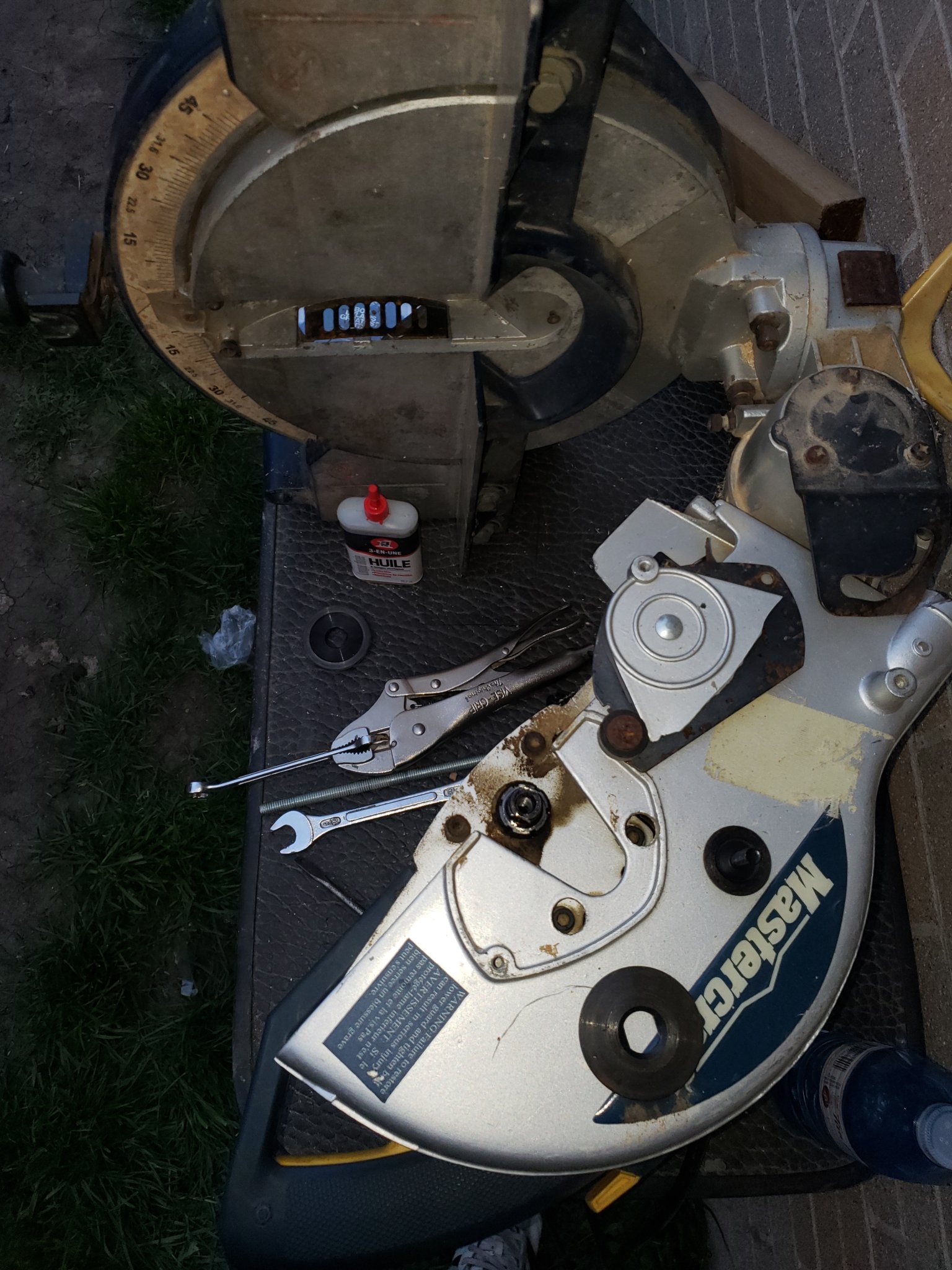

The radial is mostly rough for rough. That was in serious need of some lube too wow.

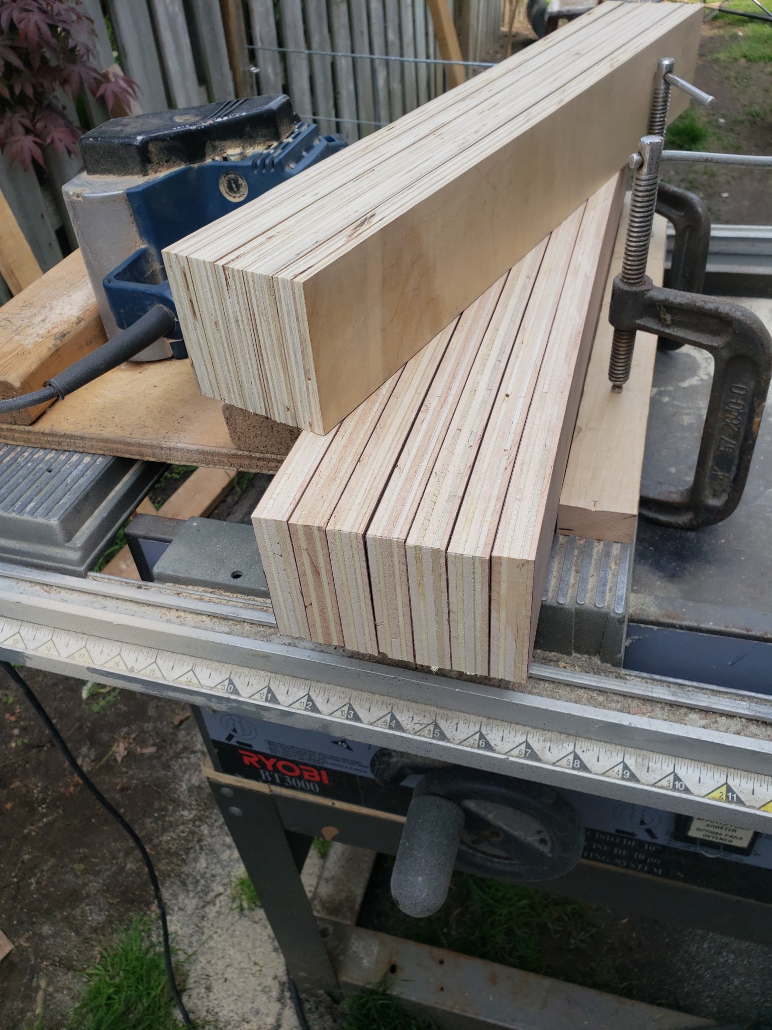

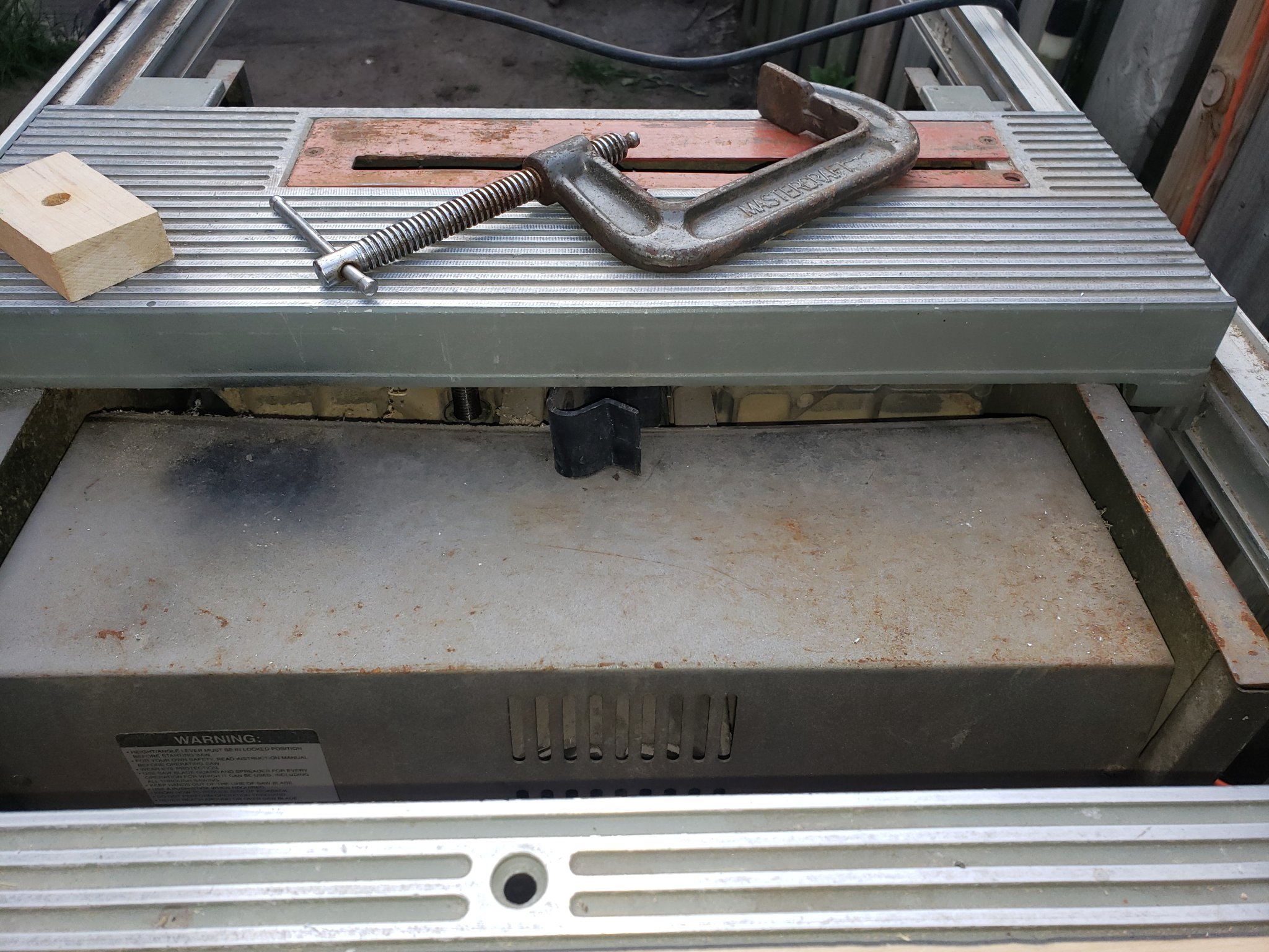

That looks like my table saw. Ryobi BT3000?Nerding full out. Now ital cut the full 4"x2' strips and save some router for later..once I section a tad bit, or a bit tad..anyhow. 👌

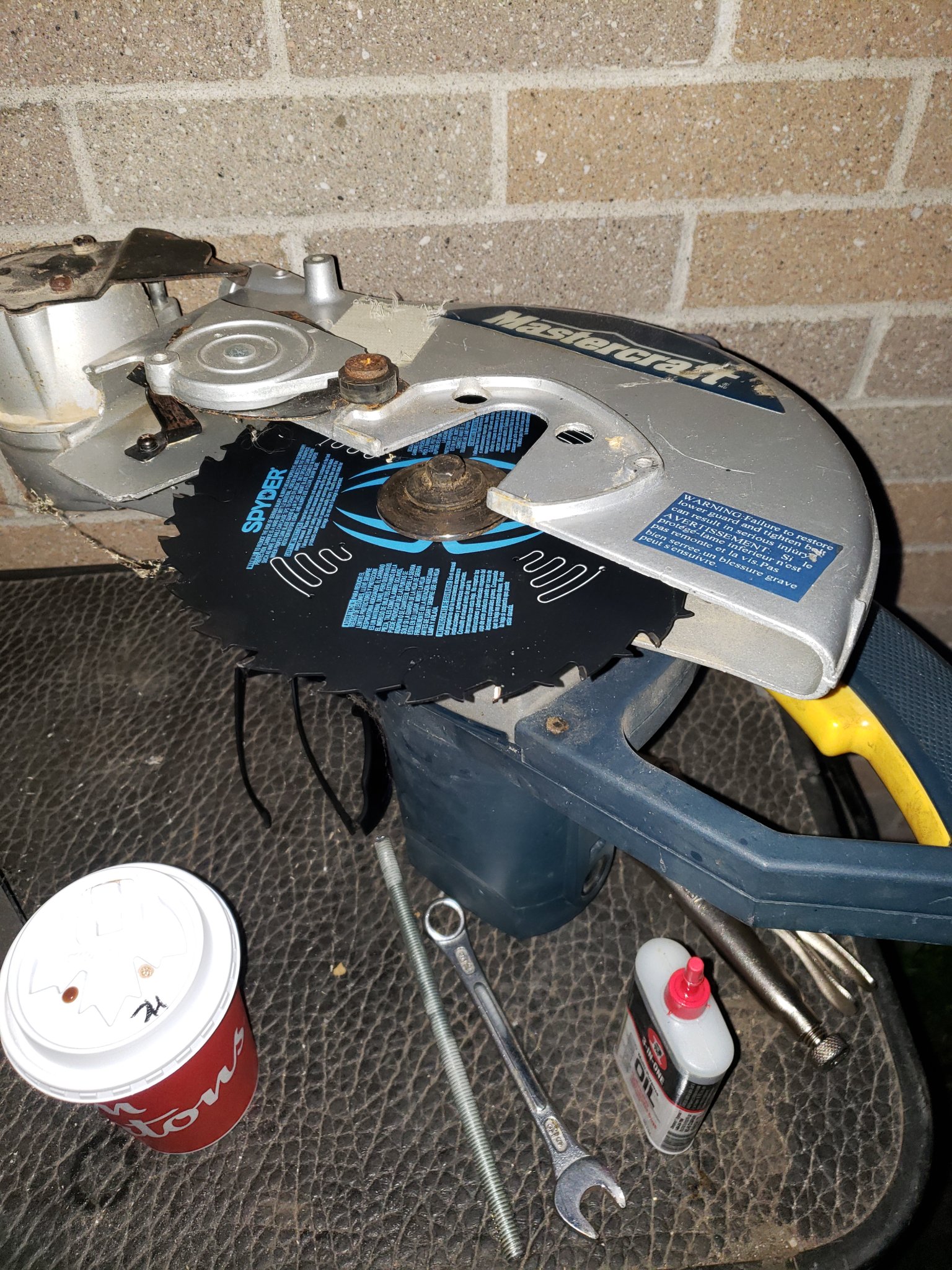

I got mine from a family member for free. It had a bad bearing on the armature. Cheap to fix but lots of work. Been through three blades since I fixed it.

Yes its a Royobi. It was vg shape when my dad owned it then it became a community saw of sorts and it was abused. When any kind of tools visit multiple users its demise is soon to follow.That looks like my table saw. Ryobi BT3000?
The sled and the fence became non functional. I prefer a more common sliding T square. I have multiple complaints about the sled design. On the same token was an ok saw with good accuracy at one time.
The bearings would scream a little bit on start up. After a few drops of 3in1 they are good to go.
If I had the missing parts I'd get the sled to work but the fence is a goner.
My quick contraption fence cut okay, hardly great. Its a win I still have all my fingers. I wouldn't recommend doing this. If its off as slight as 0.15" it will grab and kick back, or worse. It was off by less, the maple stock had a tiny dip in it so it did less than perfect cuts, but acceptable. I had to get my hands closer to the blade than I liked.

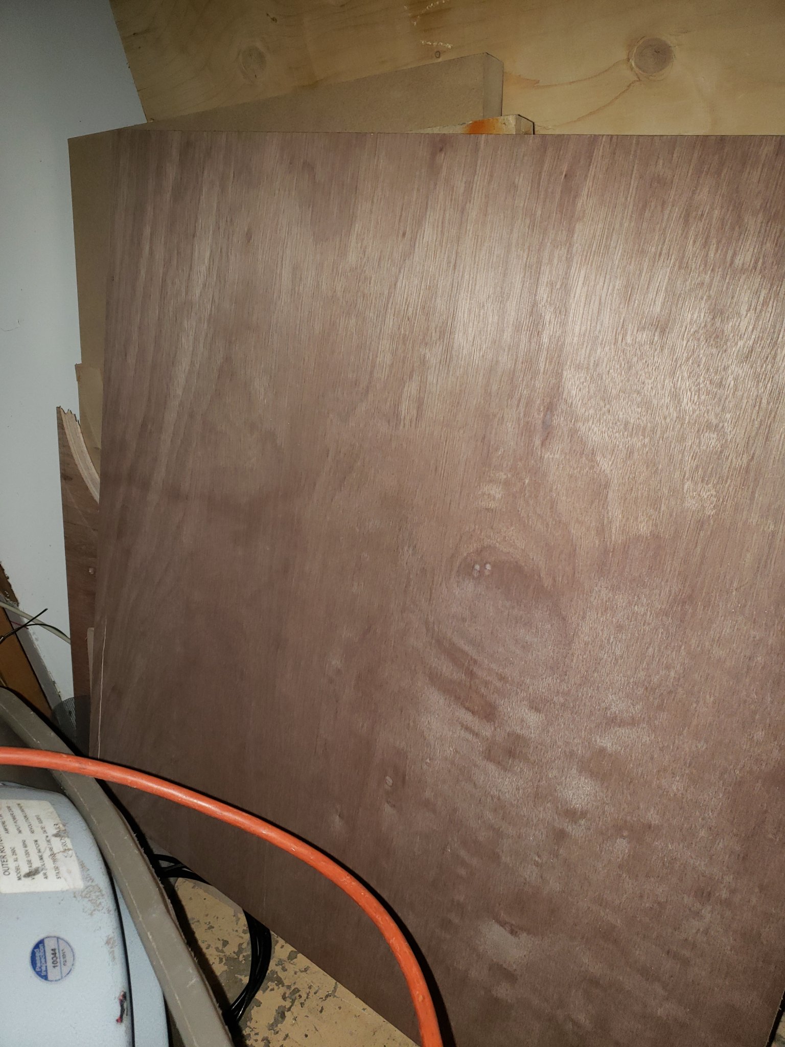

I lived up to my name as I tend to. I crosscut at least half of the nice veneer. There was so many things to pay attention to and I over looked that detail, cough. The darker one stains very nice, too bad though.

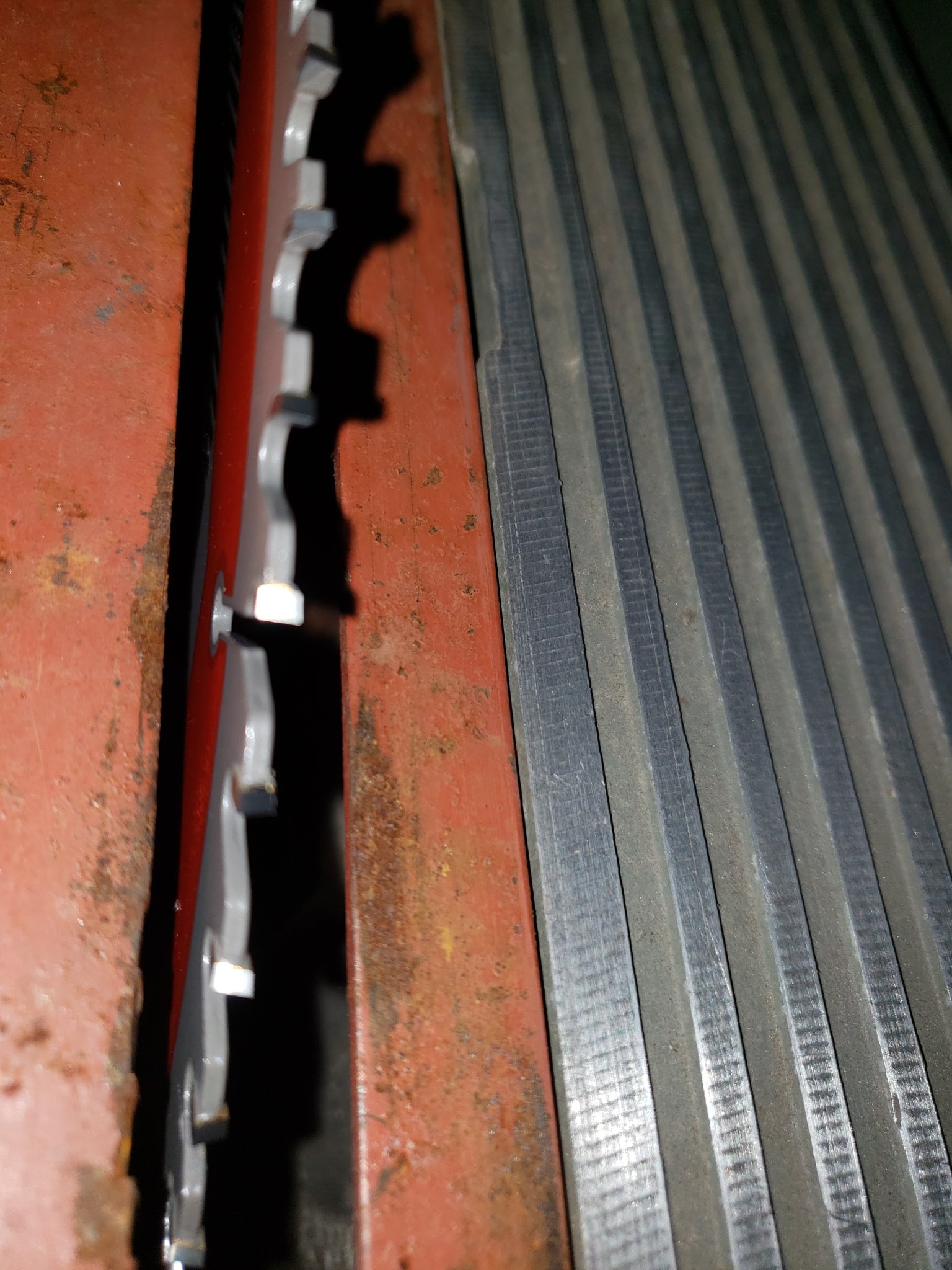

I got the table saw cutting dead straight with a 1' x1 scrap of aluminum for the fence. I do prefer the crisp clean edge the router makes, not to mention sliver free. But it would of taken all day to cut 12 4" x 2' boards.

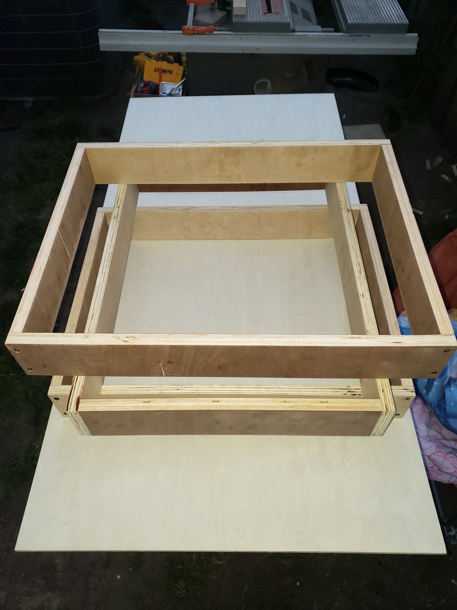

Enough wamming. The bulk of the work is done.
Ripped and framed. Instead of p!$$ing around ill textile complete.

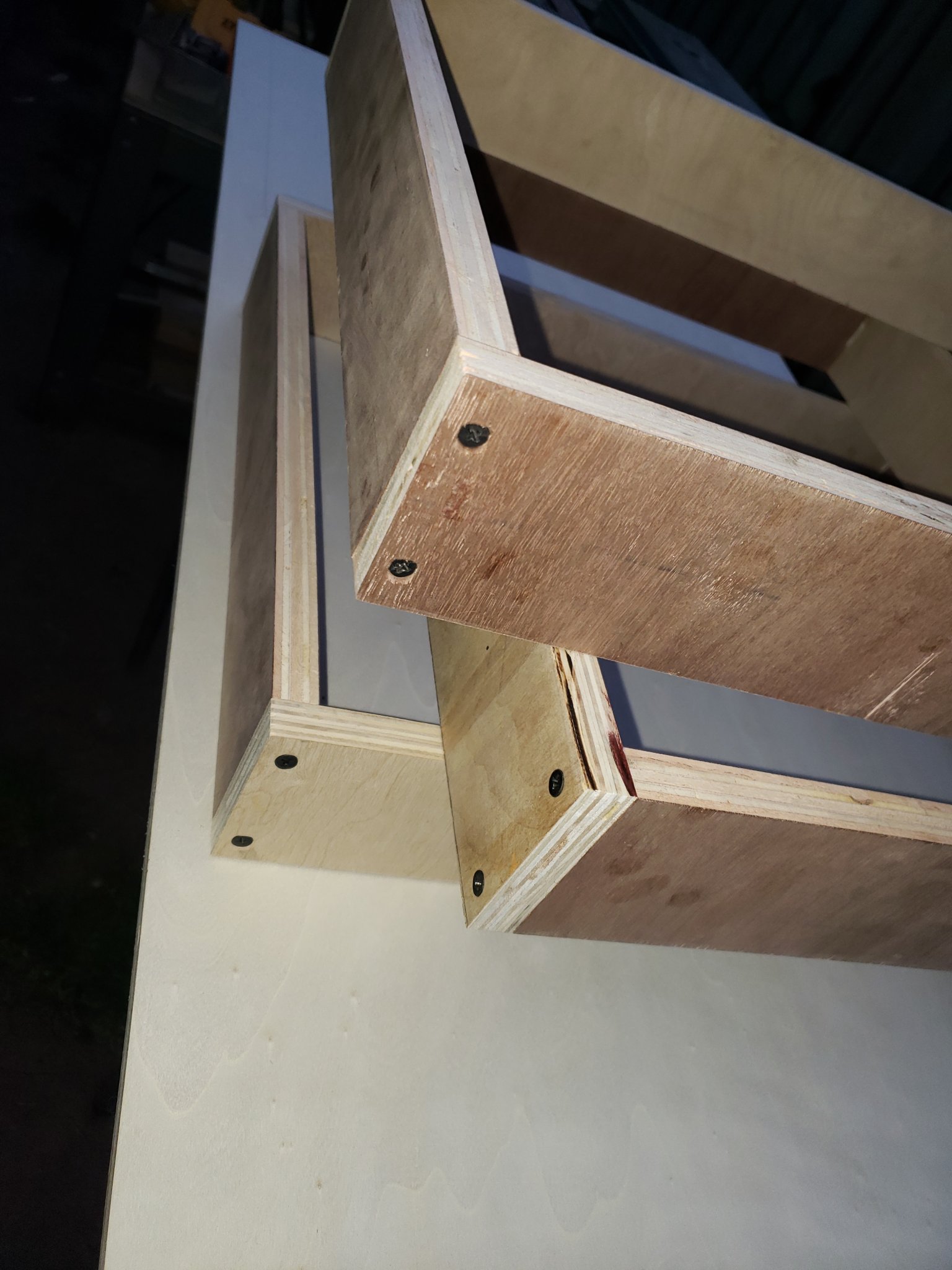

The butt joints are dead on for crisp edges high waf.
textile with exception of the 1/4" plywood back boards. Since they will be tight against wall board.
