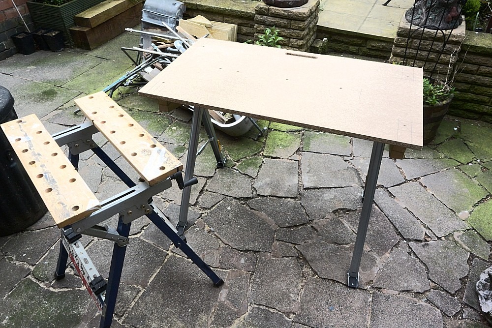

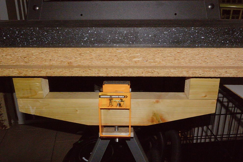

2 workmates of the same size can be useful at times. I went a bit further by adapting an idea trades people use. There are saw horses around that have parts that can clamp a length of 2"x4".They are pro stuff so very stable. They use 2 of them, add the lengths of 2x4 and fit an 8'x4' shoot of fibre board on top. One of these saw horse can also hold an 8x4 sheet on the side of the legs. I nocked up a smaller sheet version on a single saw horse.
It's pretty light weight and the saw horse legs fold in it's top section. I arranged for it to be the same height as the workmate. It's way way more stable than any hobby type arrangement I have looked at and easy to erect. The slot in the top 😉 - handle to carry it around.
Trades people do rough cut 8x4 sheet on one of these saw horses but the cut of piece closes on the saw blade at the end of the cut. Stips of timber such as laths can be used to prevent the part falling off. There will be videos around showing them used this way. I use roofing laths for this sort of thing as they are cheap and easily available in sorter lengths from DIY stores. 😉 The ones roofers use are rather long.

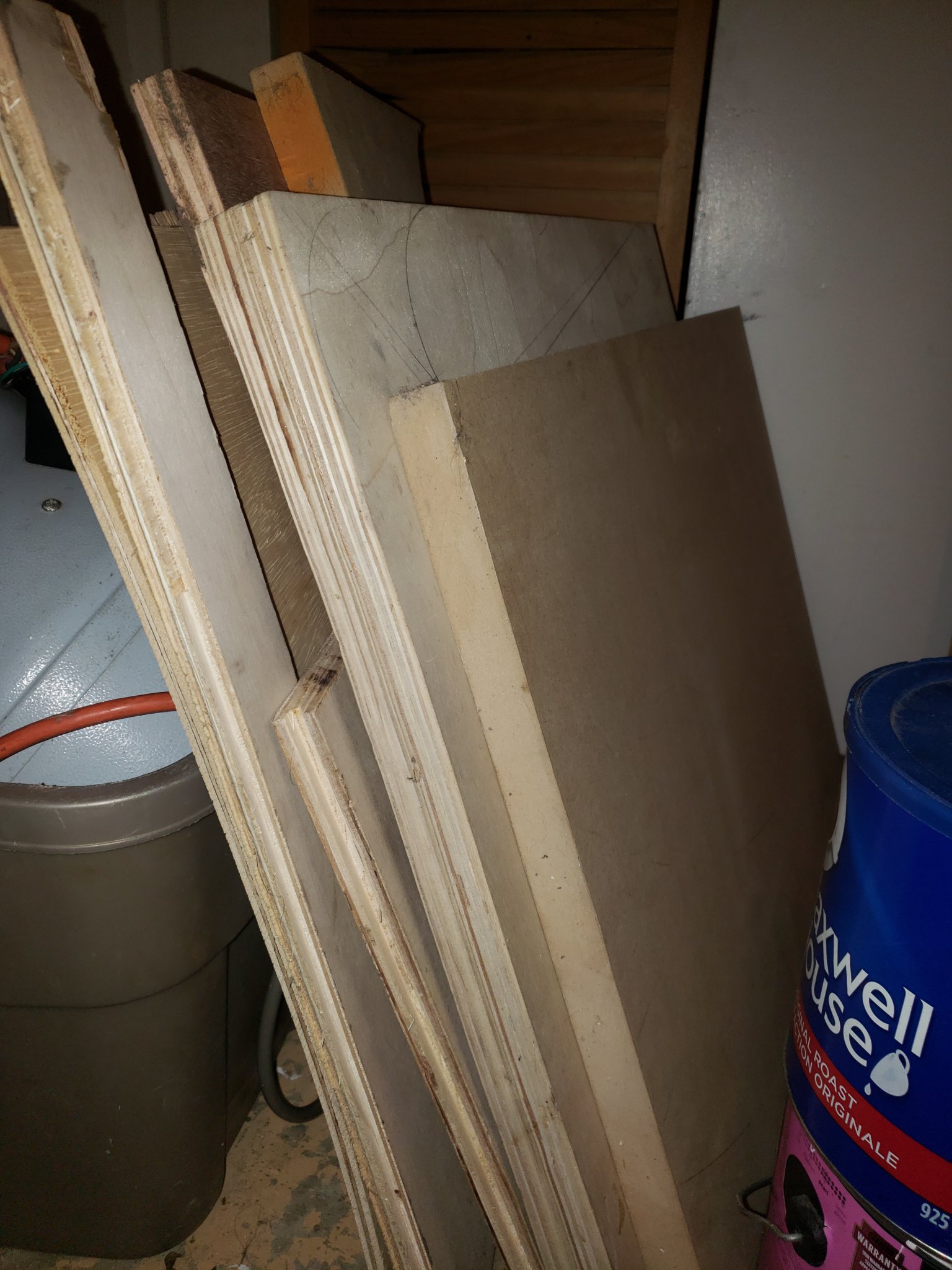

I have all my plywood boards picked out, two species of hardwood. I have two options for my baffle as well, some 1.50" maple I already had pre laminated for something else. Or 1" MDF. A decent kind, as far as that can be said.
Or the sometimes dreaded MDF 1". Easier to cut, dirtier to cut. Acoustical value vs. good plywood? I don't know.
I cut through the same material with my mini bosche router, I would rather not do it again. It over heated the bit, but more can go wrong then right if not carful. Power wise, it did well for being mini.

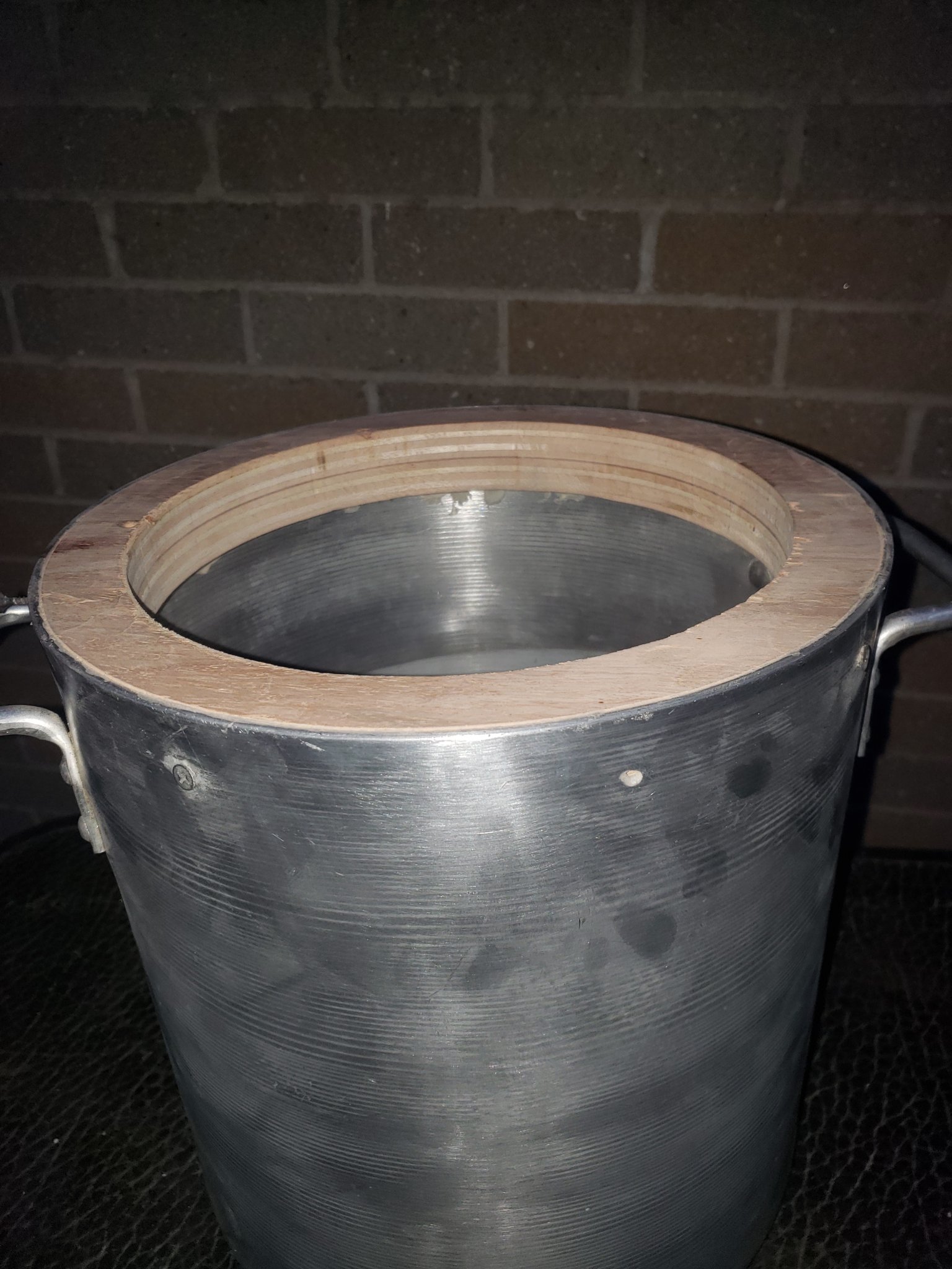

Imaged is the first go with the 1.50" material, cut in mini bites.

I remember through reads, a lot of people prefer MFD for its acoustic properties. How different can they actually be, without super bionic hearing to pick out differences. I used to grab mdf being how cheap it was, but don't recall any difference sq wise between the two. Baltic Birch is mentioned a lot. Its not easy finding the real deal 5x5' pieces here. Not to mention costs may of sky rocketed coming out of that region???
I plan to joint this new box the same, or straight 1x1.50" hardwood slabs. Very stong, much stronger then more typical holey mdf. Its over kill but less trouble.
I don't want to punish and shorten the routers life. So Ill try to come up with an accurate fence and use the 1.50" plywood 1st and better choice. Ill try to save that for thin stuff then get the bigger bro. at some point.

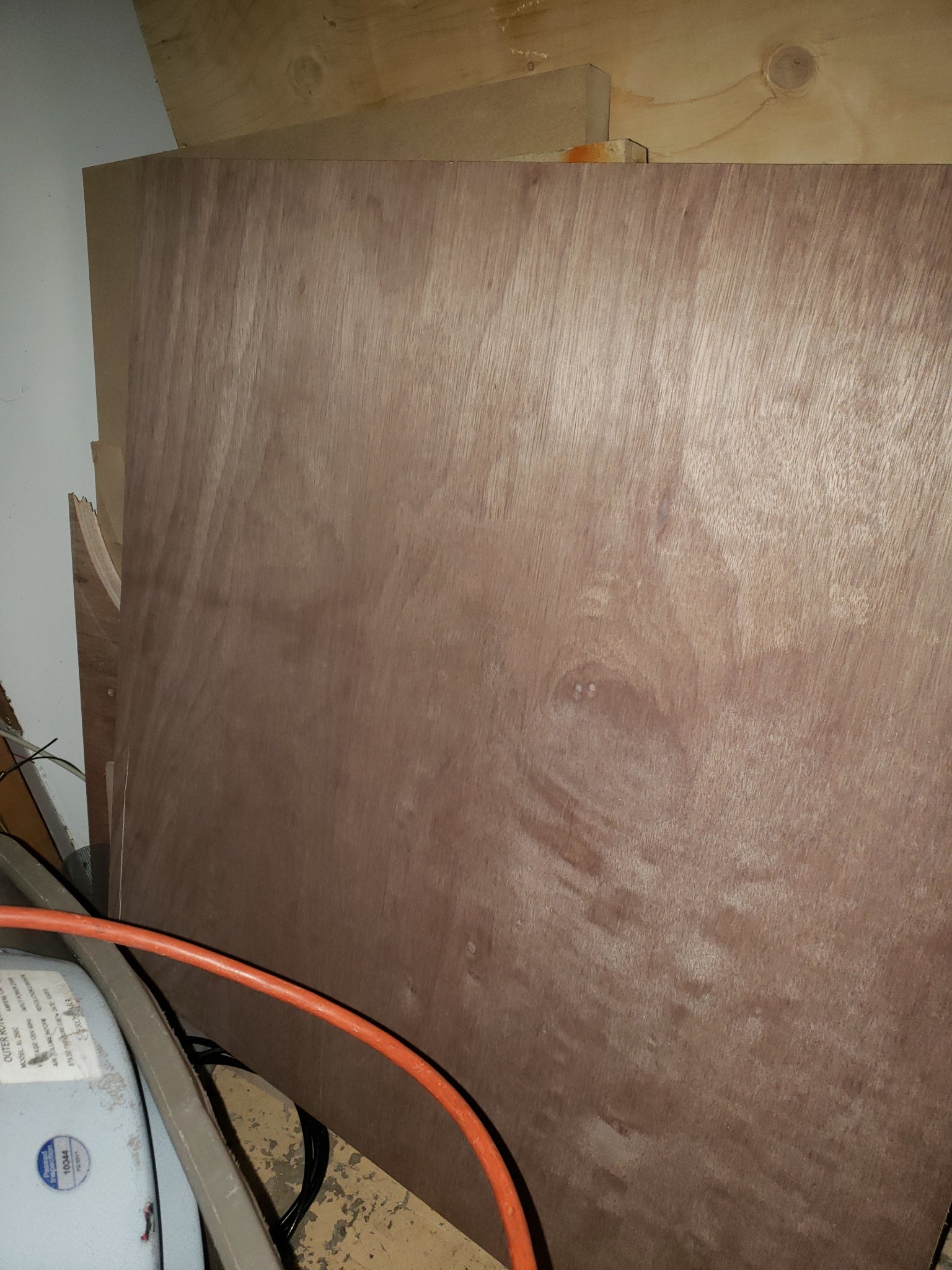

Do like the colour tones in that walnut one ^. Some Dutch oil is going to make that one pop, pop, so two pops. Those particular pieces are nice and consistent I didnt see a single void, I inspected cause yeah thats always a consideration, you don't want voids in speaker panels.
