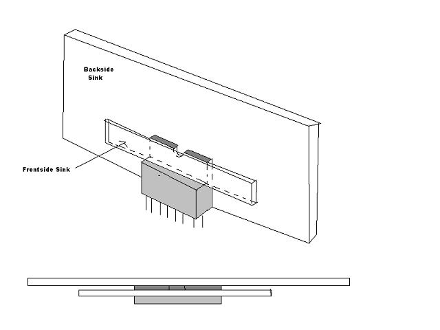

Is the thinner part of the LM3886TF chip, the part where the screw hole is located, empty and only used for mounting or are there any electronics in this part?
The reason being that I would like to cut a part of for mounting purposes. The chips will be mounted with a heat spreader bar and I will not use the screw hole. In stead I have just not enough space for the height of the chip and if I can saw the upper part, say upto the mid of the screw hole, off than I can fit the amps in the desired case.

I will use the chips with 18V tranny (25V DC) so they are not up to the max power potential. There will be an aluminium heat spreader bar or cooling element on the front of the chips to keep them as cool as possible under the circumstances. My guess is that most of the heat is generated in the area where the electronics are
There are no electronic components in the thin area. Given your proposed solution for mounting, I would say you have a high probability of a successful installation.
Two things to consider after you make the cut.
1. You will be exposing a metal tab underneath the plastic which is electrically connected to the chip. Make sure the exposed metal has enough clearance from your heatsink / enclosure to avoid a short.
2. After you cut, bevel the cut edge with some sandpaper or a file so that burrs from the cut plastic and metal do not prevent the part from sitting flat on the heatsink.

It is a TF chip, so no metal parts currently exposed. I will isolate the metal parts if they become exposed. If it is only the metal part I'm not worried, I was worried about electronics that might be exposed and/or damaged.
Calculated maximum power dissipation will be at 28 watt maximum with this relatively low voltage and the predicted loudspeaker impedance(4 ohm) and a maximum power rating of 50W output per chip.

I can't see any problem in cutting off part of the exposed metal. What you do want to be careful of is warping the part, as that will crack the die mounting. Look at the torque specs for mounting flat pack devices- they're quite low for a reason. I'd not try this with a hack saw, but use a jewelers saw with a medium blade. Far less stress on the part.

The chips will be in between aluminium, there will be a small heatsink on the front, a part of an 486 processor cooler.

It appears that the case itself is a heat sink and will provide most of the cooling. The black heat sinks you see in the photo will be used to hold the chips to the case, as a clamp across the face of the chips. If that is how he's doing planning on proceeding it may work fine.
Sherman, that's correct. The small heatsink strip is just to hold the chips properly and provide some additional cooling too. The aluminium case will perform as heatsink. The complete cover and bottem is perforated plate but the main cool element will is the side and front/rear of the case.
I've recently tested an amp with two LM3875's in an even smaller box whit no perforation at all. The amp was driven hard for several (4) hours at 70-80% of the maximum. The LM3875 are not driven to the max because the tranny is only 120Va but DC on the chips is +/-36V. The case was getting quite hot to the tough but my guess is that it was still below 60% celsisus. The whole casing functions as a heatsink.
