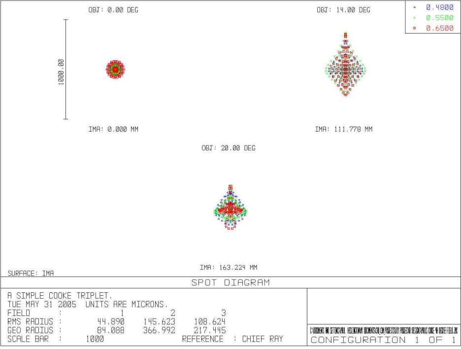

Here is the spot diagram for my lens but remember that it uses infinite conjugates on the long throw side so it will not actually perform this good in reality. I still have not figured out how to optimize a better or as good performance with the exact conjugates. The long side should be about 12 feet instead of infinite.

sorry it was a confusion there, i can as well draw spot diagrams but it is not what i am triyng to do.
what i would like to chek is error functions (how spot size changes with diferent shapes) are all desactivated on my estudent oslo edu version 6.3.0.
the solution would be to test every shapes manualy and check the spot sizes but it is a hard work.
i see what you mean by conjugate distances. I have to check this on my oslo, all my tests rays are coming from infinite as well.
Hezz did you changed anyparameter on the original lens before/after scaling? (my oslo triplet model is too much diferent...)

you are right, the conjugate setup does show diferent spot sizes to my non conjugate optimized triplet.
I have done some test on it and found some interesting points. The object has no spot size, it is infinitesimal (light coming from 0 radius point). But i can define any size object (lcd) and see how works it throw the lens.
Anyway, your custom triplet model at oslo does show very bad results (it could be something done wrong by me anyway). the spot sizes are huge on my tests.
Could you tell me what beams are entering your triplet to give you those spots you posted? ( angle and aperture of the beam)
