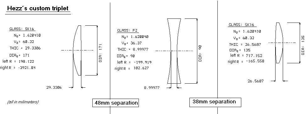

i have done a stimation based on the curves and the refection index;
1)304mm focal
2)-93mm focal
3)217mm focal
please you will have more accurate teorical values, could you tell me?
gguertin145 & Rox,
All of the technical information needed to build the lens is in the zipped word file in that thread. You will need to download that zipped word file. WIth that information you can calculate the exact FL of each lens. It has been too long since I did this lens and I think it has 40 degree total FOV corrected to a high degree.
THe FL of each lens is less important than how the curvature of each surface interacts with the next one to help correct abberation or make it worse.
I am interested in how good this lens will perform but I think that it needs to be further optimized for more exact conjugate distance of the average HT room. IT was done in Zemax and was adapted from an existing design. Oslo I tried but the user interface is terrible and for me I did not want to learn to use that software.
All glass types and curve geometries are defined in the document. As are the exact spacings of the lenses.
However there is one problem that I need to resolve. And as I recall this lens was optimized with infinate conjugates on the object side. I tried to optimize with a more accurate conjugate distance but have not yet been able. A lot of optimization variables have to be set correctly to get the design going in the right direction. With the lens designed for the finite conjugates of the HT room it may be that the FOV can be increased but I don't know.
Trying to calculate these things manually is too much work as to get an optimized system you will have to make millions of calculations of system variables. The computer can do this in a few minutes. It would take you a lifetime.

gguertin145,
Yes it is a word document and you may have to open it in word XP version. It will not open in wordpad or in word perfect even though they can supposedly do a doc. format. The document has too much special formatting information in it.
THe document contains lens profiles for each lens that are specifically designed for optical engineers to make the lens. The optical technicians will understand the documents as they are quite simple once you see how they work.
THey will have to custom grind the lenses unless they are willing to make molds for you. If the latter is the case then I suggest that we make sure this lens is exactly right before they do it. IF they make the molds the molds will be very valuable and can be used by the company to make inexpensive replicas so more lenses can be made. However, for a one off they are more likely to be ground.
As the lenses are large you better make sure thay they can make lenses of this size. THe largest is about 6 - 7 inches in diameter.
I would like to get Rox to help on this if he would like since he is very interested in designing the perfect lens. THe main issue is that we need to reoptimize the lens system for the near exact conjugates of the HT setup.
It is unlikely that off the shelf lenses will be available in the required sizes and any deviation from the prescription will severely effect the correction.

i have have been playing with oslo, but can´t find yet the spot size calculator.
Let me ask you, how many surfaces did you enter manually and how many were calculated by computer optimization procces?
also, could you tell me if the lens spacement was automatically defined by the computer or you started with this spaces as well as lens thicknesses?
Also would like to know the field angle definition, in the oslo program, there are two rays entering the triplet, one is parallel to the axiz and the other is with the desired angle (field angle) but i believe it is not the field angle definition. I would like to check those spote sizes for both cases (axial ray and angled ray), but have found some oslo free program limitations on working it out.

here you have all the information form the hezz's document (I can open it with my wordprocesor).
the powers of each lens are in function of the shapes, so knowing the curvatures, no need to ask for power. it is very important to use those materials (SK16 , F2) if is not posible, make sure to use the closest material (same index refraction and V- number or abbe number). Good luck
