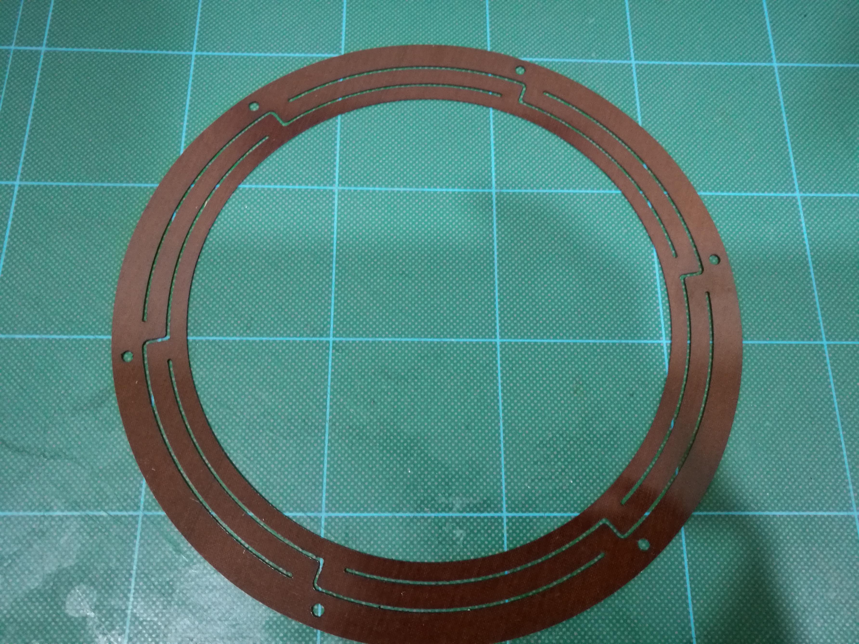

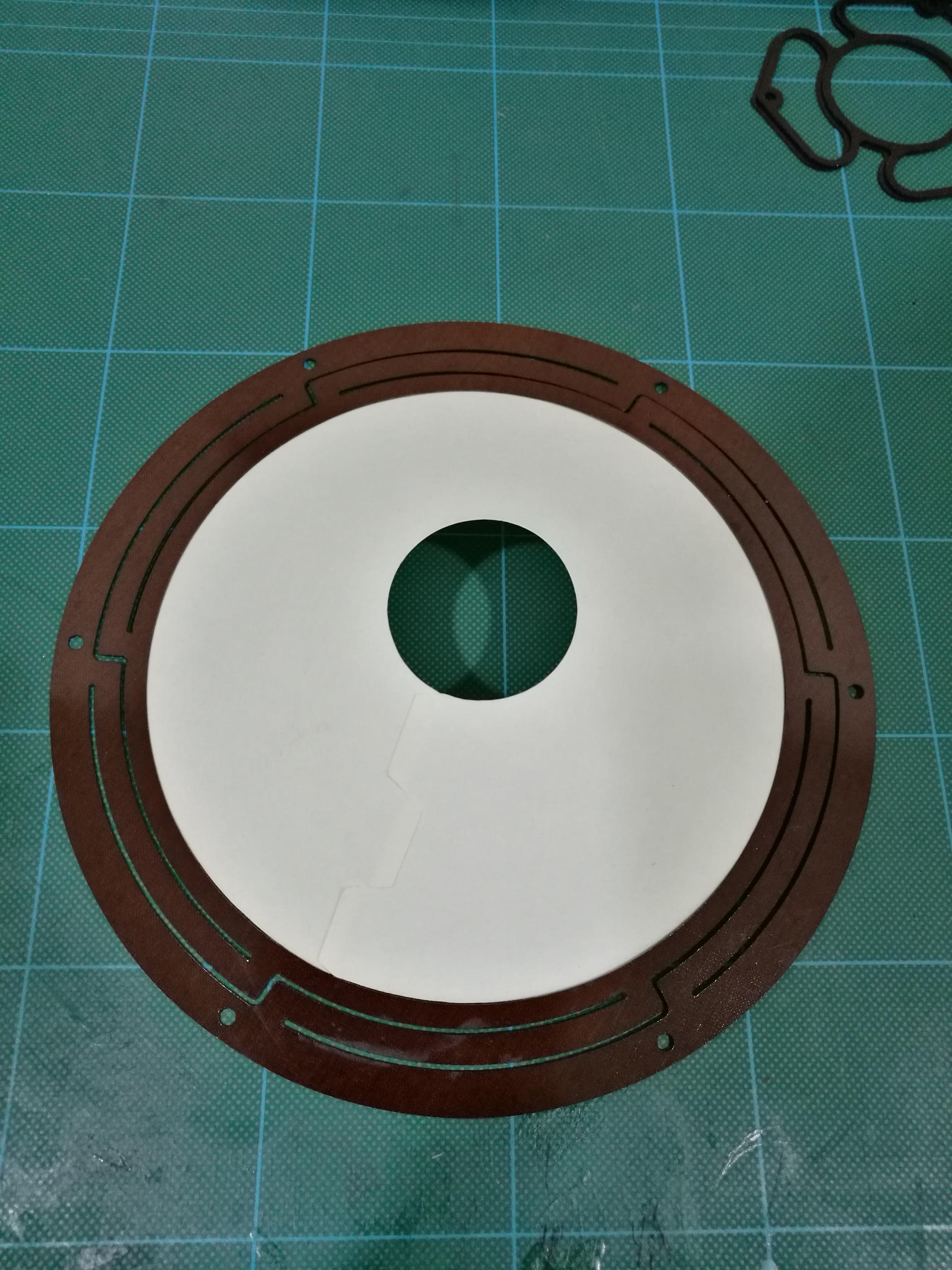

That phenolic surround is neat, but I can't see it being used for anything but OB, since there will be major leakage. Unless you planned some sort of thin film over that to seal it?
Yeah, I will think about that, or use felt material to cover over it.
But at the moment those gaps are 1mm wide, I will test them out first without sealing or covering them up.
