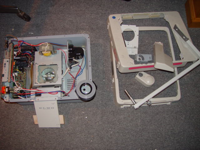

yesi think evd is the next best thing to the hqi setup i have to agree henrik_mork after seeing the elmo305sd in action
is anyone looking for elmo 305sd parts i have a working bulb socket and ballast and objective lens and mirror make me an offer
