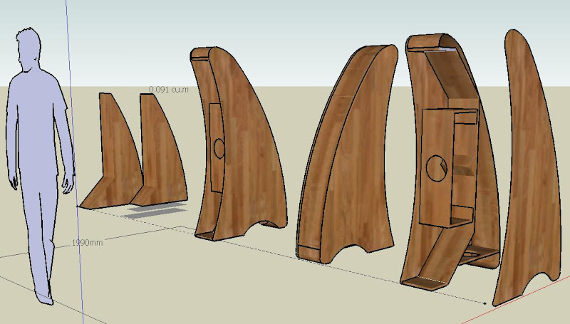

I did a volume of the space of the swoopy chang, and is 0.091 cubic meters, or 91 liters (or a bit less for lifting it off the floor, so plenty of space for a 200m driver , probably even down firing? I dunno, from what I've seen people hear from the guy change, they have reasonable bass anyway.
heres a slightly more curvey render, with downfiring woofer?...
looks great!
instead of the down-firing woofer, how about widening the entire assembly and bringing the sound from a rear-firing sw (mounted behind the original cabinet) toward the front. kinda like a horn within a horn! it'd be big and probably sound big too.
