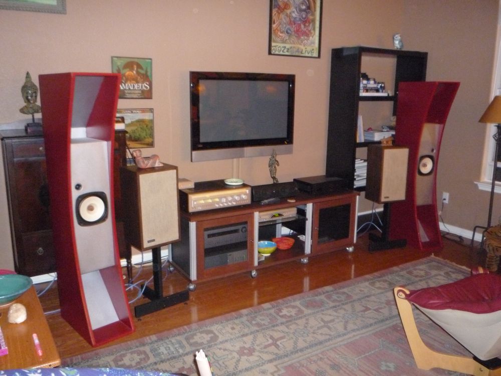

Well, I bought Bearhifi's Curvy Changs from the second owner in Fort Worth. They didn't sound great in the last owners garage, but they were side by side, and I like a challenge, so I bought them anyway.
Bear Hifi know's how to build a speaker. The fit and finish on these is superb. They have been well cared for too.
I got them home and hooked them up in my garage/shop at about 12 feet apart. Powered with Sansui G6700. Huge improvement spreading them out (duh).
Adding a bit of bass via the receivers EQ helped a lot. It took about an hour to get comfortable. I listened to some Rush Moving Pictures and that was a little overwhelming. The speakers have a forwardness to them in the mids. That forwardness combined with the dynamics of the speaker made it a less than optimal experience.
I put on some Paul Desmond. The mids still sounded funny but then I was surprised with a new sensation. At certain moments in the arrangement the orchestra suddenly sounded very alive and richly detailed. Wow. I was starting to get the magic. Then there was the sound stage, which was very lifelike.
This morning I hooked them to my newly refurbished Yamaha 1040. It was a much better match. Everything got more real sounding. Instead of EQ, I used the variable loudness on the Yamaha at a low to moderate setting. Sounding pretty good from an EQ point of view. Not perfect. I opened the garage doors and got to work on a pair of Mission 770's I am currently refurbishing. . Now I was about twenty feet in front of the speakers.
First on the player: Latin Jazz All-stars compilation sent by my father-in-law. The volume is up and and Cowabunga! There's a percussion section in my garage, and they are JAMMING! Very very impressive! Next up Fritz Reiner and the CSO playing Oterino Resphigi's Fountains of Rome. Equally impressive, but as I get closer and I notice more. These speakers have a way of recreating acoustic space that is unlike any I have heard. The air in the room is palpable. The softly struck gong in a quiet passage is revealing all it's harmonics. Just gorgeous!
Well. Despite an uneven midrange, these are very special speakers. They sounded best on non-heavy rock. Symphonic orchestras, Jazz combos and Jazz orchestras were brought to life.
An interesting impression. Years ago I did live sound for a living. I had a friend with a medium sized Turbosound rig. At one point, while listening to Joni Mitchell's Court and Spark, I felt like I had gone back in time. It was a similar sound. Of course, part of the Turbosound philosophy was a horn loaded eight or ten inch speaker that was crossed over to the tweet above the vocal range.
What to do now. These horns sound way good and certainly warrant more attention. The biggest problem is the midrange unevenness. I have done a little research and am looking at different drivers. I am also considering the Planet10 mod for the Fostex drivers. If I am correct, the Tang Band version of this driver is not suited to this cabinet. I am not a speaker builder so much of the information on this is beyond my ability to perceive at this time.
I would like to try some tube amps on these speakers, but as they are , they really need some sort of EQ. So I may look for a high quality pre with an on board EQ and use a Tube amp for power. I am currently considering Sansui and Yamaha pre's. They have pretty versatile EQ's and should sound pretty good. Or I could go with a high quality passive EQ like the old White, or a URIE.
Any suggestions on either of these approaches?

1st some questions.
1/ Post some pics?
2/ are these made with plywood?
3/ drivers are stock?
4/ internal wiring?
Typical tube amps have a high output impedance. This interacts with the impedance of the loudspeaker. As it happens with a typical FR, the impedance curve rises right where the frequency response could use a bit of a boost. With the high output impedance this is exactly what happens.
Try the tube amp.
dave
Thanks for your response Planet10.
This is the rig as set up in my den, with the Yamaha reciever. Best combo so far. On the right is a Cary SLA-30 I think. It is an El-84 amp with four per side pushing about 30 watts. Nice sweet sounding amp. I guess I will use the Yamaha as a pre for now since it has the EQ. If the amp without EQ is enough to improve the mids, then I try another pre or two.
Thanks for clarifying the impedance issue with regard to tube amps.
The horns are made with MDF according to Bearhifi, who posted on this thread a couple of years ago. These are the same speakers that he spoke about in the thread.
As far as I can tell, the drivers are stock, except for the addition of a phase plugs.
He describes the wiring as CCC. Not sure what CCC means though i suspect one of the C's stands for copper.
I will hook up the Cary, which is pictured in the image, just to the right of the center channel speaker.
