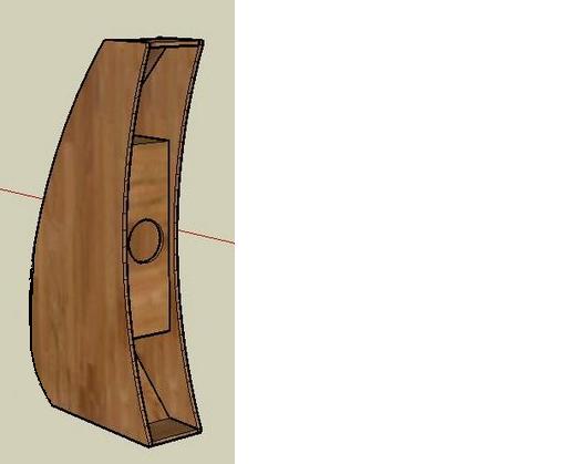

Hey, thanks for that rendering, it really helps to put ideas in perspective !
Excuse the blatant ripping off off your render, I've altered it a little with high tech mspaint 🙂... Hard to do freehand with a dirty mouse mat.
I think my build will be along these lines... A little lighter at the bottom and a bit more feminine I think, I'm sure if I show the Mrs she will be only too pleased to have something swoopier in the lounge.
Once I've finished my Chilis and the KimChi plans are out I'll put together an independent chamber and reflector module (the guts of the design)
Then I can play with cheap MDF sides clamped on to get the exact profile I want. I should be able to use that MDF as a router template for the final construction.

stevodude said:I like the curved back too! dammit...
I'm getting ready to fab this unit. Have you got a gut feel for the upper and bottom side dimensions? It appears that the footprint is 50 percent longer and the top-side is 40 percent shorter.
The one thing that is missing on this rendering, is something to break up the large flat area of the sides. There is a project, somewhere on one of Dave's sites, that has a couple of laminated horns, which are beautifully done, and have an artistic application on their sides.
I wish I could find it, but perhaps Dave can provide us with a link and picture. If you were to be creative you could come up with something that would add to the construction and looks of the project. 🙂

I did a volume of the space of the swoopy chang, and is 0.091 cubic meters, or 91 liters (or a bit less for lifting it off the floor, so plenty of space for a 200m driver , probably even down firing? I dunno, from what I've seen people hear from the guy change, they have reasonable bass anyway.
heres a slightly more curvey render, with downfiring woofer?...
I really dont see the need for a sub, but if you must.

I would not even think about putting a woofer in the same box unless it was a push-push pair for active vibration cancellation. Still 91 liters would probably do a pair of the 10s. A pair of CSS SD12s aperiodically loaded would do it to.
Reports suggest that these changs are hitting the mid 30s (ie just as low -- but with less impact-- than the pair of 12s above (a pr of 12s would be less stressed by a bit of EQ thou)
