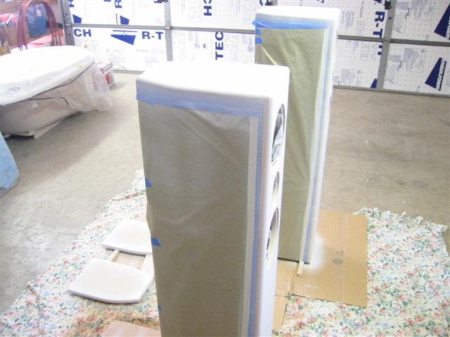

As it turned out the Fuhr primer was great! On the face of the MDF only 2 coats were required for stablization, however 4 coats were required for the routered / cut edges. No problem this stuff dries fast. Less than 10 minuites between coats. It does require sanding due to the build thickness / roughness after drying.
Highly recommended as a sealer / primer.

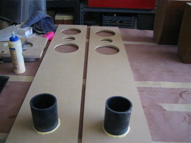

These next 2 photos are kinda out of build order. Sorry, but still important in construction details.

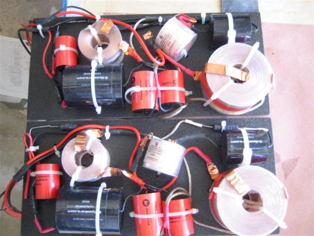

Port tube cut to length, routered into backside of baffle and glued into place. Not shown is speaker grill cloth stretched and taped over the opening to prevent toy and food storage by children. 😉
It also prevents viewing of the crossover components.

Gluing and clamping of baffles after routing proper depth to flush mount drivers. The baffle in the foreground has already been clamped and glued for 6 hours and the weight is in place for added measures until 24 hour dry time has been reached.

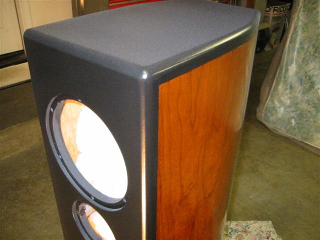

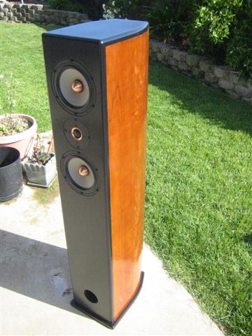

After painting and before clear coating the sides / baffle with Oxford Ultma Waterbase Laquer in clear gloss.
Ultma Laquer black gloss on baffle / top.
6 coats black
5 coats clear over stained cherry veneer with dewaxed shellac base. Every thing is waterbase execpt the stain. All were sprayed with a deicated HVLP cup gun and 1.2 needle cap set. HVLP turbine was used and not a compressor / conversion spray gun.

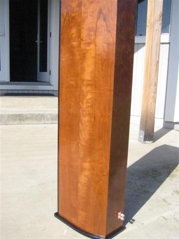

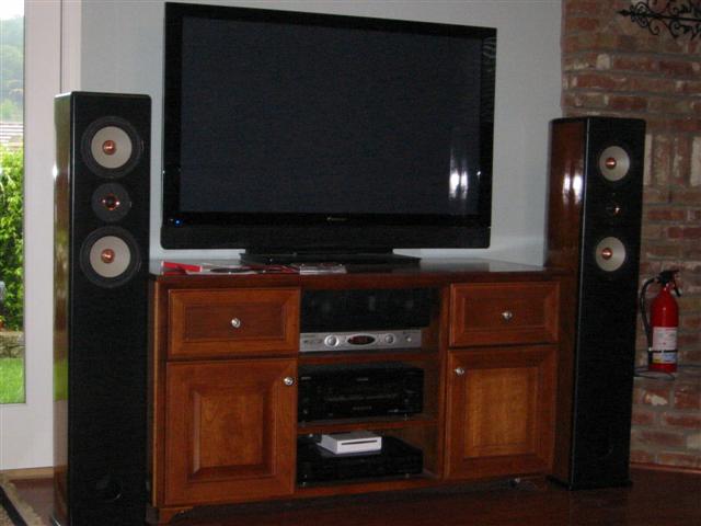

A photo of the drivers installed and speakers living next to the custom HT cabinet I built. Just so you know for size comparison that is a 50" plasma Monitor. These are not small speakers!
They frame the Monitor perfectly with the black baffles and do not glare at all when viewing movies.
As to the sound:
The first disc we listened to was Metalica S&M with the San Francisco Philharmonic Orchestra. WOW! I was able to discern individual violins, French horns differ from other horns (all playing at the same time) each drum strike was unique and discernible, the guitars that were changed mid performance sounded different due to the changed configuration. Awesome...Very Happy. Even the wifee was impressed. We watched the entire DVD at a loud volume and never did it sound stressed or distorted. Later I tried full volume from the mid level Sony 100 watt player and noted the Sony distorted and not the speakers.
:whazzat: I knew that would happen. Upgrade advise anyone?
Next up was a Spanish acoustical guitar with maracas and bass acoustical guitar, I felt like I should tip them when they finished...It truly sounded like they were in the same room as us. 😀 I think I'll keep these speakers.....😉
I can't wait until I reach the 100+ hour break in mark.
Bass seems a little shy, but that could change when the drivers and x-overs are broken in. I turned up the Bass output from the receiver by +2 and they sound right on. A VERY slight addition of a sub-woofer fills out the sound image nicely when the Bass amp section is left at 0.

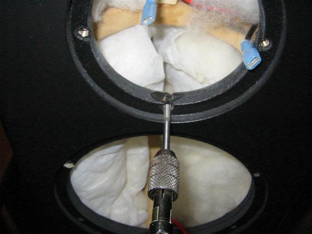

More work was needed on installing the drivers....:whazzat:
Even though I installed the drivers (test fit) in the cabinets prior to painting them, the screw / bolt holes did not line up perfectly afterwards. My fault. I drilled from the rear of the baffle instead of from the front side. I installed threadded mounts because after flush routing the baffle for the drivers I was left with about 1/2" of MDF for the driver screw threads. I did not want to take a chance and thought that was not enough material for a good thread bite. Some of the threadded inserts came out when I tried to install the allen bolts. 🙁 So the drivers had to come out completely and use different type inserts. I found a screw in type from OSH hardware that was a perfect use on MDF. I changed out about 1/4 of the inserts and then chased out the threads on the rest of the inserts. (should have cleaned the threads to start with) I was lazy! I paid the price for it too! :smash:
Now with all the bolt holes filled and drivers tightened in place the bass has increased and the snap from snare drums sounds like it should. 😉 I won't be trimming the ports. Thanks thou.
