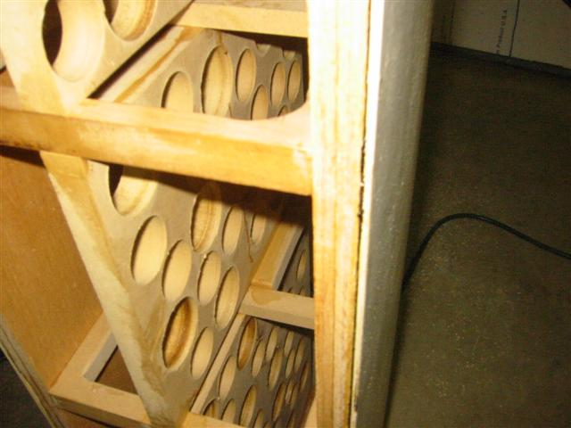

You can see the thin layer of Bitchathane just under the bendy ply skin.

Originally posted by Renron I must say that for only a 1/16th layer of Bitchathane the cabinets sound has changed to a thwump instead of a knock when struck with knuckles, I am impressed with the difference. Baffle width is now Exactly 9".
Despite that the BBC advocated using similar, if the frequency of the thwump is considerably lower than that of the knock the bitumenum may well have reduced the performance of the box instead of increasing it. What happens when you hit it on the inside?

It sounds like I am hitting solid wood, it is a different sound than when I hit the outside.
Did I get the answer right???
I could not stand looking at it any longer and I took a dremel with a cutoff wheel to all the shiner nails poking through the inside wall. Looks much better now.
The back was ripped as a trapezoid at 24* then run through a joiner after scribing the edges to meet the plywood. I will test my veneer skills on the back of the cabinets first. Not today though.

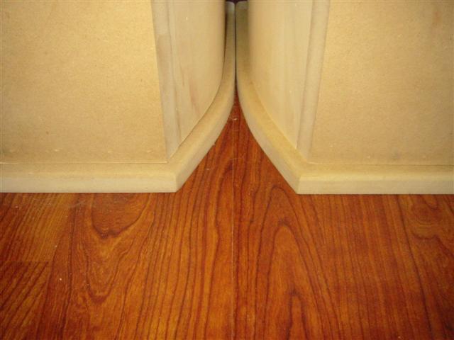

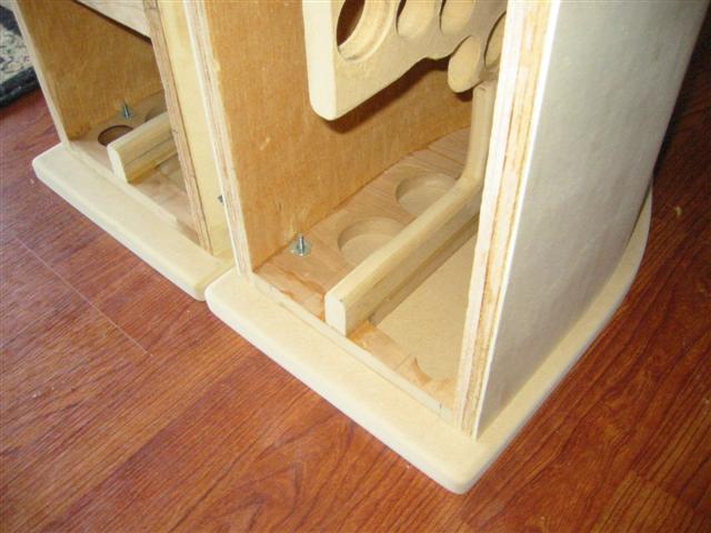

The bases were designed and cut freehand with a jig saw then touched up with a belt sander. Finally routed with a 3/8 roundover. They are attached with T nuts so I can access the Xovers later.
Ron

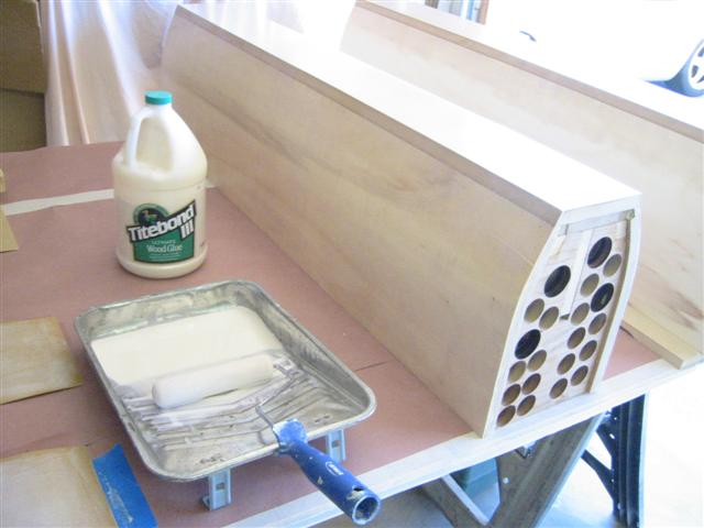

Prepping for veneer lay up. Iron on method.
I spoke with a rep. from Titebond and asked about veneering with Type 3 instead of type 2. He said there would be no problem with the glue in that application style, (heat activated)
Ron

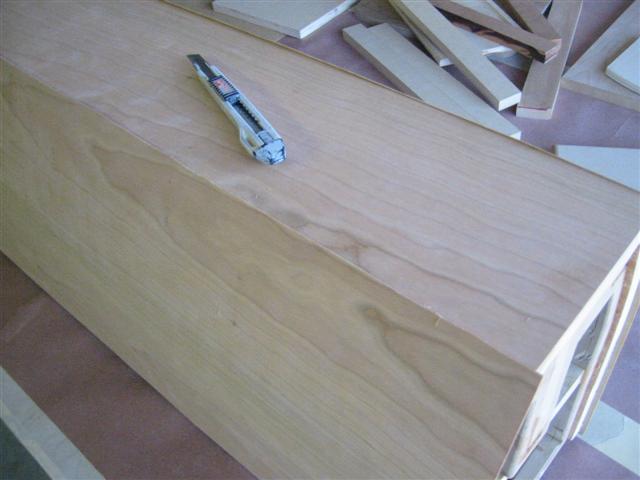

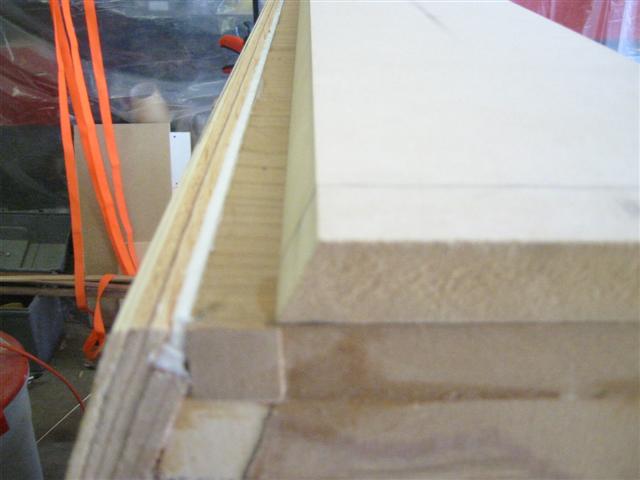

Sneaking up on trimming the veneer after application. Follow the grain direction and it all goes well. Unfortunatly cherry grain runs both directions........Uh. OK then, go both directions SLOWLY.
All worked perfectly.

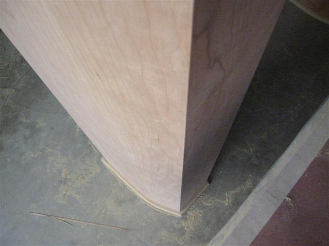

This is what I was looking for underneath those pesky overhanging veneer edges. Hooray!
This seam is so smooth I truly cannot see where one ends and the other begins. Very happy with how it turned out.
Ron

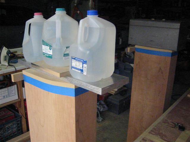

Gluing on the tops, any added weight helps. :) they will be trimmed with a flush bit on the router later. I wanted to protect the top edge of the veneer, it may be a while before I get around to staining and finishing the cherry veneer. I order Target waterborne ultma finish over 2 weeks ago from Homestead Finishing and still a no show. I'll call and find out whats up in the morning. It will probably show up via UPS or FedEx tomorrow.......go figure.
Ron
