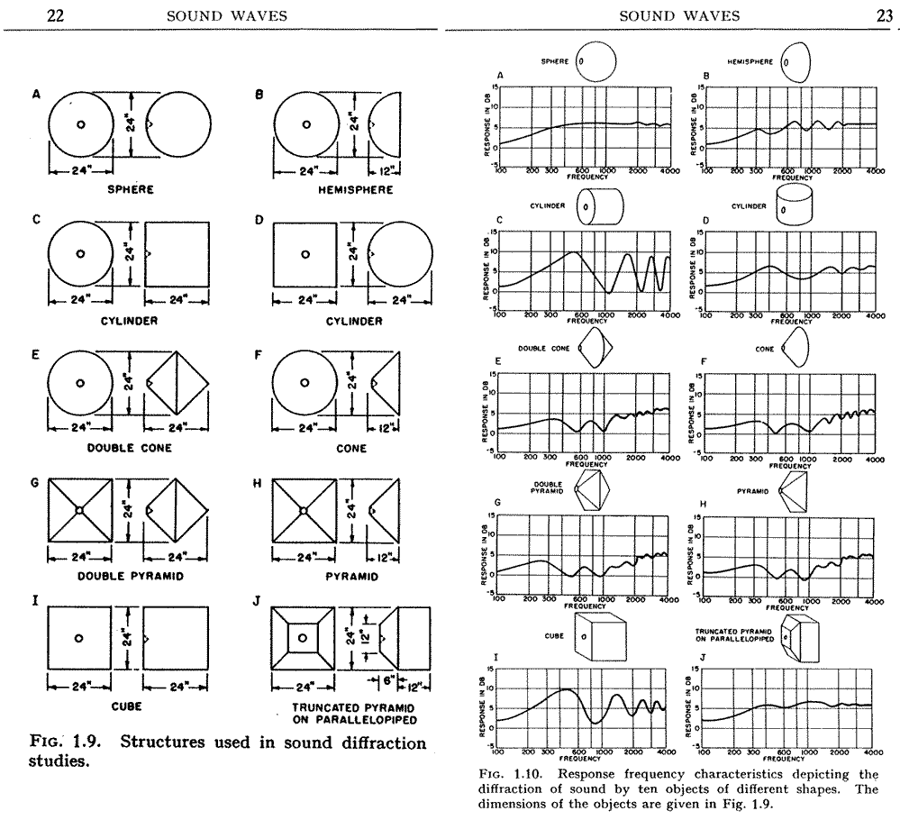

planet10 said:For the outside of a loudspeaker (actually the shape used in the B&W Nautilus 801 is better). For the inside of a loudspeaker it is worst.
dave
Agreed re internals, sphere is the worst shape. Olsen found that the sphere and the (like Dave's Fonkens, but with another big bevel on the top edge) were the best baffle shapes. Article is here. Mods - if you don't like the picture posted (from the above article), please remove it.
But this is about the rear shapes, and yes, it does improve standing wave performance, but it also allows for a larger speaker to sit in the same position (ie. good SAF).

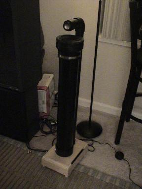

Linkwitz Pluto
SL measured a 40dB return loss on the mid/bass enclosure after determining an appropriate stuffing quantity and density.

Pluto's baffle step starts around 2.5KHz. The 1.7" tweeter is getting directional at that point so it doesn't diffract too much at higher frequencies.
The ABS sewer pipe is also round, so pressure waves attempting to deform the enclosure are trying to stretch it instead of deflect it. There's an AES paper where the abstract says the round enclosure was as stiff as 4" concrete; I should renew my membership and read it for fun as a $5 download.
Absorbing 99% of the internal energy is close enough to zero for an engineer who is thinking about masking effects.
Any one with a soldering iron and screw driver could build a pair. Easy.
Driver cost is about $140/pair. The six (woofers are bridged) channels of amplification and active cross-overs are in line with what you'd spend on passive cross-overs and a used mid-fi stereo amplifier. Inexpensive.
It's really a wonderful piece of work. I like my Orions more than my Plutos, but doing so much with so little impresses me more as an engineer.

Curved or nonparallel walls do not really reduce the standing wave behavior, they just make it more difficult to predict. Nonparallel walls can greatly reduce flutter echo in listening rooms, but speaker enclosures generally are much smaller and actually have damping material in them, so flutter echoes are less of a concern. Enclosure shape is mostly an aesthetic decision.
As far as the pressure vessel theory goes - how much pressure do you think is actually involved in loudspeakers? - Let's see: atmospheric pressure is ~101000 Pascals, give or take. and 0dB is 2e-5 Pascals. That means 140dB inside an enclosure dB=20*log10(P/Pref) = 10^7*Pref = 200pascals. Holy crud, that is so much pressure, NOT!
Sonotube subs are an application for curved walls that make sense. In this case the diameter and length is much less than any frequency they reproduce, and internal pressure just turns into tension in the wall. If you have a speaker that is producing wavelengths less than any box dimension, making curved sides that mate with flat panels isn't doing much...

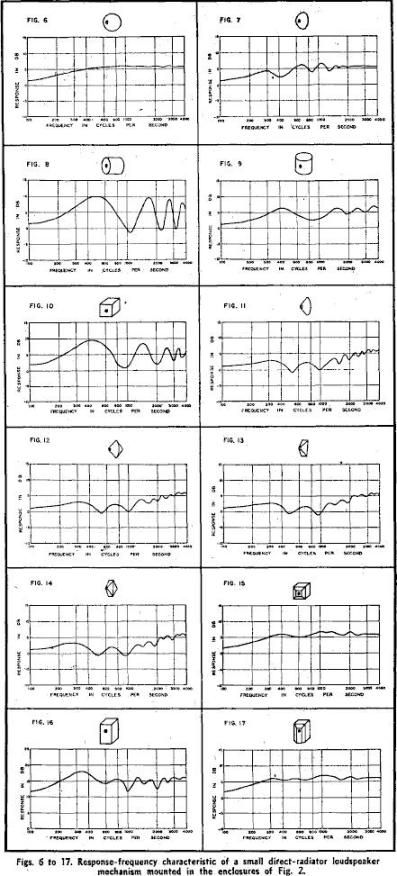

Everyone seems to point to Olson's graphs and say: "See? Curved enclosures are better." Well, Olson used what is essentially a point source always placed exactly in the geometric center of the baffle. Hopefully you are smart enough not to do that or you deserve the results you get.
HK26147 - that visualization is nothing more than the distance from the source to the edge placed on a line from receiver to the same edge point. While it may look neat, it is simple enough to visualize without a visualization. How much difference do you think curved edges will make? 😉 The BDS http://www.pvconsultants.com/audio/frdgroup.htm will show you the effect of cabinet and edge shape (and listening position) on frequency response.
