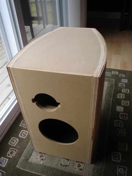

If the concern is enclosure resonance, has anyone considered attempting to get a very lossy, low resonance enclosure? ie get the resonance below the bottom octave.
Perhaps build an enclosure out of thick (like 1-2"), low durometer rubber like they use on gym floors, etc. Or build an enclosure out of an old car tire, they seem fairly dead as far as resonances go.
You need to consider the enclosure as though it's a bicycle pump.
At low frequencies all you are doing is compressing and expanding the air inside. So the enclosure tries to expand and contract like a balloon and, if the panels aren't rigid enough, it will introduce unwanted sound into the room.
However, when it gets to a wavelength where it can set up a standing wave in the enclosure, ~ 300 Hz for a 1m length, then you need to damp this resonance via stuffing and make sure the panels do not have a natural resonance around the same frequency.
robbo266317 said:You need to consider the enclosure as though it's a bicycle pump.

Some years ago I met one of the guys behind the B&W nautilus 801.
He shoved us wide band measurements of different enclosure shapes with and without stuffing. A sphere had the strongest resonance, a cube was allmost as bad, rectangular box had more resonances but lower in level. The differences between them was alot smaller when the boxes were stuffed.
He also showed measurements of the 801 enclosure, without stuffing it it had more resonances than the sphere, but much lower in level, it wasn`t as good as the stuffed rectangular box but not bad. With stuffing the resonances was lower in level than all the other boxes.
The magnet cover in the 801 is part of the design, to reduce reflected sound coming back out thru the membrane.
